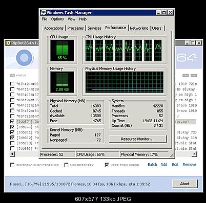

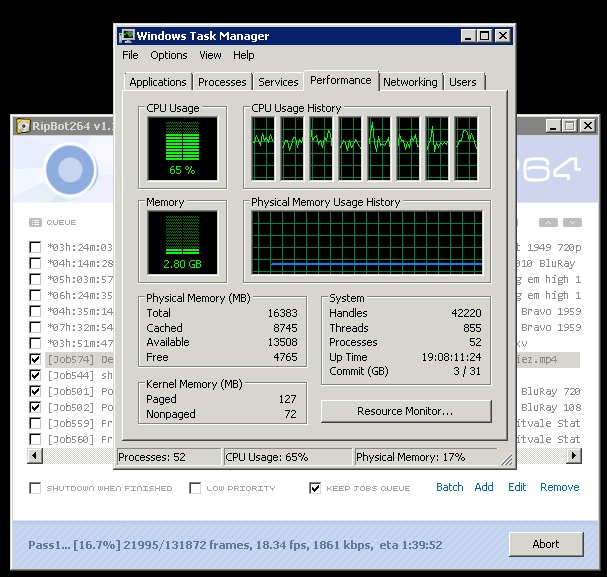

    and windows task manager during encoding is :

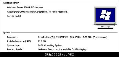

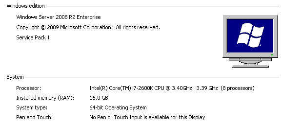

    and System Feature :
    Why Ripbot don't use whole power of CPU ? is there any way to solve this problem ?
    Encoding a 800 mb mkv takes 5 hours, is it normal ?

    In a 2 pass encode, pass one doesn't normally use the full CPU resources. But when you run pass two, it should be very close to 100% CPU, at least it is on my PC during an encode.
    My settings for a Blu-ray to MKV conversion is a two pass encode, size set to 7900MB, H.264 MKV with AC3 6 channel audio at 640 Kbps. Everything else at default.
    My last BD>MKV encode took about 3 hours and that's about average.

    Certain settings are likely bottlenecking your encode . For example b-adapt 2 isn't very well multithreaded and can be a bottleneck
    Hint : --preset veryslow means.... very slow , so if you want it faster, use a faster preset
