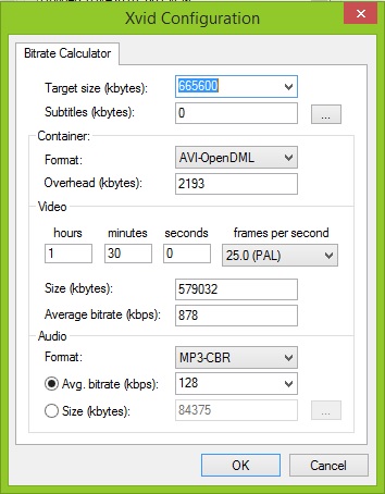

    I am trying to convert a video with VirtualDub and the Xvid codec. I would like the file size to be 700 MB so that it will fit in 1 CD. In the Xvid Configuration, in Bitrate Calculator, it has 4 suggested sizes, in kbytes: 665600, 716800, 1331200, 1433600. As I understand, they correspond to 650 MB, 700 MB, 1300 MB and 1400 MB. I choose the second one and fill in all the other details like video length and audio bitrate.
    Unfortunately, when the conversion if finished, I am getting a file that is 704 MB which is too big to fit in a single CD. How can I achieve a more precise file size? I know that it's possible because I have experimented a bit with FairUse Wizard and it very accurately produces a file of 700 MB or less, usually 699 MB.

    Sep 2012
    Australia
    -Void-
  22. Member
    Sep 2012
    Australia
    [Attachment 28339 - Click to enlarge]
    So, where's the confusion?

  24. Personally I think the problem's likely to be un-solvable. Xvid's bitrate control isn't that terrific and a MB or four over/undersized is probably not too out of the ordinary. I recall when using AutoGK regularly it was pretty good at outputting the requested file size/bitrate but now and then the output would be off by a MB or so. Every so often it'd be off by a bit more, but the only cause I can think of is Xvid. It's not like AutoGK would be getting the calculations correct 90% of the time but not for the other 10%.
    You didn't say whether you're using an Xvid profile (one with bitrate restrictions) but if you are it might pay to try again using the default Xvid settings. If the second time it hits the target size exactly but not the first, then it's no doubt Xvid's fault.
    Are you using the same version of Xvid FairUse Wizard does? Are you definitely encoding with Xvid when using FairUse Wizard? Have you converted the same video with both VirtualDub and FairUse Wizard to confirm you're getting slightly different file sizes even when specifying the same bitrate for the same video etc? I don't know how many videos you've converted with FairUse Wizard but maybe even though it's achieved the exact output size to date, it doesn't necessarily mean it always will.

    OK. Probably.
    Actually, I said "I have the latest version and I am using the default settings, which would be Xvid Home, I haven't changed any of the settings."
    No, I am using version 1.3.3, FairUse Wizard uses version 1.2.1.

  28. "AVI files and common problems"
    http://www.virtualdub.org/blog/pivot/entry.php?id=25
    By the way... what are OpenDML AVI files?
    Earlier, I said that chunks are tagged with a four-byte length. This limits the size of any chunk to ~4GB (4,294,967,295 bytes), and in fact, the practical limit is a lot lower due to compatibility concerns, around 1-2GB. The index also has the same limitation and this limits the size of standard AVI files to 2GB. A group called the OpenDML AVI M-JPEG File Format Subcommittee devised a semi-backwards-compatible way to extend this limit, by appending additional structure to a standard AVI file. The result is that legacy applications still can't read beyond 2GB, but the rest of the data is appended after the standard AVI and pointed to by a new type of two-level index. VirtualDub calls this the AVI2 format; by default it writes standard AVI files until it hits 2GB, at which point it switches to the new format.
    "AVI-OpenDML and AVI-Legacy?"
    http://forum.doom9.org/showthread.php?t=80157
    VDubMod can only write Hybrid files and Legacy AVI, but no pure Open-DML.
    "AVI-Mux GUI estimate overhead"
    http://www.alexander-noe.com/video/amg/en_estimate_overhead.html
    Some rules on overhead calculation:
    Let's first define one unit of overhead:
    standard AVI file: 24 bytes
    Open-DML without legacy index: 16 bytes
    Open-DML with legacy index: 32 bytes within the first RIFF list, then 16 bytes. The size of the first RIFF list was 1 GB till AVI-Mux GUI 1.16.2, and is adjustable beginning with version 1.16.3
    So...
    According to the first two references, VirtualDub "by default it writes standard AVI files until it hits 2GB, at which point it switches to the new format" and VirtualDubMod "can only write Hybrid files and Legacy AVI, but no pure Open-DML". And as you can see from the third reference "Open-DML with legacy index" takes 32 bytes while "Open-DML without legacy index" takes only 16 bytes, but Xvid does not have two options for Open-DML only "AVI-OpenDML".
  29. Member
    Sep 2012
    Australia
    Take a look at the Options|Preferences|AVI options in the VirtualDub Menu. I don't really know what it's saying, but I doubt Open-DML is causing a 4MB difference in a file size that small (or at all).
    We don't know what FairUse wizard is doing to get so close to 700mb, it's possible it sets the target bitrate low and then adds padding to get the correct size.
    Handbrake removed the Target File Size setting from it's GUI because they could never get the bloody thing to work accurately enough, so I know it's not an easy feat to achieve.
    However, I do know that MKVMerge is a much more efficient MKV Muxer than some others, even though it adds a rather large void to the beginning of the file for the convenience of Header editors. Unless you want to start looking at these files with Hex editors, I don't think you're going to find an answer to this one.
  30. I think the solution will be this:
    On Xvid codec calculator to choose "AVI-Legacy" and in VirtualDub to save the file with "Save old format AVI..." which will force it to use the 16 bytes container overhead and this should produce a more accurate bitrate / file size.
    That's what I'll try.
