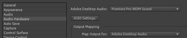

  4. may it be the cause?
    sony
    premiere

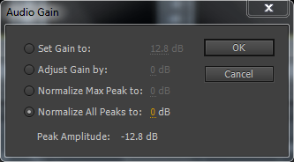

  7. i think it is not automatic normalizing.
    http://tv.adobe.com/watch/learn-premiere-pro-cc/normalizing-audio-and-making-samplelevel-edits/
    and VLC plays it loud too than premiere. loud like sony vegas. and i normalized all peaks to 0 and it seems worked. and i think sony actually does automatic normalizing.

  10. Isn't the normalising option checked in your pic? Which program is that?
    if a value of 0.0 represents the original clip’s volume level without adjustment why peak amplitude is -12.8 db?
    The "adjust gain by" value of 0.0 doesn't represent a volume level, it represents a change in volume. +5dB would result in a 5dB increase, -5dB would reduce the volume by 5dB.
    It might be confusing at first because of the way it's represented, but the maximum volume is 0dB. Anything below maximum has a negative value. So -12.8dB means the peak is currently 12.8dB below maximum. Forgetting normalising for the moment, if you set the "adjust gain by" value to +5dB it'd raise the volume by 5dB which would increase the peaks to -7.8dB so the volume would increase, but the peaks would still be 7.8dB below maximum.
    I assume from your pic the peaks are currently at -12.8dB and therefore enabling normalising would increase the volume by 12.8dB and the peaks would be at maximum (0dB).
    I don't understand the difference between the "normalise all peaks" and "normalise maximum peak" options. They must work differently, but I'm not sure how exactly....
