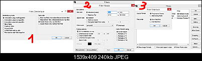

  13. Yadif before IResize???????????????? I thought this guy should learn something after a...... month or more?
  14. Originally Posted by Detmek View Post
    I'm not a "guy", I'm a Cat: please
    hoewver, why don't yadif before IResize?
  15. Originally Posted by poisondeathray View Post
    There was just a thread yesterday explaining you don't use yadif with iresize
    poison, for me what you say is sacred, but in this case seemed to me to notice from some tests I did that the quality of the result is a little better when I use the yadif before: if I'm not wrong something

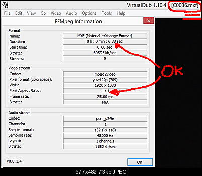

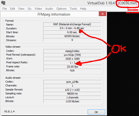

    but there is anhother problem at the "initial": when I open a .mxf file in avisynth - in some files - seems that fps is not the correct fps
    for example this:
    https://www.dropbox.com/s/gjfks4k4pr3y55k/C0036.mxf?dl=0
    In virtualdub I open directly the C0036.mxf (with the ffmpeg plugin for virtualdub) and it recognize all correctly

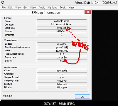

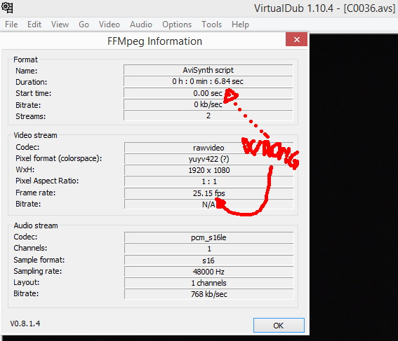

    But if I do:
    FFVideoSource("v:\C0036.mxf")
    in avisynth ----> virtualdub show:
    this is a big problem when treating files with "strange" framerate or in framerate conversions, and keeping audio etc..
    Because I'm a cat I'm not able to solve the problem, but your fps script (slightly modifyed by me) [in your megascript], seems to be useful to get correct FPS when treating source that have to be FPS-changed
    Resultant is: correct number of frames, correct FPS (outputted in %RealFPS%) also when the only FFVideoSource(input.mxf) pass to virtualdub the wrong fps
    so that the line AssumeFPS(last, %RealFPS%) correct the problem

    Seems to me that the "best" resize is the resize of virtualdub: so open this .avs and encode in virtualdub using filter
    1)deinterlace
    2)resize
    3)interlace
    result seems to me very good, but there some distortion, slightly attenuated, but not solved modifyng the SmoothFPS2.avsi this way:
