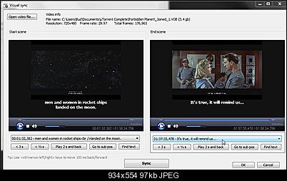

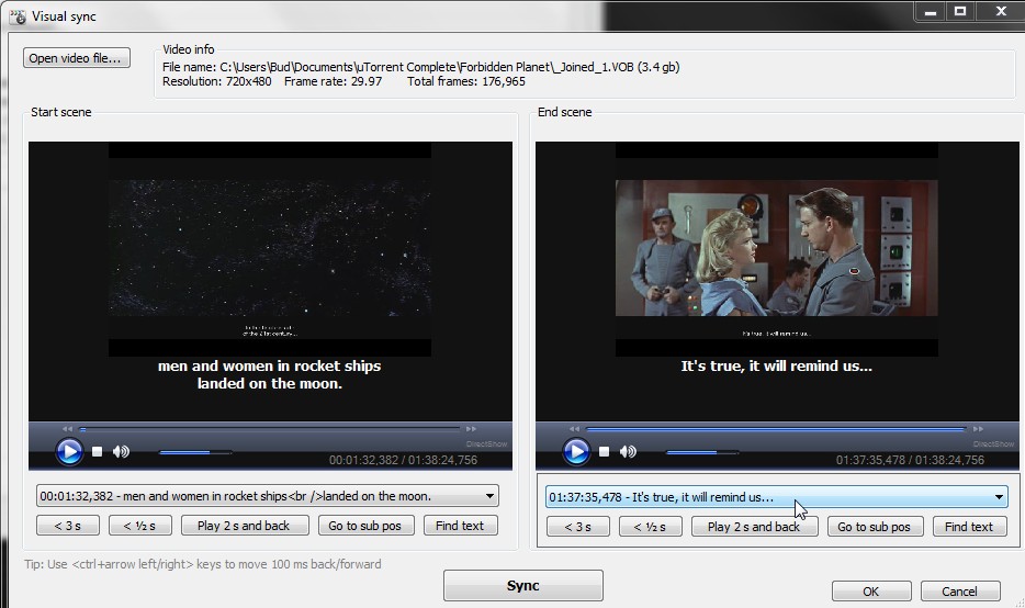

  4. Member Budman1's Avatar
    Jul 2012
    NORTHWEST ILLINOIS, USA
    videobruger nailed the best way if you have a correct copy but otherwise a good way to sync Subtitle Edit is Visual sync. Load your subtitles and video into subtitle edit then select Visual sync. You point to first line and point to last line and let it take care of the ones in between. Just an alternate method if you do not have a correct copy.
Name:	ScreenHunter_122 Nov. 04 00.45.jpg
