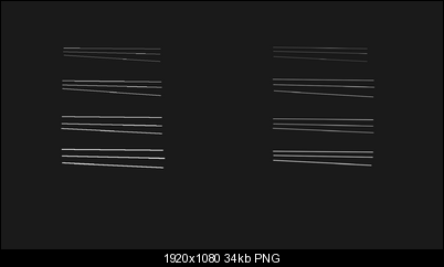

    source:

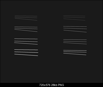

    IResize(720,576):

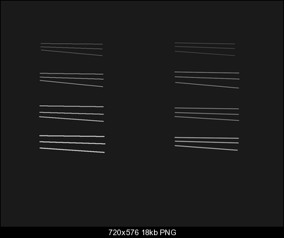

    Yadif(mode=1).BilinearResize(720,576).SeparateFiel ds().SelectEvery(4,0,3).Weave():
  7. That's pretty clear evidence on a static test pattern.
