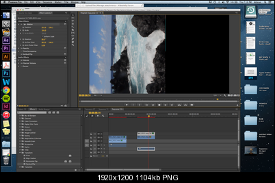

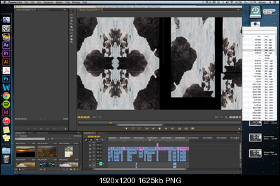

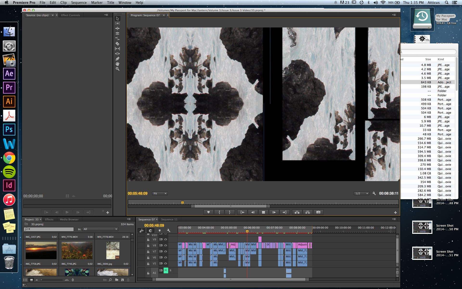

    Sorry, I should have included a screenshot here it is. Sometimes it's colored line like the blue you see, other times it's flashing white like static, it's also been both green and red.
    I have tried on clean progressive clips and nearly always get the same result. I don't always crop and the line appears regardless of cropping. It is almost always specific to vertical flipping and very less like for horizontal, I don't know why. I understand more information would be ideal, and I totally understand if it is quite literally the things that prevents me from being able to fix it, I know just enough to be dangerous.

  5. Does it clear up if you change your resolution from 1/2 to full? (Next to the wrench icon at the lower right of the screen.). It may be a preview aliasing artifact.
    Oct 2014
    No from 1/4 to full resolution there is no change, and when the clip itself looks pixelated at 1/4 the line still looks crisp, as if it's on top of the footage if that makes sense.

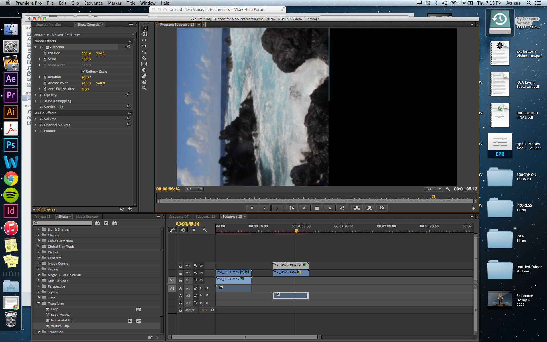

    Oct 2014
    Correct, whether I crop it or not is of no consequence, this is uncropped but flipped. And no worries, I'll keep experimenting and hopefully stumble onto a solution eventually, thanks for all your help!

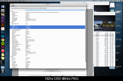

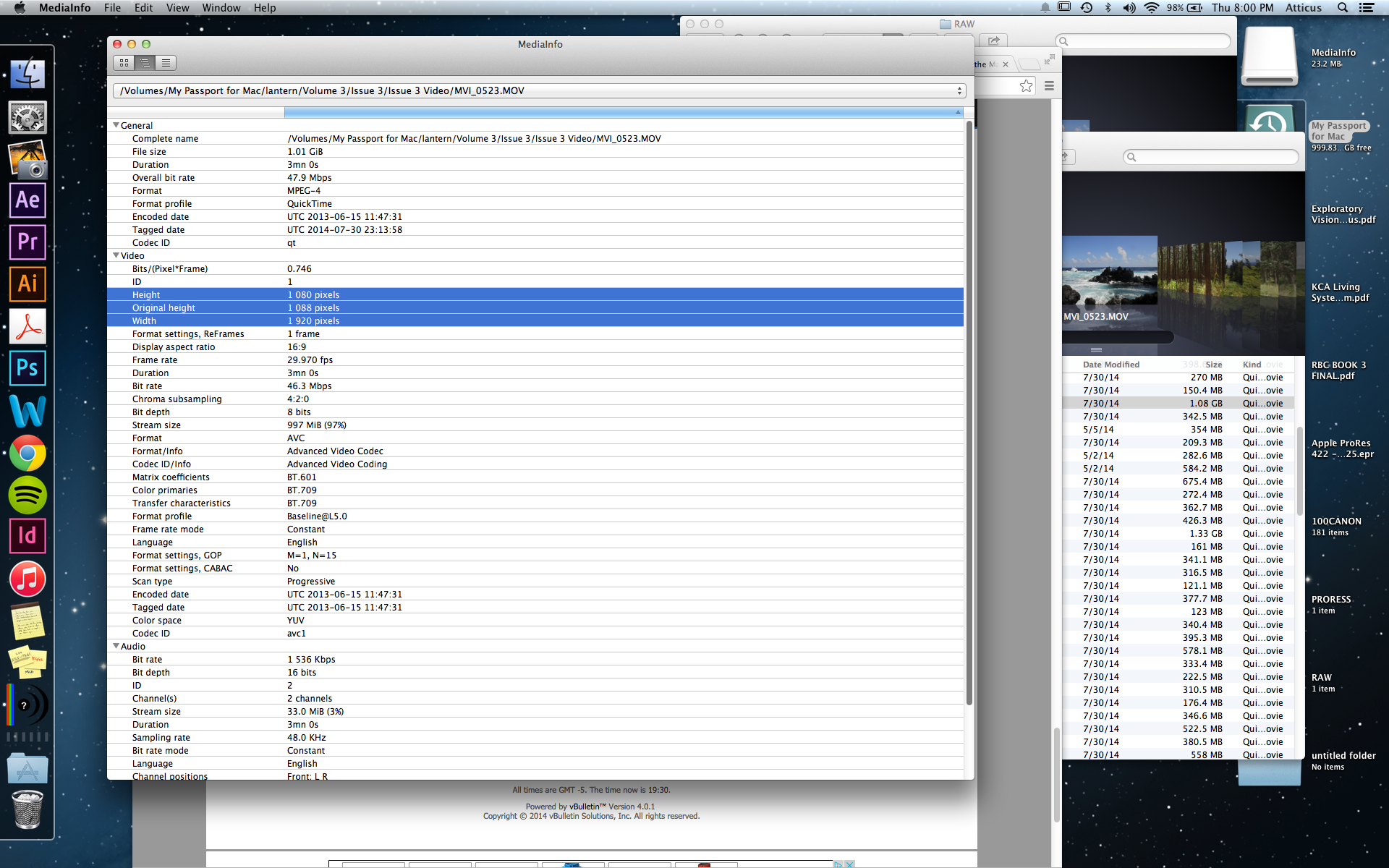

  24. Use mediainfo (view=>text) on the DSLR original, and the Prores version. What is the reported height ?
    In premiere, what does it "think" the height is for both ?
    Most Canon DSLR's actually store it at 1920x1088 (yes, 1088) , most programs and decoders obey the "crop frame" flag (it's a flag in the bitstream that says discard the bottom 8 pixels to return 1080 ) . Perhaps something is going on with that ? I'm just throwing out wild guess now, because I really have no idea

    On both they say = original height 1088 but for height read 1088Click image for larger version

    @dzahorsky, I think you mis-quoted the screencap you posted: it says Height 1080, Original Height 1088, Width 1920.
    So, I'm betting money on pdr's assessment of fallback to original height when rotating/flipping. Which really ought to be considered a bug and flagged.
    ...Although, a conversion to 1920x1080 ProRes should NOT encounter that feature, as it shouldn't have a problem with non-mod16 sizes. Hmmm...
    I'd go with having pre-processed (rotated, flipped) versions (via AVISynth), so there is NO rotation/flipping going on WITHIN PPro itself. If that segment is avoided, I'll bet the rest works perfectly fine.
