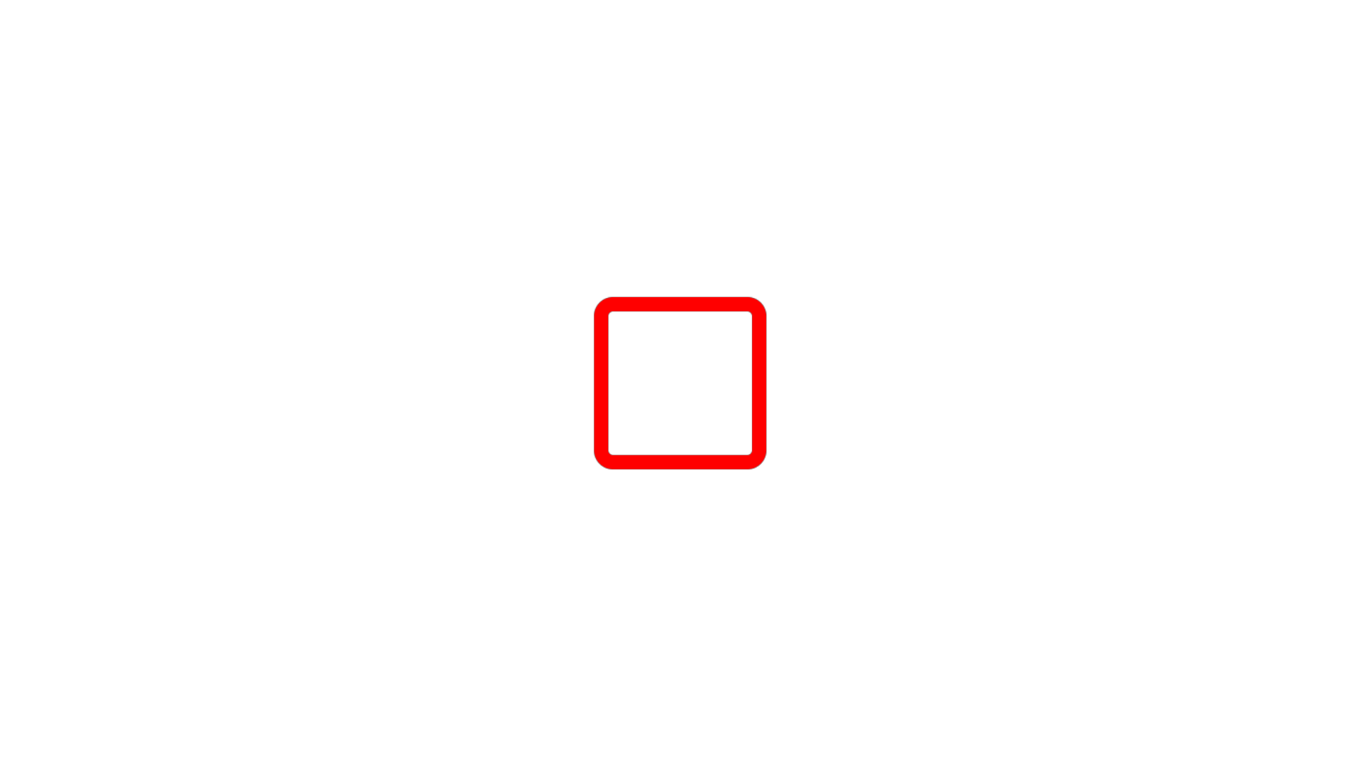

  10. Ok no problem
    There are no "sharp" or tight corners on your jpg
    This is 1920x1080 25p , lagarith RGBA

  12. Originally Posted by poisondeathray View Post
    Ok no problem
    Wow, that was quick! You're a star, thanks a lot. Works a treat
    What sort of mask did you make to handle the reveal? Did you move it with key framing?
    Terry, East Grinstead, UK

    I actually "cheated" and used after effects and the "stroke" effect because it's a even quicker to do there
    But in general, to do the mask reveal, you just keyframe the mask reveal layer. If you have complex shapes, graphics, lines, whatever, often you have to break it up and do multiple layer reveals
    And I guess you could call a 90 degree "corner" sharp, but in the context of how this technique is usually done, that is not sharp at all . When you have acute angles, such as 10 degrees, sharp vertices, like the letter "V" - that's where you run the risk of overlapping the reveal. Or especially handwritten text with big looping letters that circle and cross back over - those are more challenging scenarios

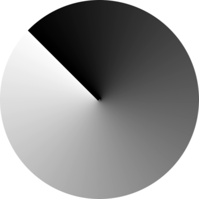

  18. oops I actually uploaded an RGB version, not RGBA (alpha) version above , but I'm sure you figured it out when you had to key out the black. I uploaded the proper RGBA one below
    Just about every NLE has a radial wipe effect, but here is an avisynth version , using the radial wipe idea from Scott . It uses the same still frame which can done in any image editor. The leading edge angle changes and is linear (not a rounded edge, as if you were using a pen tip) . You could feather the edge more by blurring the mask edge more.
    It uses the same mask reveal concept, but in the form of a white circle. This type of "mask reveal" is also known as a "luma matte" or "luma mask" in some NLE's. Areas in 100% white are transparent, or fully revealed. Areas in 100% black are completely not revealed. Shades of gray are in between for transparency. They are called "mask reveals" because the rectangle, or shape, or signature, or whatever is already there on the background layer. That's the thing you made in photoshop or image editor. Earlier you asked : "But I don't see how to re-create an animated video effect like the one I uploaded with a static image editor? " . So it's not really animating, it's the mask that is animating, revealing the still image as the background layer
    Here is an animated gif for illustrating the luma mask
    Interestingly, I couldn't find an existing proper "radial wipe" filter in avisynth. I found "clockwipe" , and "circlewipe", but they were very buggy and didn't produce proper results on the end frames, so a workaround with scriptclip was used to accumulate the rotation. scriptclip can be buggy too if you do random seeks (you have to go from start to finish linearly)
    orig=ImageSource("rgba.png", pixel_type="RGB32").Trim(0,100).AssumeFPS(25).Crop(640,220,-640,-220,true)
    black=blankclip(orig)
    whitebar=blankclip(101,32,320,"RGB32",color=$FFFFFF,fps=25)
    smallblack=blankclip(101,640,640,fps=25)
    overlay(smallblack, whitebar, x=304)
    rotate(-40,0,0,100,320)
    blur(1.5,1.5)
    rot=last
    b=blankclip(rot)
    ScriptClip("""
      b = b.Loop(2,0,0).Overlay(last, mode="lighten")
      return b
    mymask=last
    black.trim(0,-1) ++ overlay(black, orig, mask=mymask)
    addborders(640,220,640,220)

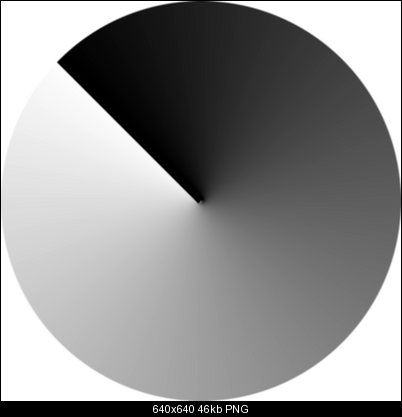

  20. I thought someone might find this interesting...
    use a radial wipe reveal in your NLE.[/INDENT]Scott
    My original idea was to use a radial wipe. But AviSynth doesn't have that. And I wanted to use only two images to perform the animation. So I needed a circle with a circumferential ramp. A quick search didn't turn up any such images and I was too lazy to write a program to make one. But poisondeathray's animated gif gave me a way to make one -- just blend all the frames together into one image.
    So starting with a white box on a black backrgound:
    And a circumferential ramp (built with a small modification of pdr's script, and merging all the frames into one):
    And this fairly simple script:
    function AnimateBinarize(clip vid, int threshold)
        mt_binarize(vid, threshold)
    ColorBars(width=680,height=480, pixel_type="YV12")
    rect = ImageSource("rect.png").ConvertToYV12(matrix="PC.601")
    black = BlankClip(rect).ColorYUV(cont_y=32)
    red = BlankClip(rect, color=$ff0000)
    ramp = ImageSource("ramp.png").ConvertToYV12(matrix="PC.601").BilinearResize(rect.width, rect.height)
    amask = Animate(0,50, "AnimateBinarize", ramp,0, ramp,255).Invert()
    omask = Overlay(black, rect, mask=amask).GreyScale()
    Overlay(last, red, 100, 100, omask)
    Overlay(last, red, 300, 300, omask)
    Trim(0,50)
    I produced the attached animation. ColorBars() was used to produce a background video on which to overlay the boxes. mt_binarize() was used to convert the circumferential ramp into an animated two tone (black, white) mask. That mask was used to animate the rectangle mask. Finally a red image was overlaid onto the video via the animated rectangle mask, in two different locations.
