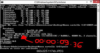

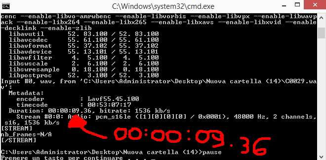

  5. sorry, instead of the framecount I need to have in a variable this 00:00:09.36 exactly in this format: 00:00:09.36
    I'm looking for the command that with ffprobe do this ^^
