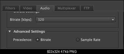

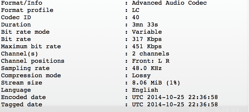

    Hi All,
    i Have a problem on redering video at H.264 codec and AAC audio codec on Adobe premiere pro
    i want to render audio at 320 but the problem he gives me on result just 317 kbps and the company don't accept it like this
    what can i do please help me.
    Thank you

  2. Member Cornucopia's Avatar
    Then stop using vbr and use cbr audio. Problem solved.

    Hi Scott,
    i don't have the option on adobe premiere pro that i cant use CBR.

    Then you should encode the audio separately, and later add it to the video.
    Even though I serious doubt there exists any AAC compressor which supports ACTUAL constant-bitrate mode...

  8. ..

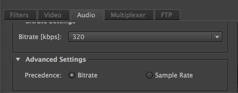

    Oct 2014
    Morocco
Name:	Capture d’eÌcran 2014-10-29 aÌ€ 13.43.04.png
    i can't find the CBR
    see attached
    Sep 2012
    Australia
    I just tried both iTunes and NeroAACEnc in CBR mode and they both spat out VBR, Nero's maximum bitrate was kept much closer to the nominal bitrate but they both managed to achieve exactly 320000bps overall.
  11. Originally Posted by mediatuch View Post
    That is CBR.
    Sep 2012
    Australia
    Yup, VBR would use a quality based setting. Whatever AAC Encoder your program is using sucks. Try NeroAACEnc or iTunes instead.

  14. DECEASED
    Jun 2009
    Heaven
    Well, as I said, first create the video without audio,
    then re-compress only the audio with a standalone encoder (such as NeroAACenc, suggested above),
    then remux with MP4Box, or MP4Creator, or (as a last resort) with FFmpeg.
    I don't use Adobe Premiere, and I don't have a Mac.
    NeroAACenc, fhgaacenc or enc_aacplus would require WINE.
    But you might always use iTunes or QuickTime for AAC encoding --- or not
    MP4Box should have Mac-compatible builds, if I am not mistaken.
