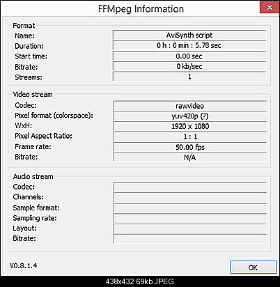

    in attachement I have do a video of my cat
    when I load it on virtualdub using the fmmpeg plugin OR using this avisynth script:
    FFVideoSource("C:\Users\Administrator\Desktop\gatto\GOPR1406.MP4")
    duration of the video is: 5.78 seconds

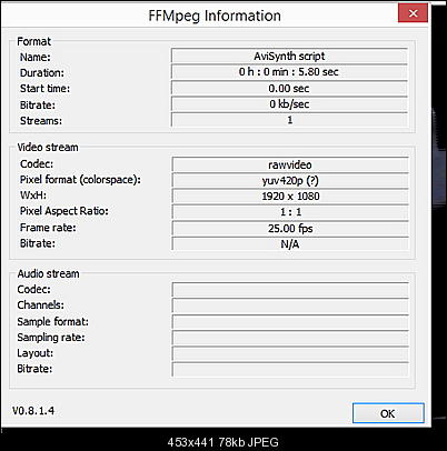

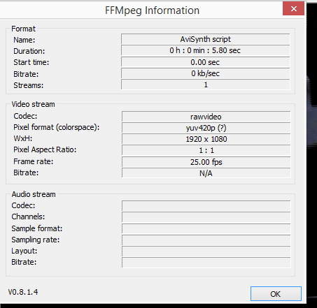

    But when I load it on virtualdub using this script:
    AssumeTFF().SeparateFields().SelectEvery(4, 0, 3).Weave()
    duration of the video become 5,80 seconds
    can someone tell me why? How can I get 5,78 sec using the
    line? thanks
  2. The source has an odd number of frames and you're cutting the number of frames by half. You can't have half a frame at the end so it's being padded to fill out the last half frame.

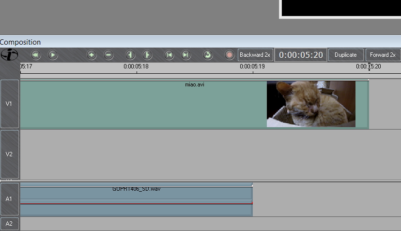

  6. my problem is that:
    from the gopr1406.mp4 I extract audio with ffmpeg using:
    ffmpeg.exe -y -i gopr1406.mp4 -filter_complex "[0:1] volume=1.5" -c:a pcm_s16le gopr1406.wav
    and this .wav have, in timeline, have duration of 05 sec 19 frames
    but using avisynth with the script
    or AssumeTFF().SeparateFields().SelectEvery(4, 0, 3).Weave().Trim(0, last.FrameCount)
    I have the video track that are 1 frames in excess (have duration of 5sec and 20 frames) so my nle don't "attach audio-video"
    how can I help my cat?

    Oh, right, you're halving the frame rate. *2 /2 /2
    Um...
    That would mean each frame has twice the duration, if there were an odd number of video frames in the source then it's simply not possible to match that length, you have no choice but to extend the audio.

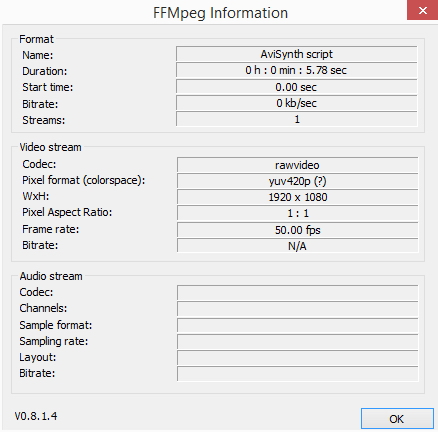

  10. Code:
    AssumeTFF().SeparateFields().SelectEvery(4, 0, 3).Weave().Trim(0, last.FrameCount/2-2)
    in fact with this virtualdub (File information) get a duration of 5,72 second (should be 5,78) and in timeline duration is 5 sec and 18 frames (should be 5 sec and 19 frames to match audio)
  11. I fixed the script before you posted. It ends in -1 now rather than -2.
    And, once again, YOU WILL NEVER GET S 5.78 SECOND CLIP WITH 25 FPS VIDEO.
  12. 5,76 but it's ok in timeline!! thanks Name:  SMC.jpg
