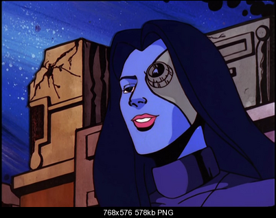

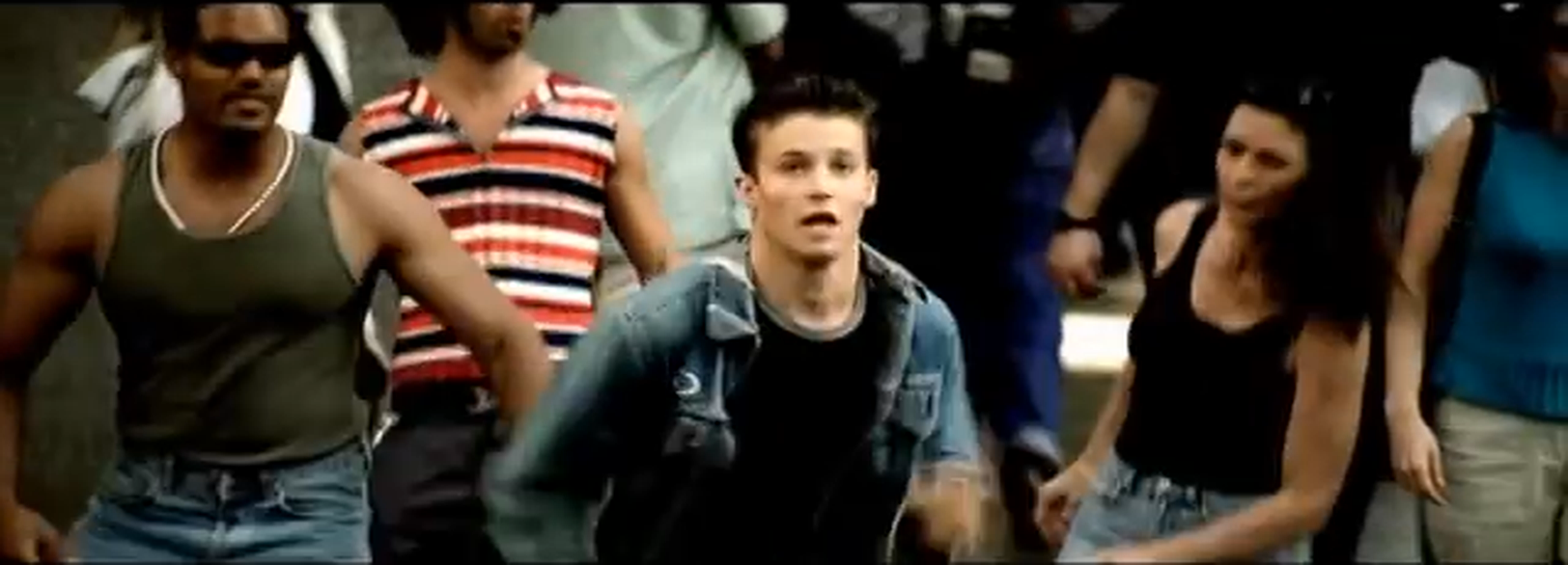

    I've come across this issue with many videos, never really bothered me, but it's starting to.
    In the snapshot below, if you look at the woman's hair, there's some sort of blockiness going on, not sure if it has to do with the way the video was compressed or if it has to do with noise.

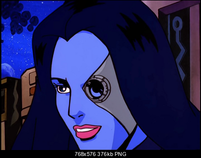

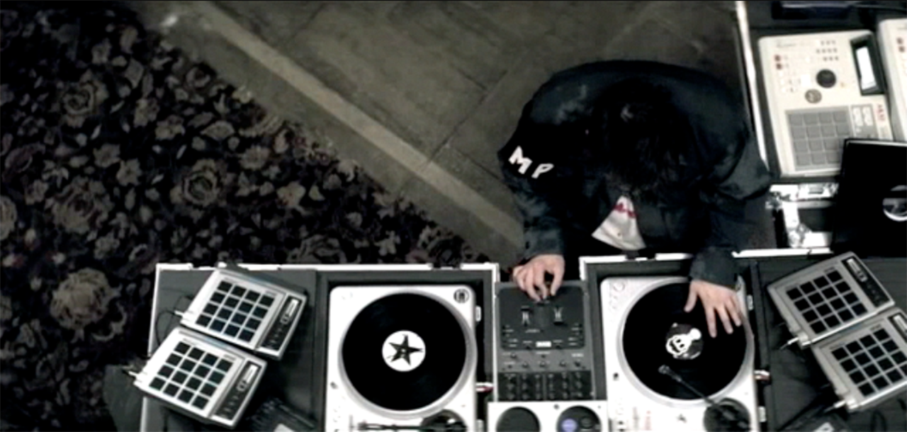

    Not sure what to call it. Here's another:
    Is there any way to get rid of it or filter it out? Would be nice.
    Please let me know, thanks.
    May 2014
    Memphis TN, US
    They are banding and macroblock artifacts caused by:
    a) insufficient bitrate to maintain enough data to define fine gradients or large expanses of solid color.
    b) Over filtering, especially removing too much original grain (seems likely here)
    c) Improper conversion of colorspace, as from YUV to RGB to YUV, etc.
    d) data loss through careless re-encoding.
    (e) Any and all of the above
    Best repaired by going back to an earlier version of the source video and processing more carefully. Adding noise (fine grain) and using debanding filters such as GradFun2DBmod or GradFun3 before encoding often helps.

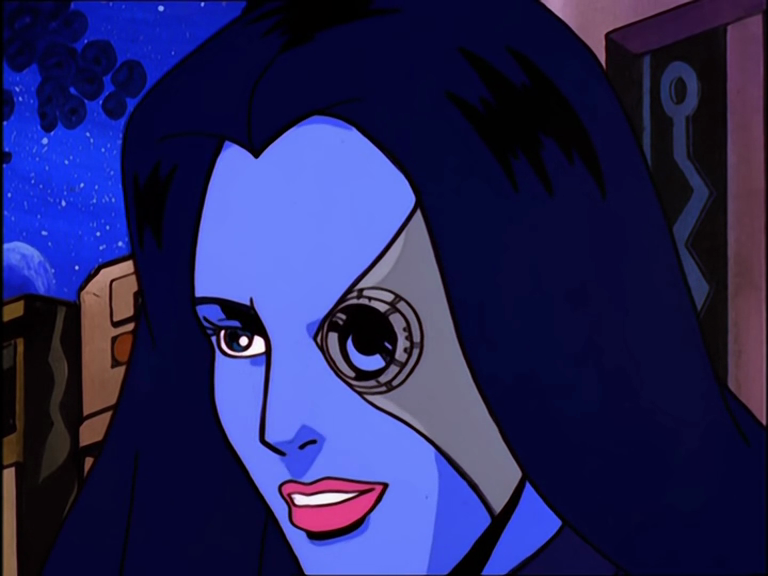

    [Attachment 28160 - Click to enlarge]

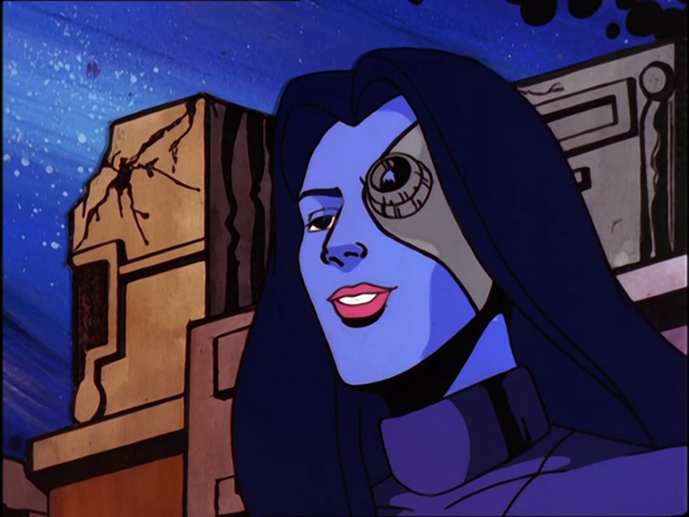

    For animations you can apply a mild surface (e.g. edge aware) blur:
    May 2014
    Memphis TN, US
    Chances are about 50% to 75% that the artifacts will return during the next encode.
    - My sister Ann's brother
  9. Just converting it back to YV12 will bring a lot of the posterization back (though in a less blocky pattern) because there are fewer available colors and the differences between them are greater. As LMotlow pointed out, you really need to add noise and encode with sufficient bitrate to keep them away. Or work and encode in 10 bit YUV.
    If you encode it to a low end quality codec like used on Youtube chances are it is closer to 100%.
    For instance here is a before and after video encoded with DNxHD and uploaded to Youtube. I can see that the DNxHD video clearly shows a difference between before and after but watch what happens when I put it on Youtube and it gets re-encoded:
    https://www.youtube.com/watch?v=YnkqJJ0R17o&feature=youtu.be
    The mess is pretty much back!

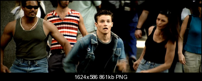

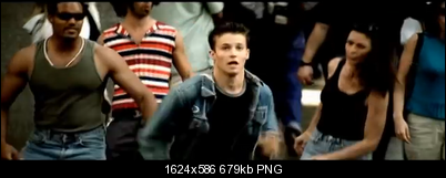

    For the music vids, why don't you download the HD versions to start with? e.g. vevo, other youtube sites, vimeo. There are free tools and methods available to download from vevo (e.g. ffmpeg)
    Some of the older music videos will be upscaled SD, but even upscaled it might be better overall because of the higher bitrates used in the "HD" version . Also, the "HD" versions tend to have higher audio bitrates, and added bonus. There might be some other "gotchas", e.g. sometimes the frame rate might be different, or aspect ratio wrong, but the image quality should be better because of the bitrate allocation
    eg. bon jovi. Here is the youtube version you linked to, and the vevo version 1:1 crop. The youtube version is resized to match (both AR's are wrong IMO BTW, but I just did it for comparison purposes) . Clearly the vevo version has more detail, but one of the "gotchas" is it's the "euro" version at 25FPS in this specific bon jovi case, but they are clean duplicates (not a field blended version) so easily decimated back. No amount of "restoration" will bring that YT video you linked to this amount of detail.
    Start with the best material you can get your hands on, then work from there

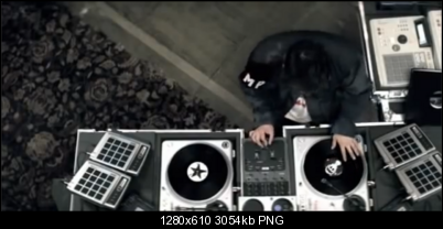

  28. After looking at the music videos on iTunes again. I still think they a bit on the pricey side considering that the quality isn't perfect (still blocky, etc.).
    But after seeing different levels of detail, I don't think it's too bad, most of them I've seen look to go for around $2..
    Here's a comparison:
    YouTube:
    iTunes:
    I believe with a bit of filtering, it should look as good as ones on a decently produced DVD.
    I'm just thinking of it as a good alternative when there's no decent versions of a video out there quality-wise.
