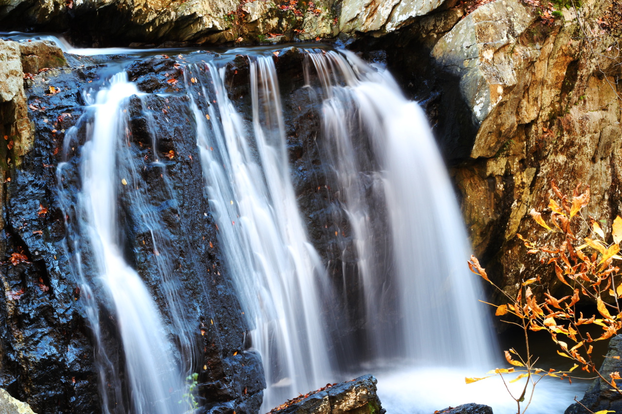

    It's been a long time since I've used it, but today I shot some slow-shutter-speed shots with my trusty 50 mm Canon Lens (aka "Nifty Fifty") mounted on my t2i. The target was a WaterFall, I shot with an F22 @ 2.5 sec shutter-speed for motion blur on the falling water. I think it looks pretty darn cool...........

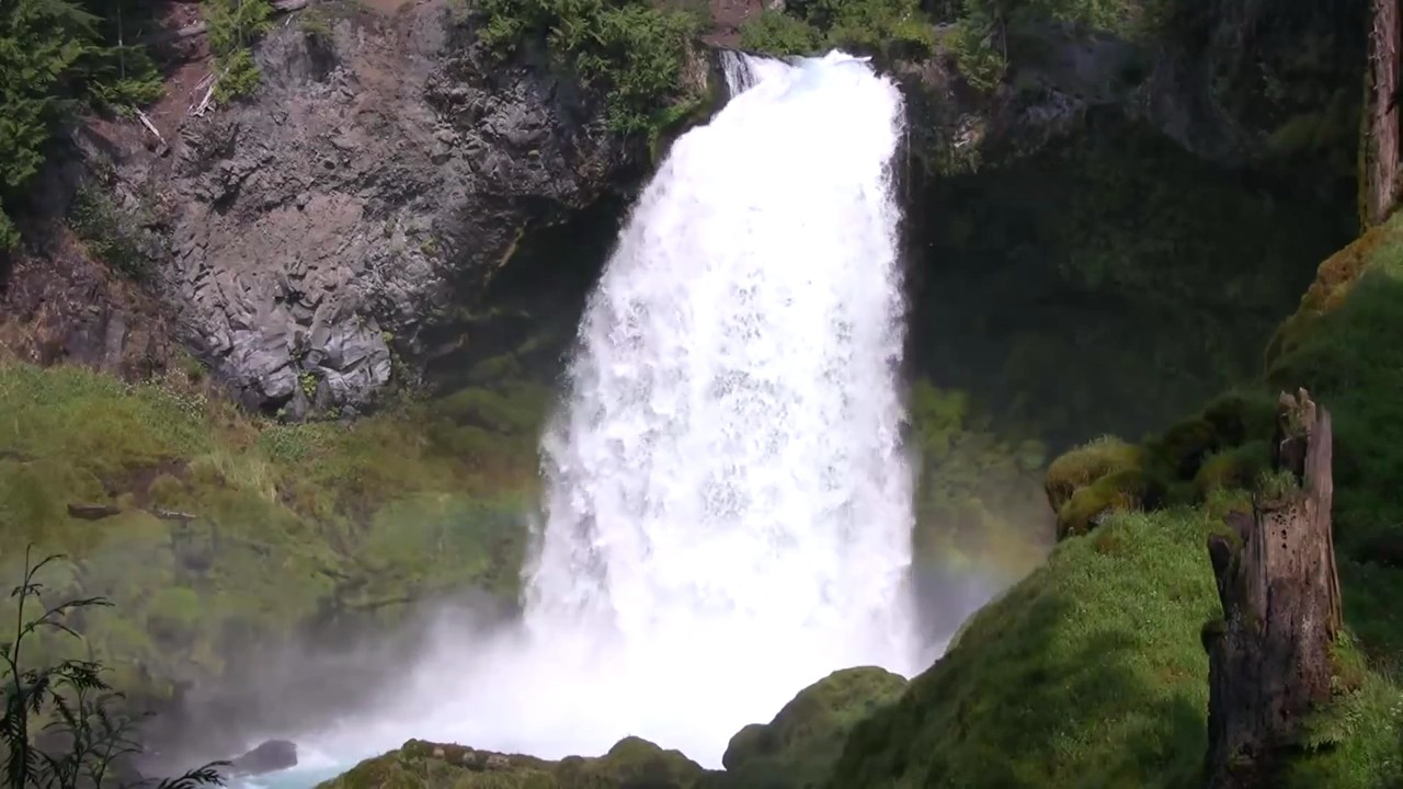

    Single frame from a random Youtube waterfall video:

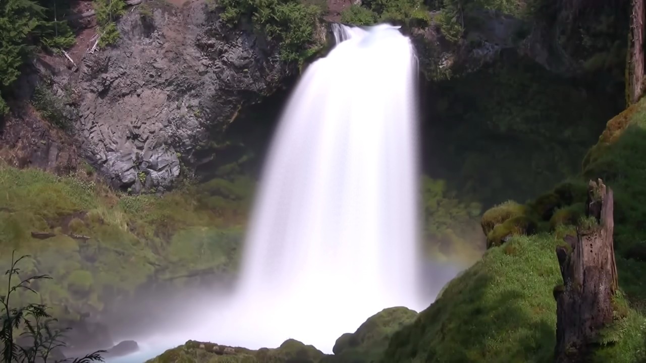

    64 frames merged together (6 successive Merge(SelectEven(),SelectOdd()) command in AviSynth):

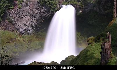

  8. Here's ten seconds in motion using a lightly different technique. And the original Youtube video:
    http://www.youtube.com/watch?v=Qo3OM5sPUPM
  9. Member racer-x's Avatar
    Mar 2003
    3rd Rock from the Sun
    I like the effect. Could you post the script you used?
    Thanks.
  10. I did this:
    # first add motion interpolated frames to give smoother blends
    AssumeFPS(30000,1001) # make it exact
    SmoothFPS2(120000,1001) # motion interpolate 4x
    Merge(SelectEven(),SelectOdd()) # blend down to 2x
    Merge(SelectEven(),SelectOdd()) # blend down to 1x
    #now blend frames together
    Interleave(last, last.trim(1,0), last.trim(2,0), last.trim(3,0), last.trim(4,0), last.trim(5,0), last.trim(6,0), last.trim(7,0), last.trim(8,0), last.trim(9,0), last.trim(10,0), last.trim(11,0), last.trim(12,0), last.trim(13,0), last.trim(14,0), last.trim(15,0)) # 16x frames
    Merge(SelectEven(),SelectOdd()) # 8x frames
    Merge(SelectEven(),SelectOdd()) # 4x frames
    Merge(SelectEven(),SelectOdd()) # 2x frames
    Merge(SelectEven(),SelectOdd()) # 1x frames
    The result is the same frame rate as the 29.97 fps source and the same running time. But each frame is a sliding average of 16 frames. Ie, the first source frame is average of source frames 0-15, the second output frame is average of source frames 1-16, the third output frame is average of source frames 2-17, etc.

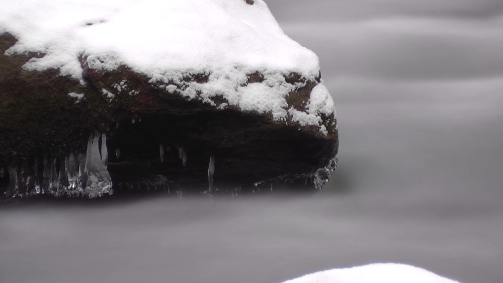

    Using multiple merge commands in Avisynth with video frames is proving to be a very good way to cheat motion blur...........

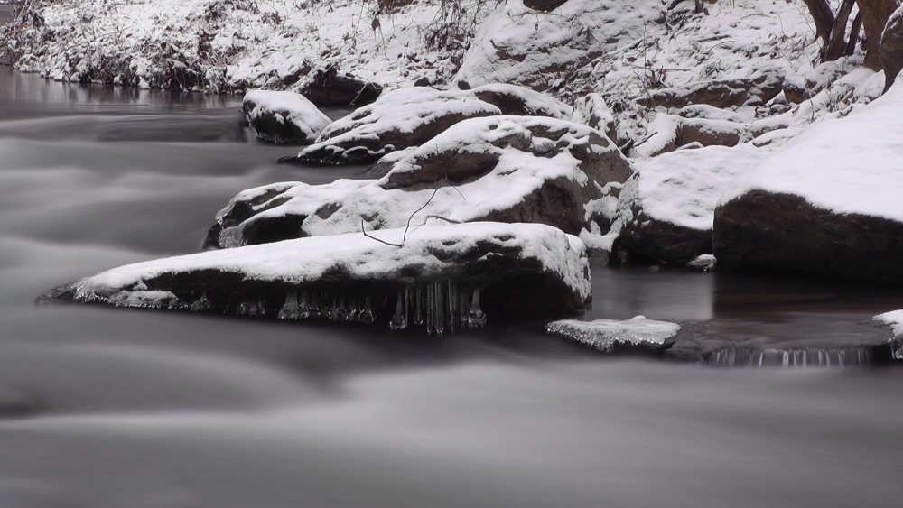

    I really like the blending frames effect using Avisynth on video. I like it so much I find myself looking for excuses to use it. I used it today and the results are just awesome....
