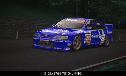

    If I take a snapshot with VLC, colors on the picture will be all wrong. Red will become bllue, green will turn purple and vice versa.

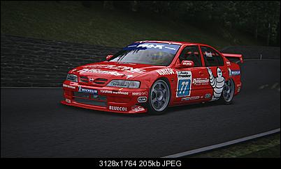

    and here's the image should look like
    The first pic was taken with png, the second was taken in jpg format. So the problems lies in producing png. Strange thing is it wasn't doing that before. I've been using vlc for screenshots for a while and it recently it started to do that. I don't know if it because I installed something but I have done so much things recently in video and hardware department, so I have no idea what's causing it.
