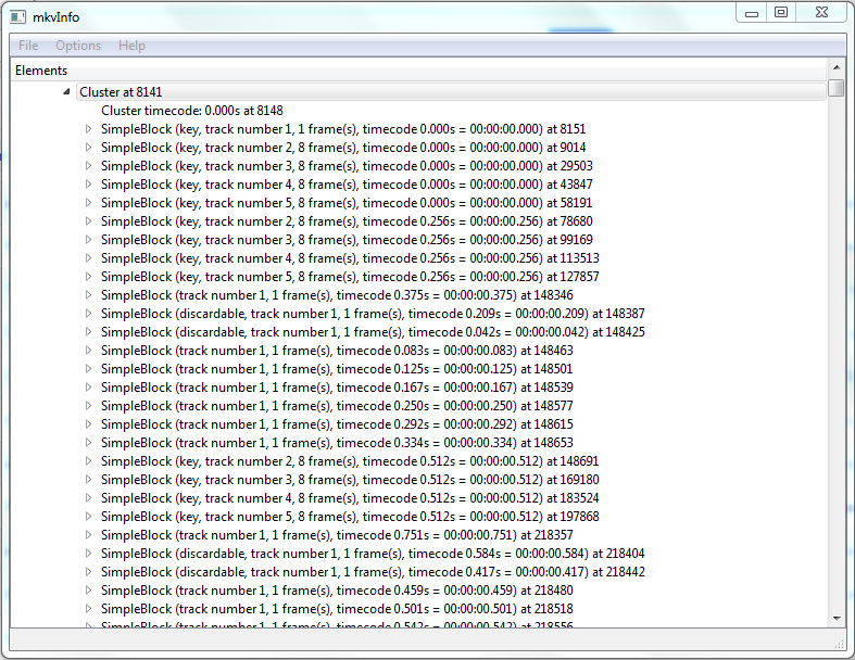

    what the hell is that all?!Click image for larger version
    what are these words, numbers mean?
    is delay 256 ms?
    Sep 2012
    Australia
    There's no delay in there, the 256ms time stamp is for the second block of frames for each audio track. If the audio is out of sync after being processed with Adobe, the problem doesn't originate with the MKV container.

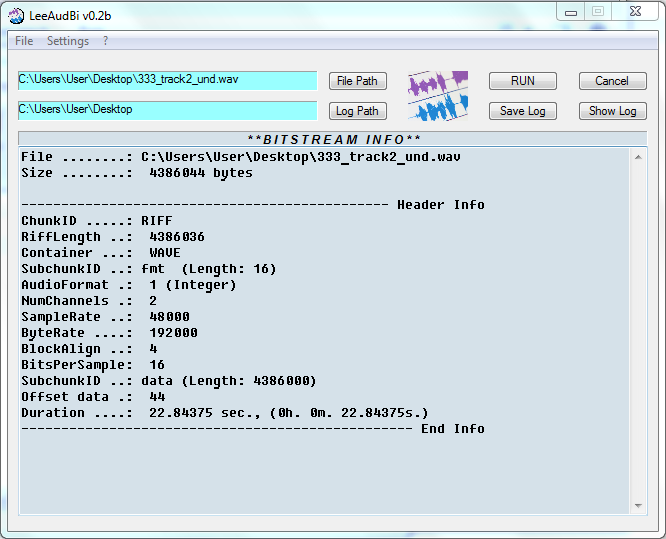

  5. Originally Posted by ndjamena View Post
    If the audio ISN'T out of sync and is just a few frames shorter than the video then that's not really a problem, but if you like all you have to do is figure out a way to replace the gap with silence. Look at the file with MediaInfo and find the "duration" tags for each track (assuming they're there) if the audio is a few frames shorter it should show, if it doesn't then the problem lies solely with the Adobe software.
    mediainfo shows only with minutes.
    can you please download this torrent(http://rutor.org/torrent/324405/beguwij-po-lezviju_blade-runner-1982-bdrip-720p-ot-leo...alnaja-versija) then extract video and first auido track and then tell if they are same or different length?
    because in virtualdub, avidemux, sony vegas, adobe premiere shows different video lengths.

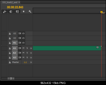

    LeeAudBi v0.2b and adobe premiere shows same audio length. ok no problem. it is 1 h. 57 m. 36.864 s long.
    but cant get video length right. i muxed .h264 file to mp4(with mkvtoolnix) and used different software to know length but each shows different length.
    so important question is : lets say that i have a video that audio is 2 minutes shorter than video. and it's timing is: 1 minute silence(empty space) at the beginning and 1 minute silence at the end. and i extract video and audio and mux them again. question: Will it be like original video or this 2 minutes silence will be at the end? i think that is why there is a delay option in mkvtoolnix. how to know delay?
    and there is "timecode file" option. how can i get timecode file?

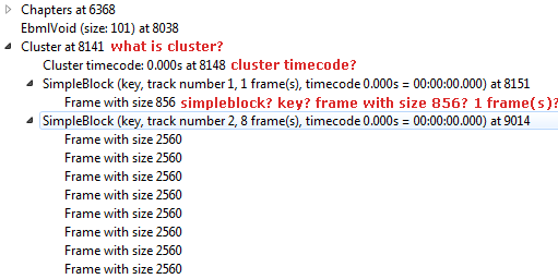

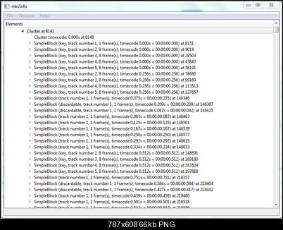

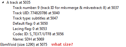

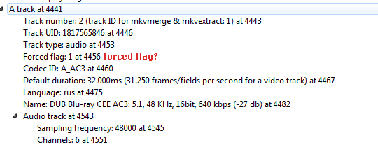

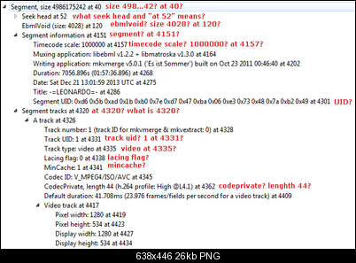

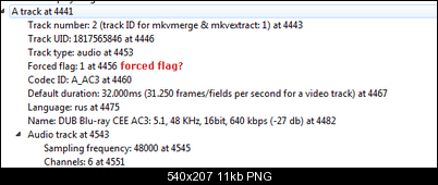

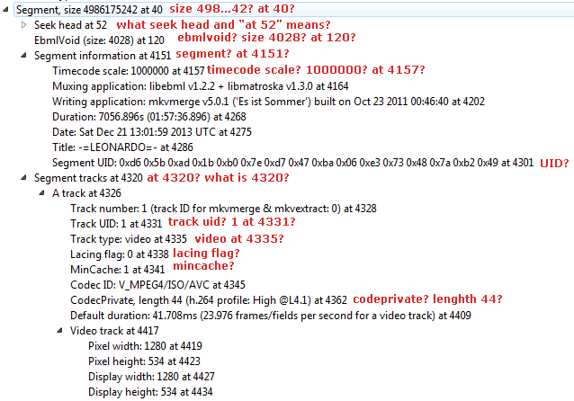

  16. i dont understand what mkvinfo shows. it paralyzes my brain. what are these:
    1
    2
    3
    4
    can you make a guide what is what, where i have to click to see duration, delay?
    cant find these on documentation

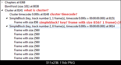

    A "Segment" is a file, Segment Size is the size of the file in bytes, your file is a little over 4gb.
    At, is the position in the file the piece of data resides, you're looking at the innards of the actual file, it's components unsorted, unfiltered and in the order they exist in the file.
    The size is how many bytes in the file that particular piece of information occupies.
    Seek heads list the positions within the file of all the important information so programs don't have to read through the entire file to find anything.
    An ebmlvoid is empty space that anything reading the header should ignore, if adding information to the header a header editor can fill the ebmlvoids instead of adding the information to the end of the file.
    Codec Private Data is data decoders need to properly decode Tracks, Codec Private Length is the size of the Codec Private Data.
    Timecode scale is how the file measures time, in the case of your file it measures time at ratio of one to one million nanoseconds.
    Timecodes are when things start.
    A UID is how Tags, Chapters and other file commands identify each segment and each component within a segment.
    Track Type is the... type of the track - video, audio, subtitle.
    A Block is a group of Frames for a particular track and a Cluster is a group of Blocks.
    It's all here:
    http://matroska.org/technical/specs/index.html
    Just be happy you're looking at the bits that actually make sense.
  18. oh, i was looking at mkvtoolnix documentation.
    i don't understand >90% of this. and it becomes harder to understand when english is bad. right now i need: where to look in mkvinfo to know is there delay or not.
    so where to look in mkvinfo? just give a short answer please)
    and i can see duration only in "segment information". i think it is audio track duration. but when you look at segment tracks there are no tracks' durations.
    for test i set the delay to 20 sec in mkvtoolnix and checked it in mediainfo and it shows delay 20 sec. and in 'general' section it shows same duration which mkvinfo shows in 'segment information'. doesn't it mean that mediainfo works right?

    The first screen shot you gave gives the delay, just look at the SimpleBlocks (or Blocks) and find the first timecode for the track number you're interested in.
    MediaInfo only looks for the first frame in a stream, for the most part that will give the correct answer, but when a stream uses out of order decoding MediaInfo will give out the wrong answer. It took me a long while to figure that out and post the bug on the MediaInfo Forum, Jerome has recognised the problem and it will be fix in the next update. Generally, if MediaInfo reports a delay of 0 in the video stream it will be correct, anything more than that and what it returns is questionable. I'm waiting patiently for the next version of MediaInfo so I can stop telling people that. Unless Jerome updates mediainfo to recognise the new statistic tags, the program still won't know how long each stream is. To find that you'd need to remux the file with MKVMerge (because currently that's the only program that adds the tags) and a tag called "duration" should be added to the end of the file, if you look at the file with mediainfo and cross your fingers, mediainfo MIGHT attach the tags to the correct tracks, otherwise you'd need to look at the file in MKVInfo, the tags section should be somewhere near the end of the file, then you need to match the UIDs in the tags to the trackUIDs. Or if you like you could download FFProbe and point your file at it, it should attach the tags to the proper tracks.
    I was hoping MediaInfos Delay problem and MKVTag reading would be fixed by now, but Jerome has more important things to do.

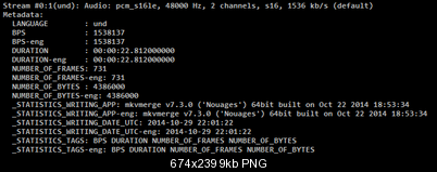

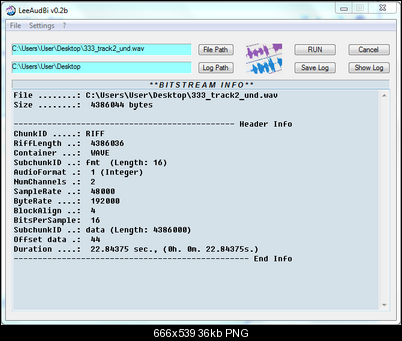

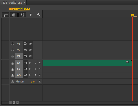

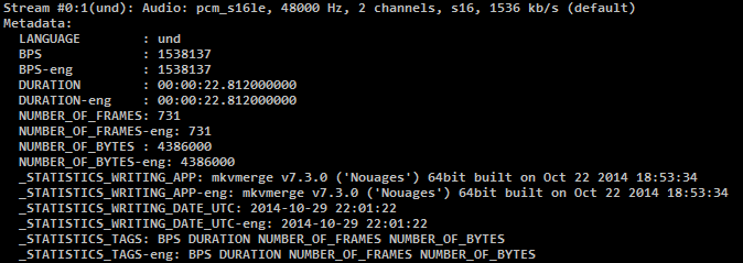

  20. in LeeAudbi and adobe premiere audio track duration is same but in ffprobe it is different.
    extracted this audio file with mkvextract
ID:	28268Click image for larger version
ID:	28269Click image for larger version
    and i find trackuid in tags. but i don't know what to do next with this . can you explain again how to see track duration in mkvinfo?
  21. Member Cornucopia's Avatar
    ffprobe is wrong.
    If the total # of bytes is 4386000 and the audio file is 48kHz/16bit/2ch (aka 1536000bps), ffprobe's "BPS" designator is wrong. Also the duration calculation based on it is wrong. 4386000 * 8 = 35088000bits. Divide that by the true bps (1536000) and you have 22.84375: exactly what LeeAudibe told you. If you divide the total by the ffprobe-stated bitrate (1538137 bps), you get your ffprobe-derived "22.812..." duration.
    I'm guessing it is a mis-judged assumption of bitwise prefix nomenclature or something.
    BTW, Premiere matches LeeAudibe, it's just rounding down to lesser # of decimal places.
  22. Member
    Sep 2012
    Australia
    Except it's not FFProbe saying that, FFprobe is just repeating what is in the tags, tags which were written in by MKVMerge. It's possible, (though unlikely) the audio has been stretched in some way, but Mosu should probably look into this anyhow.
  23. Member
