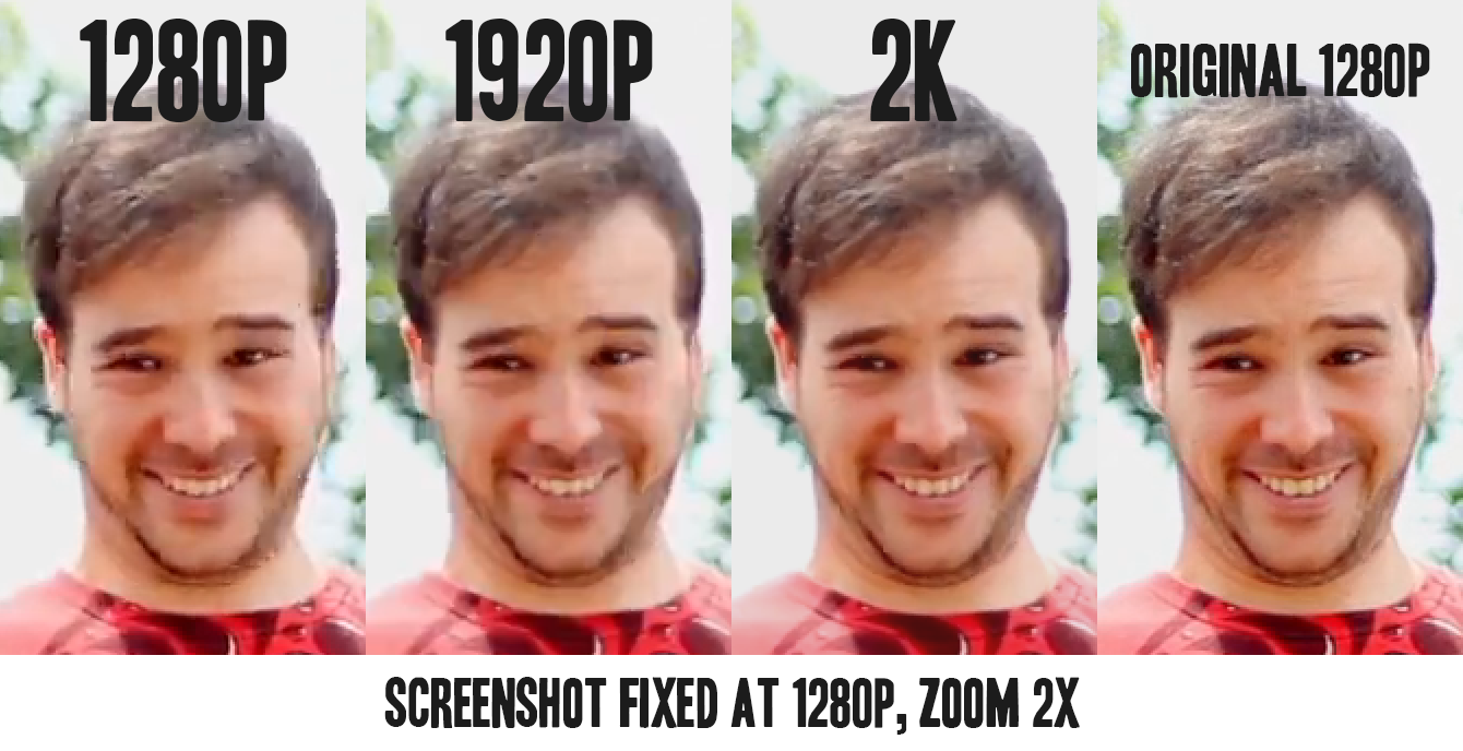

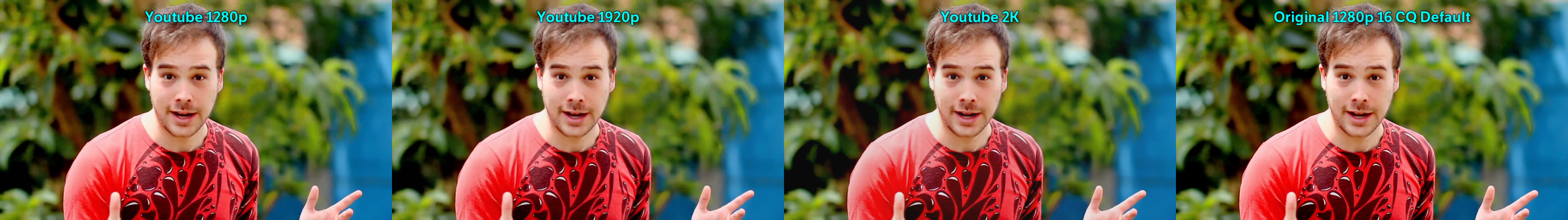

  7. As promised, here's the comparison:
    From left to right each image brings more detail, especially in the eyes area.
    The videos at 1920p and 2K are upscaled in Sony Vegas with default settings, rendered Ripbot at 16 CQ (default preset), uploaded and ripped from Youtube and compared back in the original resolution (1280p)
    Here's the comparison gallery.
    You can download the original video samples here.
    And watch in Youtube: 1280p, upscaled 1920p, upscaled 2k.
  8. Thank you, as I guess all that took a lot of time and effort.
    I think by 1280p you mean to say 720p, and by 1920p, 1080p
    I see very little to no difference at all, and certainly not enough to make it worthwhile upscaling 720p to 1080p. But to each his own. I think you'll have to do the full upscaling yourself, though, without fooling YouTube as you had hoped.

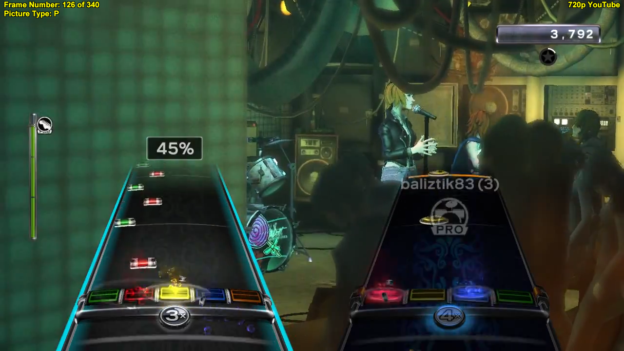

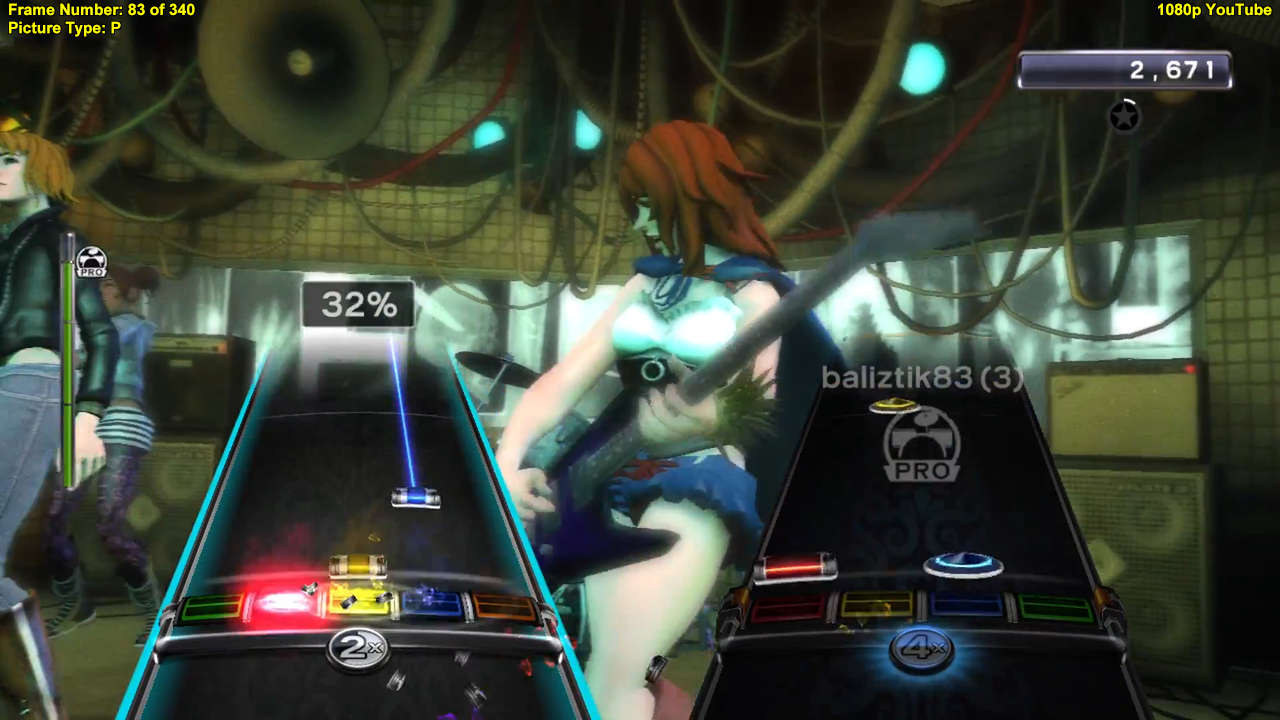

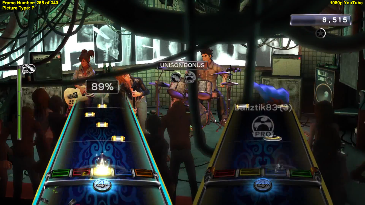

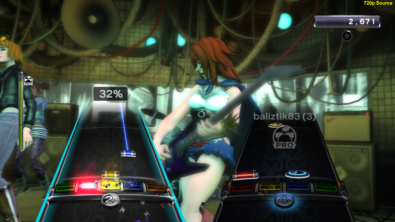

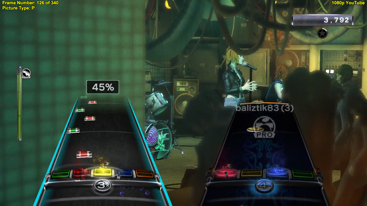

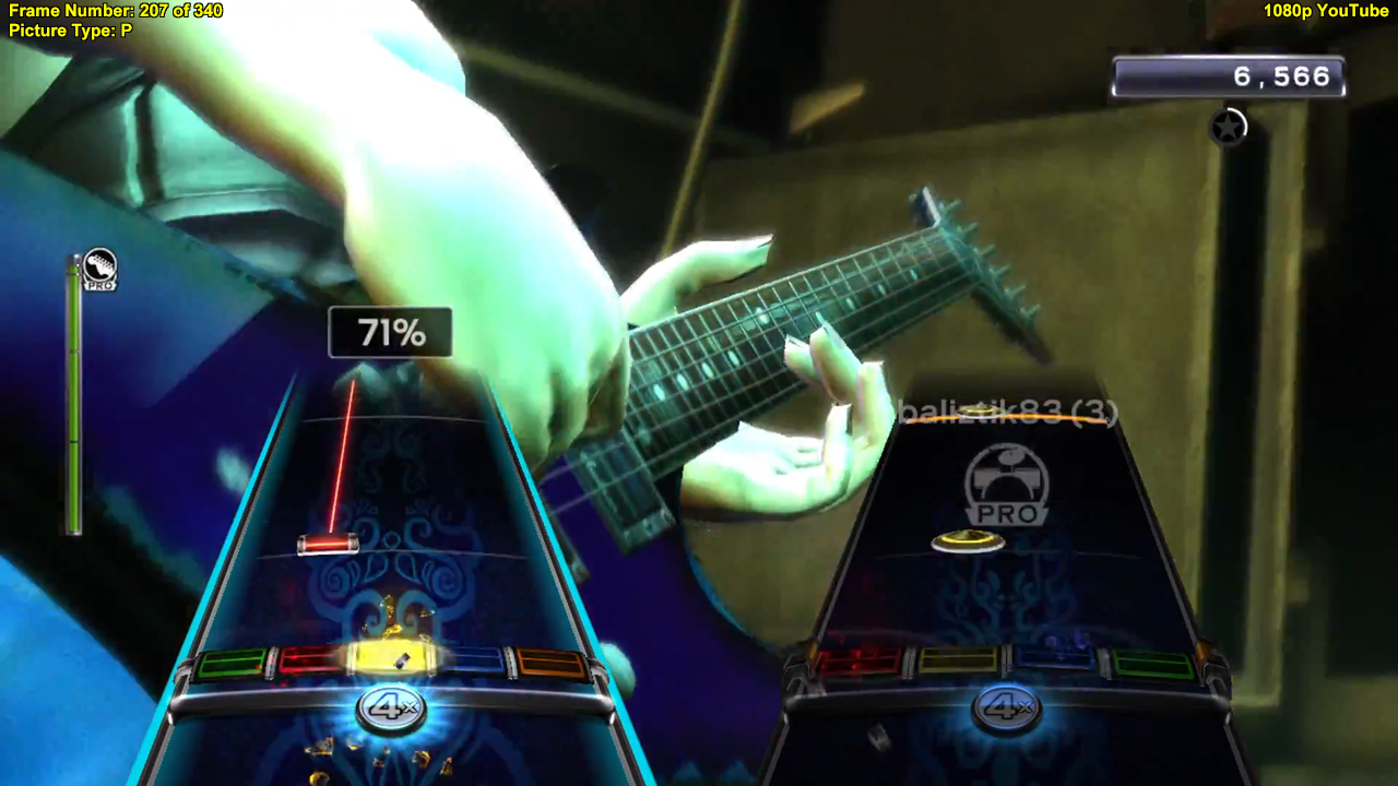

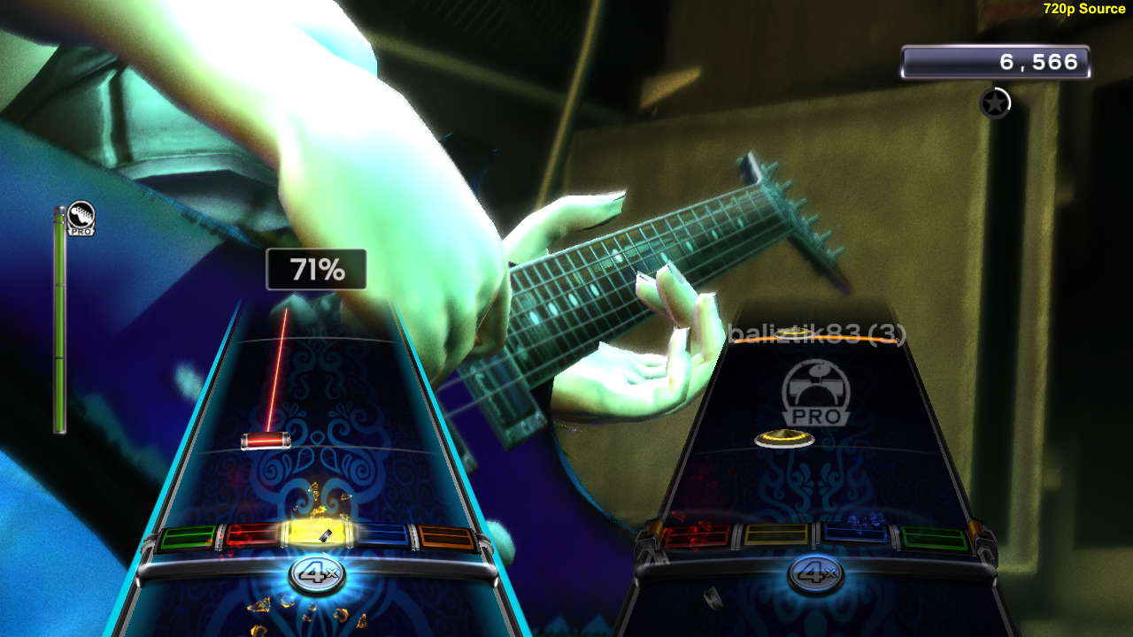

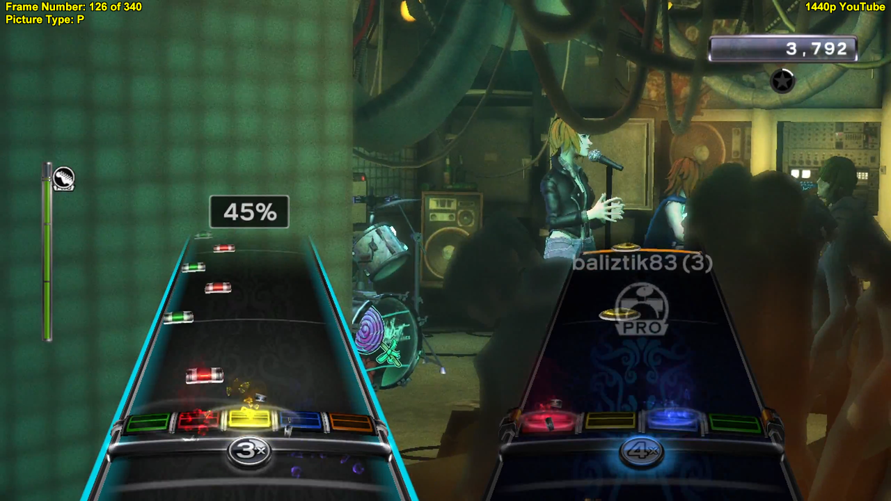

    Here's a 720p video game source. Captured as Ut Video, but for upload to YouTube I removed every other frame and recompressed with ffdshow's Huffyuv since I know it can process that. Initially I used nnedi3_rpow2 to upscale, but then I noticed that confounds the results for a source like this: it straightens lines that are aliased in the original, making the downscale too smooth. So I went with Spline36Resize for upscale & downscale. MP4s were saved using Complete YouTube Saver. For 720p, there are two streams so I grabbed the one with the slightly higher video bitrate.
    I think the benefits of upscaling to 1080p are questionable, but for 1440p it's obvious. Certain very fine details are better reproduced in the 720p version than either of the upscale-compress-downscale versions, for example the microphone in the second image row and the bass guitar strings in the bottom row. But even if your video has those tiny details, it's worth losing them for the sake of the rest of picture.
ID:	28133Click image for larger version
ID:	28135Click image for larger version
ID:	28134Click image for larger version
ID:	28139Click image for larger version
ID:	28138Click image for larger version
ID:	28137Click image for larger version
ID:	28143Click image for larger version
ID:	28142Click image for larger version
ID:	28141Click image for larger version
ID:	28147Click image for larger version
ID:	28146Click image for larger version
ID:	28145Click image for larger version
