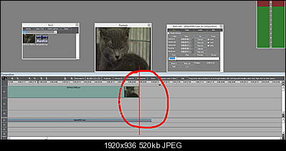

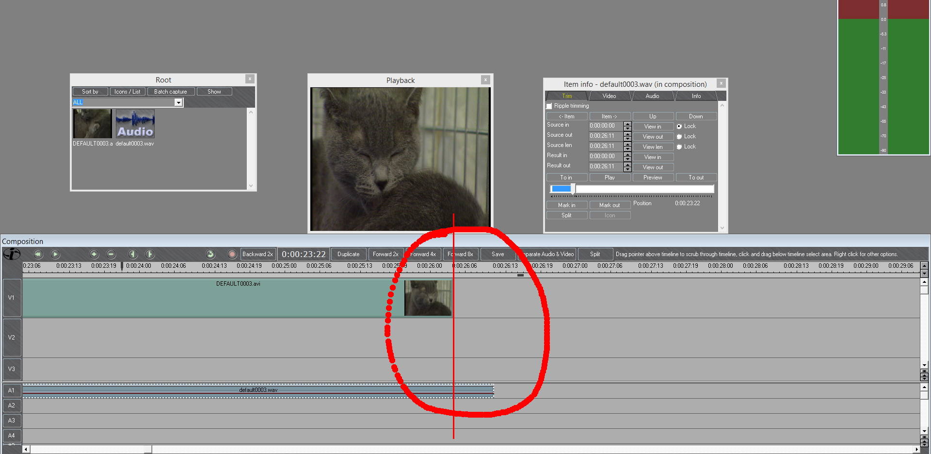

    but sometimes I get that the lenght of the audio file is slightly different between the one the video files: 1 or 2 or 3 frames more or less
