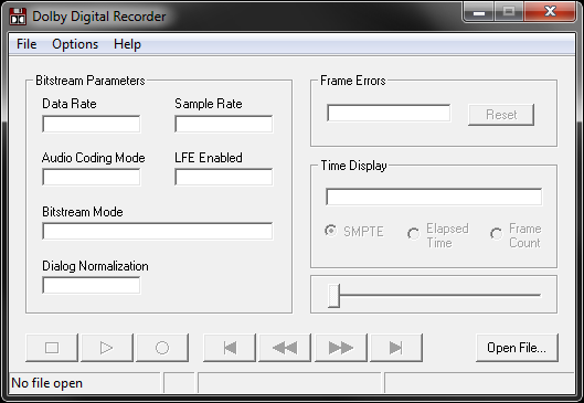

  7. Formerly 'vaporeon800' Brad's Avatar
    Apr 2001
    Vancouver, Canada
    You might try Dolby's own AC3Rec program.
    But from my own adventures in SPDIF recording (1 & 2 for example) I am curious how you're going to overcome copy protection.
