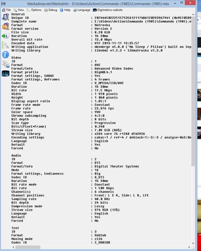

  1. I have several files that play just fine on my pc via Kodi/xbmc with shark007 codecs installed. However, some of them when I burn them onto a backup disc fail to play.
    I've looked at the media info, but I'm not finding any specific line that varies throughout the different files that is consistent.

  2. The ones that don't play probably don't use BD compliant settings. Post mediainfo report (view=>text) for a few of them
    If that's the issue you have to re-encode them using compliant settings, or get a player that plays non compliant material
    Few BD players can play non compliant authored material, and many newer ones can play non compliant data files (not authored, different containers)

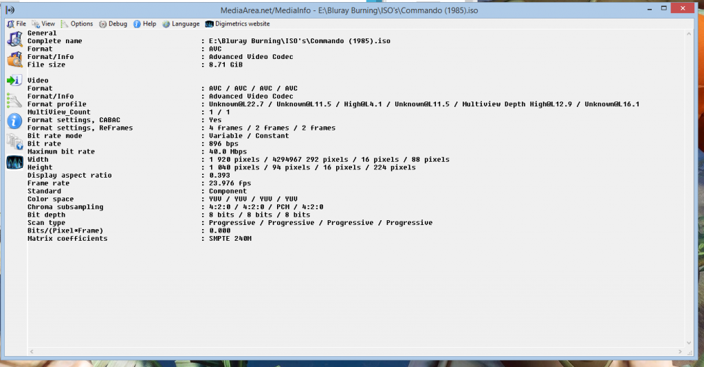

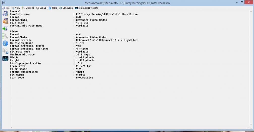

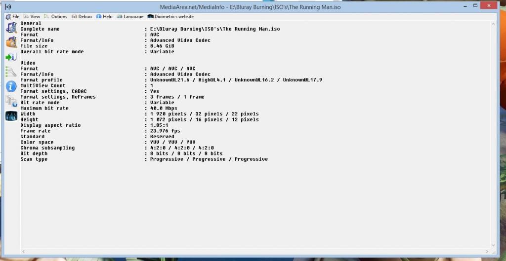

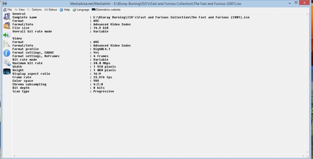

  3. Ok, Total Recall and Fast and Furious work fine. Commando and The Running Man won't play when burned to disc.
  4. 1st 2 don't play primarily because the dimensions are cropped (you need full frame 1920x1080), and profile is messed up (even if it's just a "label") . You would need to add back the borders which means re-encoding (slower, incur quality loss). uncropmkv can do this, or multiavchd, although both hhven't been updated in years, they should still work

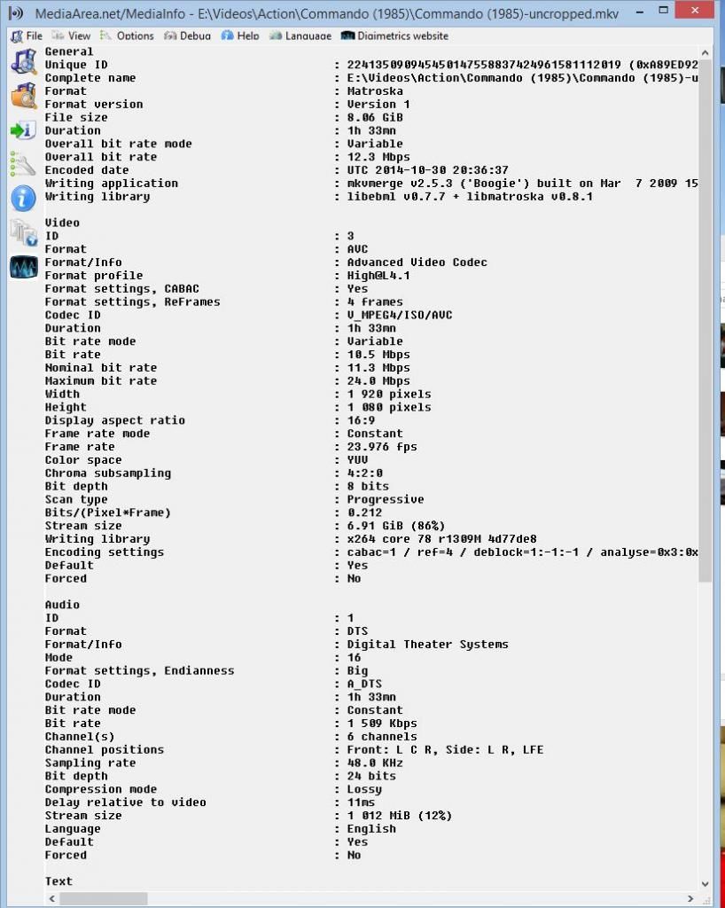

    Ok, on Commando after uncrop via uncropmkv 2pass vhq the audio is out of sync and wont mux to an iso @ around 63%. This is after I uncropped it 2 different times. Also when I attempt to play the .mkv file the audio is all wonky and out of sync. So, that leads me to believe it's an issue with the uncropping process (on the user side) that I'm not familiar with. I believe all I did was set it to convert to 1920x1080 and leave all other settings default. It looks like the original media has ref. frames of 4 and uncrop defaulted to 3. I'm not sure which line is on the text file is for b-frames to verify the numbers there.
    The Running Man I'm uncropping again because it uncropped to some other oddball size. I want to say like 1080x1011. Initially I thought it was because uncropped No One Lives, The Running Man, and Commando all from the queue. Go back and looking at the info Commando was the only one that the ref frames weren't 3 on the original media.
    Right now I'm uncropping The Running Man again and I changed the ref frames to 4 on uncropmkv for Commando.
  12. Ok, the Running Man works fine now. The last issue I have is with Commando still being out of sync when I uncrop it.
  13. I don't know what is going on, because if mediainfo is correct, the duration is 3 minutes longer
    1h 30m vs 1h 33m
    How is that possible for the audio to grow in size and duration (974 => 1012 MiB) if you stream copy the audio ?
    Simplest solution is just re-rip the disc All theatrical BD's are 1920x1080 to begin with
    or Just play it back as a MKV from USB since your player supports that
