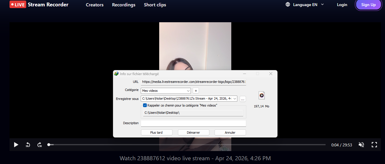

  16. Originally Posted by Matt042526 View Post
    So does this mean they made it a view only on the browser and restricted the downloads? Is there a way to bypass this?
    Cookies are required here → they represent your user login.
    Normal solution: use a tool that retrieves your session (cookies exported from the browser).
    After that you can download with IDM.
    [Attachment 92111 - Click to enlarge]
  17. Thank you so much for all this.
    I'm not from a technical background so I just want to run by you what I understood from everything you shared so far.
    The site got updated with a cookie that only allows downloads after the user is signed in. So now I need to sign in to my account, extract my session info along with my login via tools like AgentAuth (aka Romek), Cookie Importer (Firefox extension), kooky (Go library + CLI) and then put that information into a download manager where it allows the video downloads because now it validates my login info based on thee session info I extracted.
    My apologies for making this so long, I just want to make sure I got it correctly.
    Thank you once again.
  18. All this is not necessary. Authorization is not required. Just use 'IDM'.
  19. Thank you for the quick response, it did work with the 1st file but then it gave the forbidden error for the 2nd file. May be they blocked it this way too. Thanks you everyone for spending your precious time on this and helping me.
