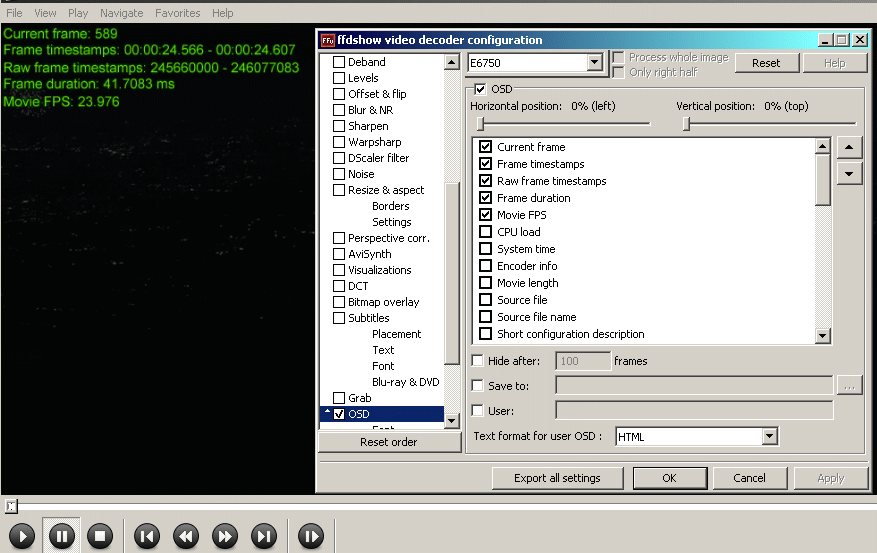

    However the .mov file is from an iPhone 4S and looking at the details, has a variable frame rate. What I need to know is the duration that each frame is displayed for in order to do my analysis. Does anyone know how to find out this information?
  2. Maybe a DirectShow media player such as MPC-HC in combination with ffdshow and it's on screen display.
    Stepping forward through a video frame by frame should be fine but I wouldn't trust DirectShow to navigate back and forth particularly frame accurately. You can navigate to a specific frame via MPC-HC's Navigate/GoTo menu.
  3. That works just great, many thanks
