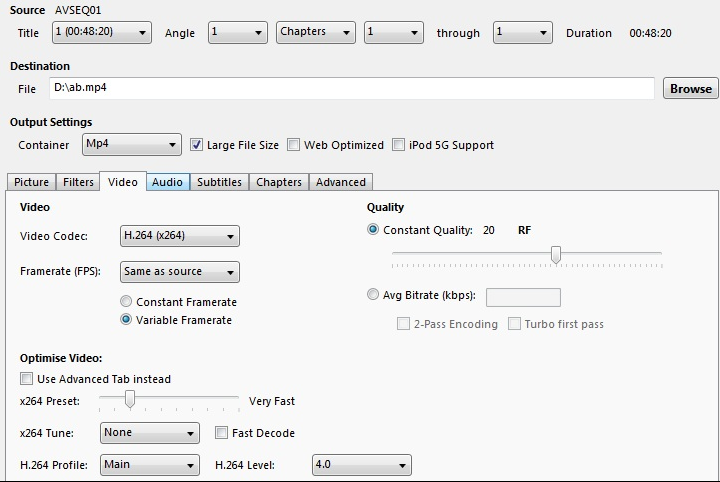

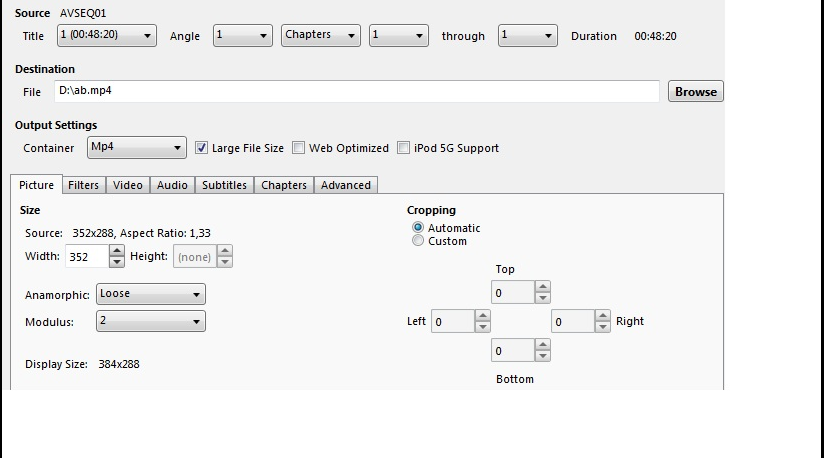

  5. Originally Posted by Baldrick View Post
    You can try with default settings first. Use the high profile preset.
    ahhh, thanks a lot your reply came earlier than expected cause i made those settings now and wanted to show , i switched to large file (i dunno if it's good), in audio to stereo (cause i dont think those are dolby etc.) and the bitrate to 192 kbps and 44.1 khz.
  6. Member Cornucopia's Avatar
    Nonono!
    You are losing quality by reconverting and don't have much to start out with, being VCD. A vcd is just an MPG1 video stream and an MP2 audio stream in an MPG1 System stream container under the hood.
    Since both the video and the audio streams are fully compliant and acceptable as-is in an MP4 container, it makes more sense, quality-wise, to just demux & remux.
    I would use VCDGear to do the DAT2mpg, then TMPGEnc to do the demux and Yamb to do the remux...
    ...just tried it and it's actually even easier. Just do the dat2mpg and drag the mpg into Yamb! It'll do the demux+remux for you.
    <edit>The only downside to this is that M1V+MP2-in-MP4 is not that common, so some apps might not be prepared to used it. In that case, I guess you must go the re-encoding route.</edit>
