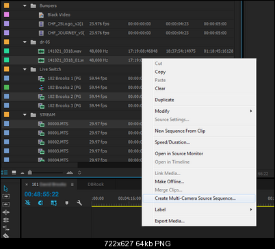

    I was just wondering if there is a way to somehow batch synchronise multiple clips in Adobe CC, used 4 cameras in a 3 hour event all of them DSLR's so they all stop recording at about 12min and restart the proces so there is a 6-10sec gap between.
    As I found out the synchronise option in Premiere CC 2014 works with max two clips, when I select more, the option for synchronise grays out. Any other way to do this? Pluraleyes unfortunately does not sync the clips properly.

    However, Premiere CC is more than capable of syncing multiple clips by audio. You can select as many as you want, right click on any highlighted clip and choose create Multi-Camera Source, then choose audio as the sync method.

  4. Select the clips in the project window, not in a timeline.

  5. thank you, did not even know this option exists. Just started syncing! Thank you again.
