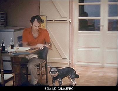

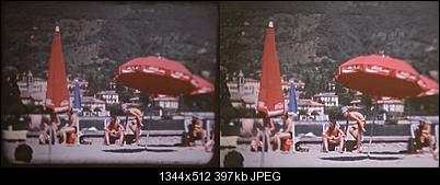

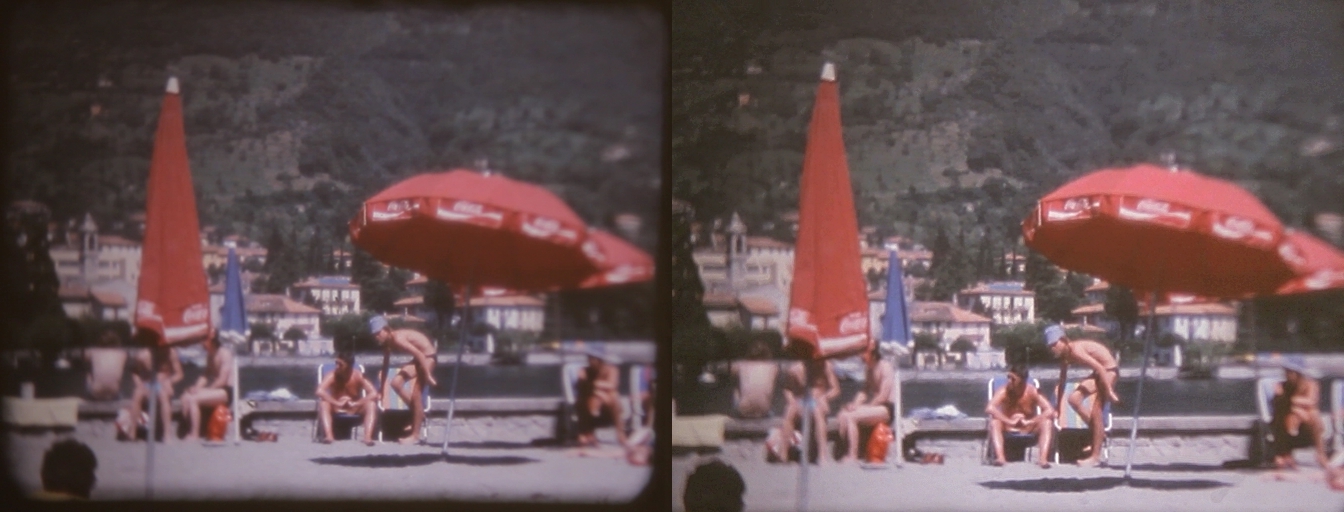

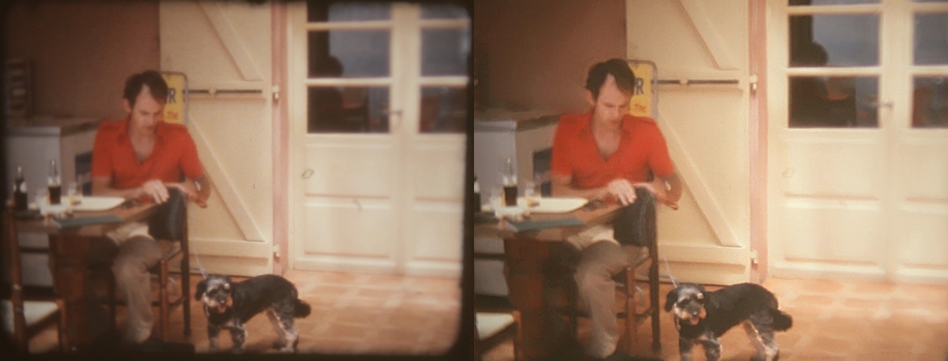

    Hello everyone. My brother filmed some 8mm film of our parents on a paper screen with his DSLR. This was shot at 1080p, 24fps or 30fps. I am now trying to filter these movies to surprise my parents with a semi-restored movie. I was really inspired by Freddy van der Putte's 'Power of Avisynth', and brought together filters in an Avisynth script to make the film a little bit better watchable.
    Below are two examples of the original (left) and filtered outcome (right).

    I do not expect magic, like Freddy did, but of course want to come somewhat close
    I would like to stabilize these videos, enhance the contrast and colors, and get rid of some hairs and spots. I do not need to get super clean results, as I think some 8mm film effects has its charm.
    I am not so happy with my result, as
    1. there is some ghosting induced,
    2. I still have lots of hairs and big spots visible,
    3. and I loose more detail then I would love.
    I have been tweaking the parameters quite a lot, but this is the best result I could get so far. I am wondering if people here could kindly advice me with their experience, to get an even better result? Many thanks!!

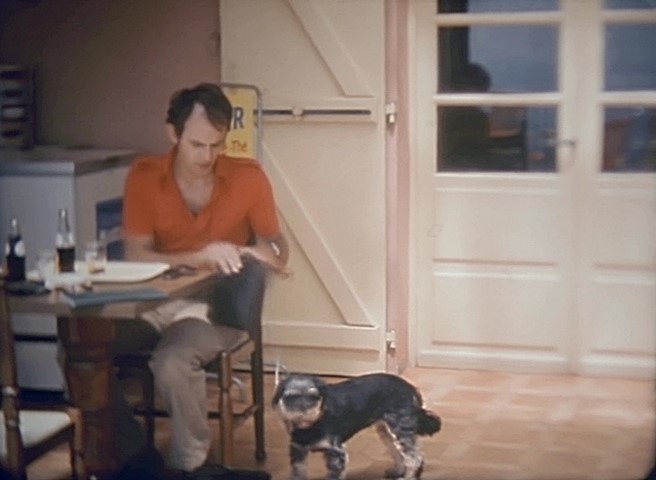

  5. I was able to recover something pretty close to a real frame-accurate transfer. I then put that through my version of VideoFred's script. Here is a still shot of the result:
    Here is the video:
    https://dl.dropboxusercontent.com/u/1561578/Restored.avi
    And here is the script I used:

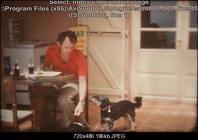

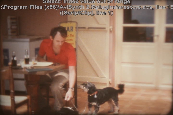

    2. How does one prevent the out of bounds error messages to appear on the exported video (as in your export it did not)? Like
    3. Also, the script works here, accept for the denoising, my version of avisynth does not recognize the 'sup1' command (error "I don't know what sup1 means"). How can I fix this?
    Actually, mine did as well, I just cut out the frames where it happened. I already addressed this in my previous post: you'll have to consult an "SRestore guru" over at doom9.org, or will have to first do a slight decimation of the source, using TFM/TDecimate to remove a few of the duplicate frames so the decimation in SRestore isn't quite as high. I actually looked through the SRestore script to find out where the out of bounds error is happening. I then experimented with lower decimation values (you control this via the frate parameter). If you increase frate a little, the problem goes away, but you also end up still having some blended or duplicate frames, and having those will ruin your chances of getting good results with VideoFred's script.
