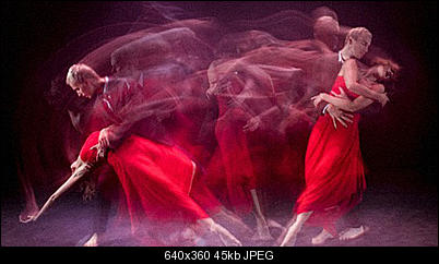

    I can't seem to find an answer or a solution - here's what i need to do:
    Big screen shows a live video from a camera and i need to create about 25 frames of fading ghosting (i.e if somebody moves in the scene a fading ghost trail of him will be left behind for a second). Anybody here can suggest what hardware or software i need to use to get that kind of effect. Sorry if the question really has a simple answer, i'm new to live video.
    See the image to better get my idea:Click image for larger version

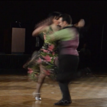

    Here is an example of a simple frame-delay overlay that I did in AVISynth (IIRC, =8 successive frames):
    Note, it doesn't have quite the same SMEAR as the OP's - you can see each individual frame's contribution, even though it was shot at 60p. This would lead me to agree with MaverickTse's assessment.

  10. Yes, I agree that example is not a single simple delay or offset - but not because of the "streaks". It's the timing of the frame accumulation that indicates this.
    As the pair move off to either side (you can choose either), the most recent "echo" should be the next most distinct (next highest in opacity) if the falloff were linear. However, there other images earlier in the sequence temporally that have higher opacity. This suggests at least some compositing was done
    OP wasn't clear if he wanted something exactly like that (much harder to do in live, realtime), or if a simple offset would suffice

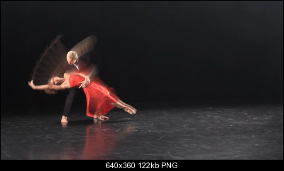

  17. Looks nice Maverick
    There are probably several ways to do it something like this avisynth. This example combines a 16frame delay accumulation with a 8frame delay. Another overlay is put on top as the currentframe acting as the "leading" frame , otherwise the acuumulated frames tend to blend in too much - It's role is simliar to the flash used for the real thing. So 2 overlays are used, and it's slower to process. This method uses ClipBlend from StainlessS (external avisynth plugin) , but there are other ways
    You should be able to get realtime with avisynth with a single staggered layer on a decent system, but if you composite multiple layers, motion blurs, add other effects, etc... you won't get real time. I think you should be able to use the ffdshow avisynth box , perhaps with a live feed in graphstudio to apply the avisynth filters
    Overlay() is inefficient speedwise in avisynth compared to mt_merge(), but layer blending options are more limited with masktools. There are a few user made masktools functions that offer modes like "lighten", "screen", etc... but they have problems with YUV and chroma handling

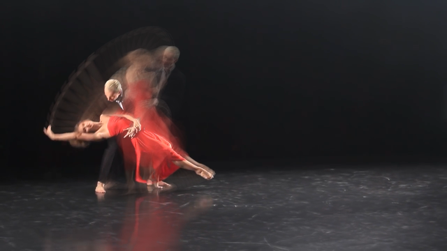

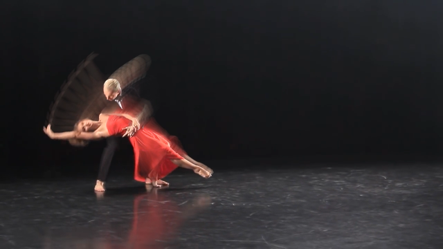

    1) eg. preview of single 8 frame

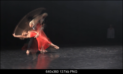

    2) 8+16 (you can see the 8 frame "echo" of the female dancer's hand, combined with the longer 16 frame "echo". This is a composite of sorts like the original example pic, because there is an older "echo" that has higher opacity, except done with video)

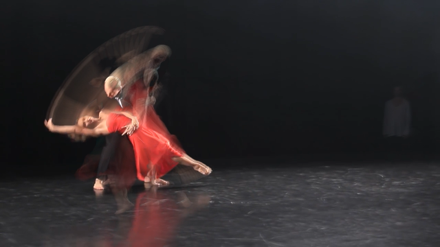

    3) Another way to get "smoother" trails, instead of "discrete echos" from frames is to interpolate the frame range using mvtools. You're essentially cramming in more frames per unit time, so the trails are more contiguous. This one combines 8+16 as above with 2 interpolated versions. Notice there is a background dude in the white shirt (obviously you'd crop that out), but that's an "echo" from an earlier time range from the interpolated version. Another method is you could probably apply some motion blurs to smooth out echos

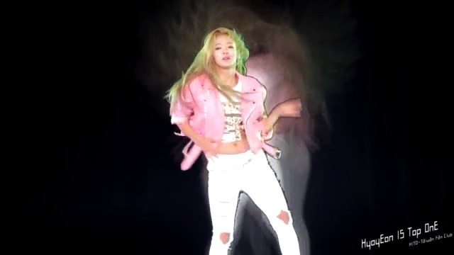

  20. My video didn't have a light accumulation problem. The video I started with (downloaded from Youtube) was already blown out.
    Source:

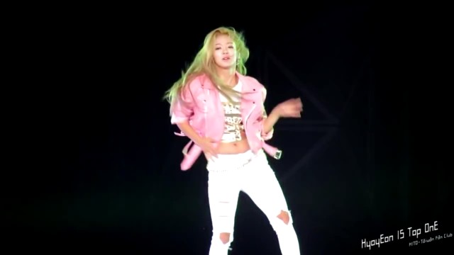

    Processed:
