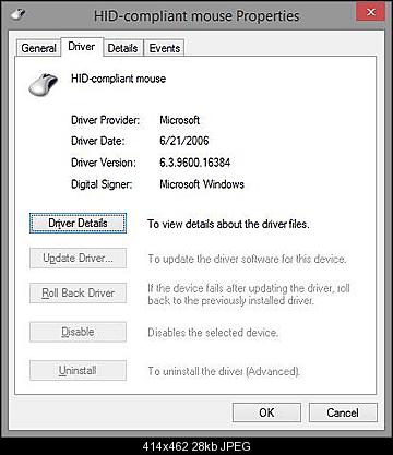

    Did you use the software provided by Toshiba's mouse? I don't normally load RF mouse software, I let the OS figure it out. But I haven't used a Toshiba mouse, mostly use Logitech and they haven't disappeared or power saved. I use a half dozen RF USB mouses with no problems.
    So first place to check is your Control Panel. See if there is a separate item for the Toshiba mouse. If so, check those settings. If not, in Control Panel>Mouse>Hardware>Properties for the generic Windows mouse drivers. See what driver your mouse is using. All mine use the MS mouse USB driver. If you are using a Toshiba mouse driver, maybe the problem.

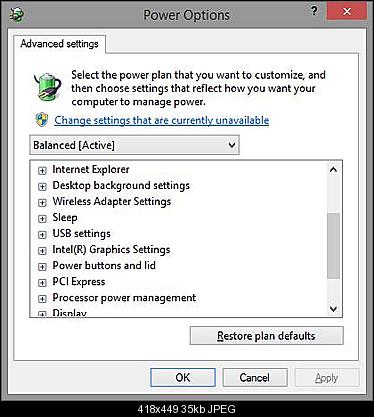

    Second place to check is also the Control Panel>Power Options>Change Plan Settings>Change Advanced Plan Settings. It may be one of those settings, though Windows doesn't normally mess up USB mouse settings.

    But I would suspect either a driver problem or a power management problem.
