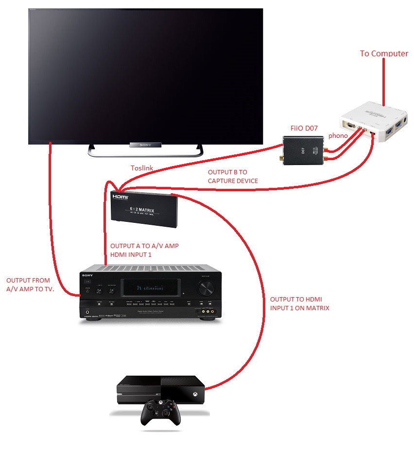

    I have the MicomSoft XCAPTURE-1 USB3 capture device for capturing Wii U, XBOX 360 and XBOX ONE game play sessions, due to no capture devices on the market supporting multichannel (5.1, 7.1 etc) audio capture over HDMI i had to find a solution to be able to play my games in multichannel 5.1 whilst being able to capture all the game audio channels.
    I was experiencing missing audio channels (mainly vocal audio) when i had my consoles set to 5.1 and trying to capture, this is how i found out about no capture devices being able to capture 5.1 over HDMI, i found this a real pain as if i wanted to get correct audio over my captures (no missing channels, ie vocals) then i would have to set my consoles to output 2 channel stereo and who wants to play games in stereo in 2014 when you have a capable 7.1 av amp at your disposal.
    So i came across the FiiO D07 Digital to Analog device,
    http://www.fiio.com.cn/products/index.aspx?ID=100000039443512&MenuID=105026003
    which allows me to enable 5.1 audio on my consoles whilst still getting all audio channels on my captures, this device will downmix the audio to 2 channel and thus sending a 2 channel audio signal to my capture device. My actual capture set up is....
    TV
    A/V AMP
    6x2 HDMI Matrix ('HDMI output A' to my AMP and then to TV and 'HDMI Output B' to my Capture Deivce)
    Consoles
    Im now noticing that im getting approx 500m/s of audio lag since using the FiiO D07 device, im not sure if this is the D07 causing the lag or because im using digital (HDMI) for the video and analog (phono connections) for the audio?. I dont get audio sync issues when im using Digital (HDMI) for BOTH video and audio however.
    Is there a setting in AmaRec that can bring forward the audio at all?. I should note that im using the latest version of AmaRec 3.10c.....or though i notice that on the AmaRec site they dont even have the latest version and are still displaying 2.31c!!?

    Yeah i can do that in avisynth (AvsPmod) but ideally i need to know the excat delay as at the moment im just guessing. Is there a program that can analyse the capture file and actually compare the video to the audio to give me that info. I know VirtualDub can get file info but doesnt support avi file types
