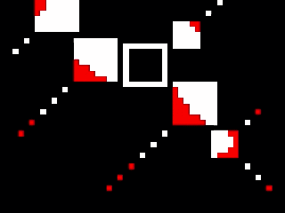

    So what i would like to know is how to make Vegas to not render rounded/blurred/ pixels, heres an example:
    Sample of original image before render:
    Sample of rendered video:
    Ive tried MainConcept AVC and Sony AVC; Best/Preview/Project Properties quality settings; 20 000 000 bitrate for 1080p render; image sequences have disabled resample; Motion Blur Type in Project Settings set to Gaussian/Box/Pyramid.
    Ideas?

    The problem is you used Pan/Crop to zoom way in on small details. You can't do that without creating extreme pixelation. It's like you amplify a car radio to 1000 watts and it just shreds it.
    You need to study up on pixel resolution as it pertains to enlargements.

  12. For the white pixels, to retain sharp pixel edges / pixel art look, you need to use "nearest neighbor" (aka "point") resizing algorithm when doing enlargements or resizing . I don't think vegas has control over that
    The colored pixels, like red, are more difficult to keep the pixel art look - if you use 4:2:0, they can loose their sharpness from chroma subsampling (e.g. when you were using AVC sony or mainconcept), regardless of the resizing algorithm used. For colored pixels , you need to use RGB or YUV 4:4:4 (unsubsampled chroma)

  14. eg.
    Here is a 1:1 crop of one of the source files
    4x enlargement using "bicubic", this is similar to what vegas uses at default
    Same thing, but with "nearest neighbor"
    "nearest neighbor", but converted to 4:2:0 (and back to RGB for the PNG), notice the red eyes are less crisp
    If I'm not mistaken, he wants to retain the pixel art / DOS emulation look

  17. Rather than zooming into small images start with large images. Ie, upscale your sources with a point resize filter (or other sharp resizing filter) first. Then shrink/zoom/pan those images.

    Clarify what you mean by "overlapping frames" during camera movement. Did you mean duplicate frames ? If so, they look to be the result of your panning and your source framerate. You would need to clean up and retime the keyframes and/or redo the source animation at 50. (notice the image source runs at 25, but your project runs at 50. This means there are points in the camera animation where there will be duplicates)
    If you mean some of the pixels shift or grow (in some frames a single "dot" is 1 wide, in others it might "grow" to 2).
    You would need to quantize or constrain the animation and scaling factor by even multiples, as well as quantize the animation of camera and/or scaling. This will obviously make the animation more jerky. It's the way "nearest neighbor" works - you can only do it "perfectly" by even multiples 2x, 4x. You don't have subpixel scaling and interpolation with "nearest neighbor" - it snaps to full pixels. (e.g. 1.75 pixels would "snap" to 2). With other interpolation kernals you might get intermediate "shades" of grey to help with representation, but that means more blurry edges as you saw before with bicubic. Another possible way around this is to redo the animation as a vector image (e.g. SVG, AI, EPS, etc...). Vectors can scale infinitely without losing sharpness
