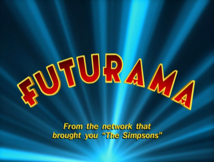

I think I did it right this time. My output is a perfect looking 23.976fps progressive video in the right aspect ratio without 4% speedup+high pitched audio and ghosting (see attachment).
AVS:
CMD:Code:LoadPlugin("C:\Program Files (x86)\AviSynth 2.5\plugins\masktools2-25.dll") LoadPlugin("C:\Program Files (x86)\AviSynth 2.5\plugins\dgmpgdec158\DGDecode.dll") LoadPlugin("C:\Program Files (x86)\AviSynth 2.5\plugins\decomb\Decomb.dll") Import("C:\Program Files (x86)\AviSynth 2.5\plugins\QTGMC-3.32.avsi") MPEG2Source("D:\tst\title03_track1_eng.d2v") QTGMC( Preset="Slower" ) SRestore(frate=25) Crop(12,6,-10,-6)
TSMuxer: 25fps to 23.976fpsCode:x264.exe --profile high --preset slower --level 3.1 --crf 16 --tune animation --sar=12:11 --output output.mkv test.avs eac3to.exe t3.ac3 t3n.ac3 -slowdown -192 -keepDialNorm
Thanks for everyones help
