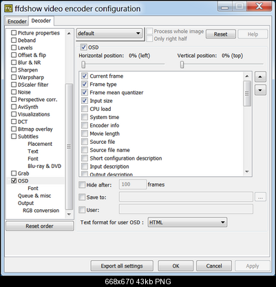

  1. HELLO VH ,
    I saw a screenshot with details [like title , frame no . length , framerate etc] ........ This one http://i1.someimage.com/NH9IH0x.png
    When I asked the sharer , he said "I used ffdshow to take screenshots like it" ........ But I don't understand how to take that type of screenshots with ffdshow !
    Could someone guide me ? PLEASE EXPLAIN HOW TO DO THAT !
    Thank you
    Respect to VH staff & All Helpers !
  2. I got the answer .......
    If anyone needs , may PM me
    Why not post your solution?
    You can enable the ffdshow extra details from ffdshow filter settings and then capture screenshots in for example mpchc.
  4. ffdshow can output statistic to external file also

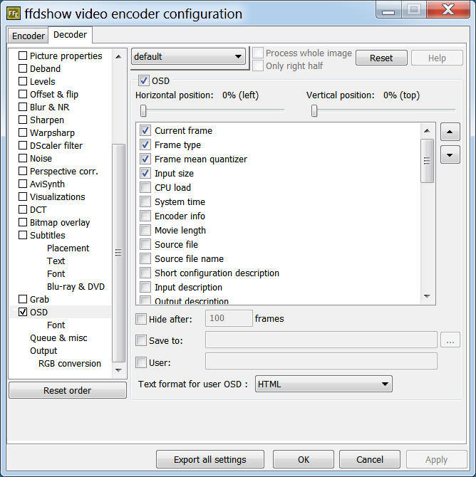

  5. In the configuration dialogs enable the OSD (on screen display) option on the decoder tab. Select what you want to see on the right pane.
