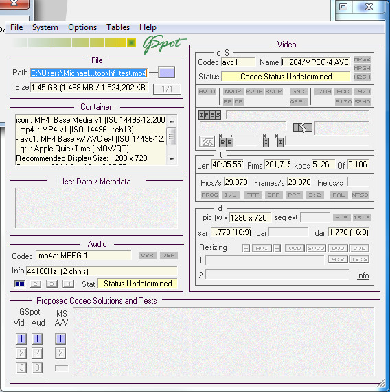

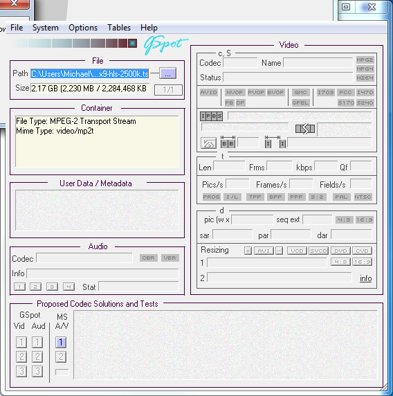

    OK ... so I downloaded gspot and ran it on both the input and output files.
    Again, I am a bit confused ... there is no results for he input file and is says codec status undetermined for the output.
    I have included a screen shot of the the results.
    Do I need to determine more about the input file before I can convert it>
    Thanks for all the help ...... Mike
    PS .... Just as another thought ... the VLC player has a bunch of settings on the conversion end ... I did not change any but maybe I should and try converting it again.
    On video I set it is set to H-264 but I can use mpeg 1, 2 or 4 plus divx and a few others
    On audio it is set to MPEG Audio but I can set it to mp3, mpeg 4 (aac), A52/ac3, or a bunch of others.
    Any suggestions as to what to try?
    Thanks .... Mike

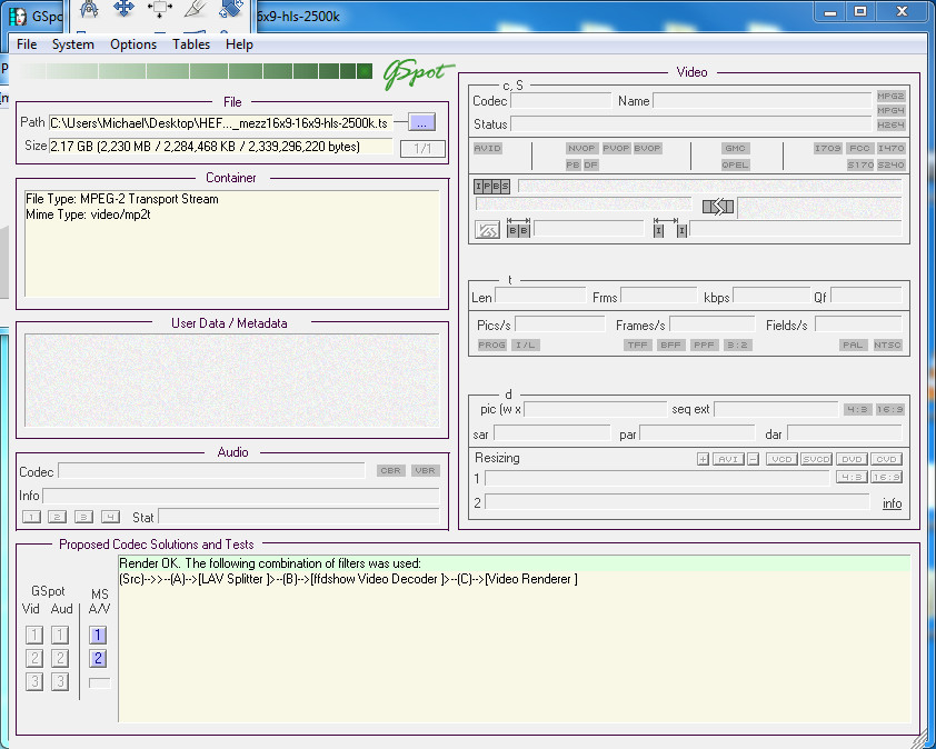

    If you stretch the GSpot window from its fairly small default size, it will be lots easier to see what's being presented and read all the text.
    I just examined one of my own TS files (a 2-hour OTA/ATSC TV show), and it shows the same as yours. It's an MPEG-2 transport stream, and that is all that is shown. No specific audio or video codecs shown, because TS is the formal "wrapper" for MPEG-2... which is itself the codec, which includes both audio and video.
    But down in the bottom of the GSpot window, there is that "proposed codec solutions and tests" area I mentioned earlier. For the TS files the 1/2/3 buttons in both the video and audio columns are grayed out and cannot be pushed. But the 1 button in the MS A/V column is lit up, and you can push it. GSpot will try to invoke what it believes should be able to play the video and audio for the TS file.
    If this works, it will then display "render ok, the following of filters was used" and it will show something on the next line. In my case, since the audio in the TS was DD5.1, the AC3 codec was used for the decoding and that's what appears on the second line data. And now the 2 button in the MS A/V column is lit up.
    When I then push the 2 button, the video with audio starts playing in a small window in the "test" pane, along with the usual PLAY, PAUSE and STOP buttons in the same pane. Audio and video are presented.
    Now as far as your MP4 file out of VLC, I also have an MP4 file of my own (I didn't make it, but it's standard). Here is the GSpot analysis of it.
    Again it demonsrates the inability to play video or audio separately (probably just a weakness of current GGpot) but when the 1 button is pushed in the MS A/V column again that works, and the 2 button lights up. When I then push 2, the same "test" pane appears and the video with audio is again presented.
    Note that for my MP4 file the video codec is shown as H.264/MPEG-4 AVC like yours. Your info shows something relating to Quicktime, whereas mine doesn't, perhaps relating to what/how VLC creates H.264 output on your system.
    But notice that my audio is shown as MP4A: MPEG-4 AAC LC, whereas yours is shown as MP4A: MPEG-1. Your audio is not MP3 as you say was designated as the VLC audio output.
    Note that in my case the primary filter used was "MainConcept (Nikon) MP4 Demultiplexer", which obviously is present on my system. Can't recall if that came from installing the Nikon Viewer software which came with my Nikon digital camera, but I think it did. I also have Windows Media Center operational on this PC, which might explain the Microsoft DTV-DVD Audio Decoder feeding the AC3 Filter to handle the sound.

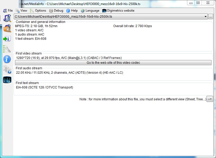

    Just for another perspective, although it doesn't approach things quite the same way as Gspot nor does it provide an actual "player" capability for selecting various alternate codecs or filters that might be available, another very highly regarded Media Utility is named "Mediainfo". Very useful to have.
    And Mediainfo shows internal details to a much deeper degree than GSpot shows. It also allows for a variety of presentations of that info, from high-level summary to in-depth detail in a whole set of different presentation formats (i.e. the VIEW item on the menu bar).
    So, my TS file (which showed pretty much nothing from GSpot) looks like this in BASIC (summary) view from MediaInfo:

    Just FYI ... I just checked this movie using gspot and it says audio codec AC3. video codec ACV1. When I checked it on midiainfo, and hit the "got to player" or "go to website of this video codec". ... both took me to quicktime 7 .
    Not that it matters if I can play it on the windows player ... again I just assumed it was the "standard" but would not AC3 codec have been in the windows player?
    And back to the topic at hand ....
    When I downloaded the streaming video, I used both livestreamer ( gave me a flv file ) and ffmpeg ( gave me a ts file ).
    Using both gspot and mediainfo, the ts and flv files look identical ... same size, avc video stream, acc audio stream, same everything.
