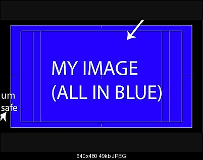

    I have one beginners question for you, since I don't understand how it will my video will look on the tv screen while it will broadcast!
    I made video in adobe after effects, with settings : HDV/HDTV 720 29.97, and I have nice image which is fitted well in the title and action safe area.
    1) I dont understand how video will look if some of users has old type of tv, which is not wide and HDTV?
    2) Since I have background image on my video, I am a little confused about action safe area since, I have image which I want to show in the background but I am scared that it will be maybe cut out when it is broadcasted! So, I decide to resize a background image a little to fit exactly where it is action safe area, but I get black border around, and I know don't know if I do this properly well. Here is the picture:
    What is the best solution to do?
    Thank you very much?

  4. Originally Posted by Lav851 View Post
    It'll play with added black bars above and below to keep the aspect ratio.
  5. Thanks johns0. When the file didn't appear on my desktop I figured it might be smart to issue a provisional warning. Scans here turned up negative.
    To OP:
    In most cases, the image will be letterboxed on an older TV. Other possibilities are squeezed or cropped. It all depends on the the playback device.
    Almost all TVs display beyond action safe, that is why images are generally filmed so that there is picture, but nothing vital, outside of action safe.

  8. Member budwzr's Avatar
    Apr 2007
    City Of Angels
    Modern TV's are 16:9, so they can accomodate any AR. Only 16:9 AR video will completely fill the screen. Anything not 16:9 will be letterboxed or pillared, or both, depending on the pixel aspect ratio.
    Example: On an HDTV, a 640X480 video will be in a small box centered on screen, with black bars on top and bottom.
    To further complicate things, many people use Stretch, Zoom, and Crop on their TVs, and leave it on even if not needed. So in that case anything can happen.
    Bottom Line: Use 16:9 whenever possible, even if you have to put your own black background as a control. Putting a 16:9 black background layer prevents most anomalies.

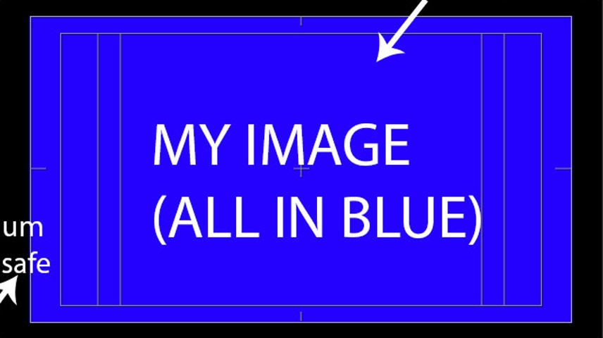

    DAR 16x9 image of 16x9 background panel on a 16x9 HDTV:

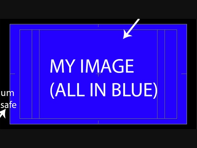

    DAR 16x9 image of 16x9 background panel on a 4:3 SD TV:

    If the entire image is 16x9, not just a 4:3 central image, then 16x9 will be reduced in size and letterboxed on every SD display in the world. As was said earlier, there's no way to fit a wide image into a narrow box without changing the image dimensions.
