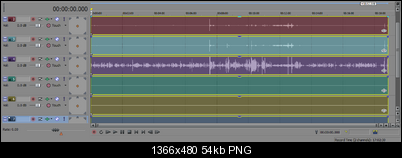

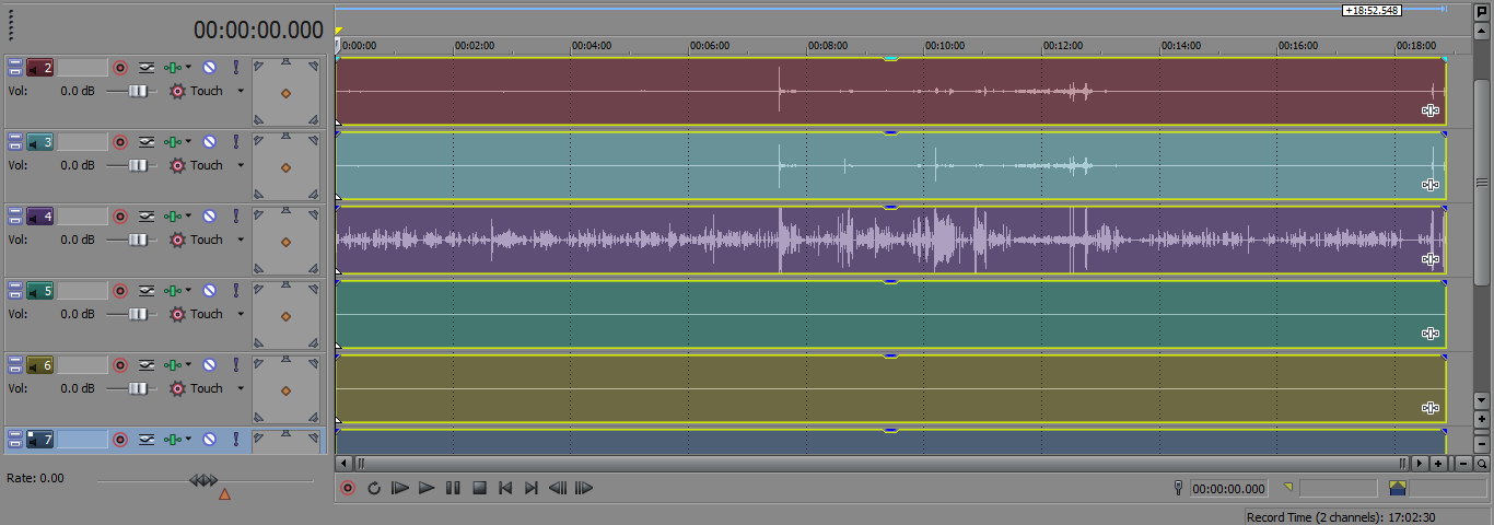

  1. when i import 6 channel ac3 to sony vegas(with video actually) it is panning every channel to the center.Click image for larger version
    my question is: how to see original panning?
    i mean when i import 5.1 audio i want to see original panned audio: for example i want to see: 1st track - left 68%, front 78%, 2nd track - right 28%, front 46% and goes on like this. or is there any software that can show this?
  2. If it's standard 5.1ch audio, I'm pretty sure the way it's being imported is normal (that's the way Audacity does it).
    Different audio formats use different channel ordering. There's a list at the bottom of this page. http://avisynth.nl/index.php/GetChannel
    Regardless of the original format (channel order), when audio is imported it's usually imported using the channel order for 5.1 WAV, so the order should always be:
    front left, front right, front centre, LFE, rear left, rear right.
    When it's exported, the channel order should be remapped again to match the output format, if need be.
    If you're exporting while downmixing to stereo (or listening to the imported audio as stereo), then you would apply panning. Channel 1 would be 100% left, channel 2 100% right, channels 3 and 4 would be panned centre, channel 5 100% left and channel 6 100% right. To keep the original "balance" between channels the centre channel would need to be reduced by 3dB. Including the LFE channel is optional (it's generally just extra sub frequencies) and the volume of the rear left and right channels is also a bit of personal preference. Anywhere between maximum and -6dB would be normal when downmixing to stereo.
    If you're exporting as 5.1ch audio again, you'd just leave it "as-is" unless you want to change it for some reason.

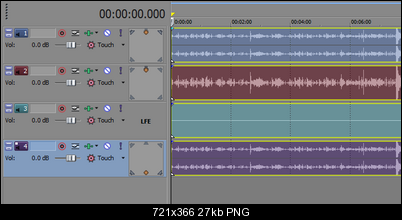

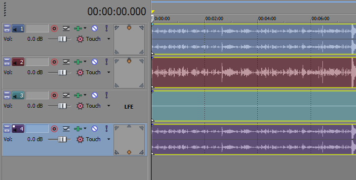

    there is an interesting thing: when i export 6 channel ac3 as WAV and then import it to sony vegas it shows 4 channels and they are mapped like this:
    so there is no way to see original mapping?
  4. I don't know why it imports wave files differently to AC3 (I don't use Vegas) but it's still importing the audio using the same mapping, however instead of importing it as 6 individual channels it's importing the front left and right channels as a single stereo channel and the rear left and right channels as a single stereo channel. The channel order still appears to be the same though, and the channel count is the same, it's just displaying it differently.
    "front left and right", "front centre", "LFE", "rear left and right".
    Even if the original AC3 audio used a different channel mapping, it'd be remapped to the standard 5.1ch wave order when it's imported.
    The program in the zip file in this post called LeeAudBi will open AC3 files and tell you lots of stuff about them, but as I said, the channels will no doubt be re-mapped when the audio is imported anyway.

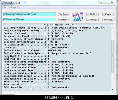

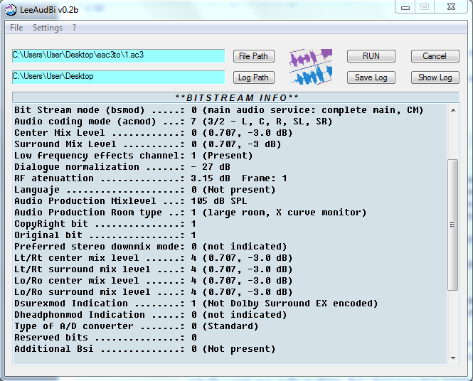

    i had another question: Why different audio formats use different channel ordering? is this really matter? what will happen if i use AC3 channel ordering for WAV audio? by the way LeeAudBi v0.2b STILL DOESN'T SHOW HOW MUCH PERCENT ARE THE CHANNELS "front left and right", "front centre", "rear left and right". Or it shows but i can't see it:Click image for larger version

    AC3 can contain data which a Dolby AC3 decoder can use when decoding the audio. I think it can also contain data which tells the decoder/player how to mix multichannel audio when the output is stereo, in respect to the volumes of the rear/centre channels etc. Not all AC3 audio has it, it doesn't vary much, and I think as a general rule when converting audio while downmixing to stereo it's ignored and a fairly standard formula is used.
    There is no percentage in respect to panning when downmixing to stereo. It's all or nothing. Front left is 100% left, front right is 100% right. Centre is not panned (it's in the middle). LFE is in the middle. Rear left and right are panned 100% left and right.
    Well.....
    The above is true for downmixing to standard stereo, but when downmixing to Dolby Prologic 2, some panning and phase changing of the channels is used, the idea being it can be decoded as surround sound again using Dolby Prologic, but it's nowhere near as good as discreet 5.1ch audio and I've never bothered with it myself. I just downmix to straight stereo.

    Of your 2 Vegas pics, the first one shows the audio imported as 6 individual mono channels, so I assume you'd need to pan the front left and right channels 100% left and 100% right, the rear left/right channels 100% left/right, reduce the centre and LFE channels by 3dB and then export it all as stereo.
    For the second pic the front left and right channels are imported as a stereo channel. The same applies to the rear channels, so they're effectively already panned left and right. You'd just need to reduce the volume of the centre and LFE channels by 3dB and export it as stereo, I assume.....
