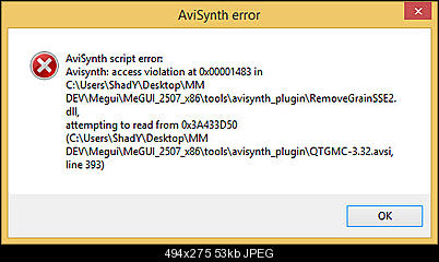

  1. I really need to Know How to use QTGMC Deinterlacing Script On Megui

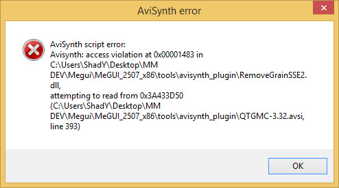

    Error Message
Name:	8-10-2014 - Wednesday 1-07-34 AM.jpg

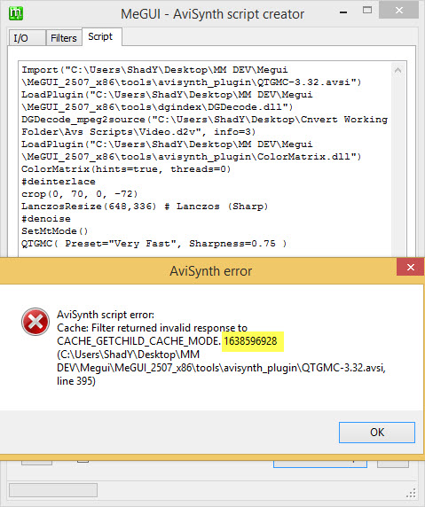

    UPDATED !! For Better verfication

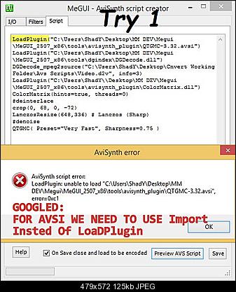

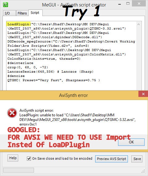

    Guys I was out Sorry for Delay Reply Here Is My Case
Name:	10-10-2014 - Friday 10-59-45 PM.jpg
    So What Should I Do Now

    Aug 2013
    Central Germany
    An "access violation" does not mean that you did anything wrong using it. You are probably using it more or less correctly. But there are reasons why a part of it fails.
    In this case, it only tells us that the RemoveGrainSSE2 plugin tried to read from a part of your RAM which does not belong to an AviSynth clip. So probably something miscalculated where to read the content of a video frame, or how much of it.
    There are some plugins which have some stricter conditions which attributes a video clip must have that they don't fail. Often they expect you to use a certain color space mode (YV12 is common), or width and height being multiples of at least 4.
    Knowing your whole script may be necessary to get a clue which reason may be probable in your case.
    Many filters require image dimensions in multiples of 8 ("mod-8"). RemoveGrain (which is used internally by QTGMC and many other plugins) is definitely one of those filters.
    Encoding standards for digital video frame sizes in DVD/BD/AVCHD are, in case no one noticed, mod-8.
    I'll echo LigH.de -- we need to see your entire script to say for sure.

  5. Originally Posted by LMotlow View Post
    You sure? RemoveGrain seems to happily work with mod2 video for me.
    May 2014
    Memphis TN, US
    Well, sure, a frame can be mod2 and mod8 at the same time. Talking about processing blocks. Docs for RemoveGrain, FFT3D, mvtools, and whatnot talk about working 8x8 and 16x16 blocks. Not certain that's where the access violation booboo message come from. I get it when I just need to shut down VirtualDub and start over. Happens with 16-bit routines in the dither plugin, too.

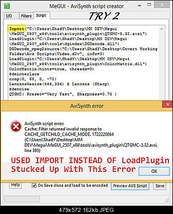

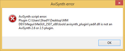

  11. @ arcte, I'm wondering, are you using Windows 8 ?

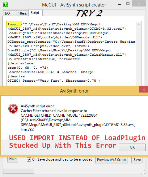

  12. So What Should I Do Now
  13. Originally Posted by _Al_ View Post
    Ya Why so wondering ??
  14. Cache error: try putting SetMtMode() at the start of your script.
  15. I encountered that someone else using this filter, using qtgmc had that problem under win8 as well, where under win7 it was ok
  16. Originally Posted by jagabo View Post
Name:	11-10-2014 - Saturday 10-35-36 AM.jpg
    Again Error But Some Change Of Values In Get Child

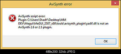

  19. The QTGMC very fast preset uses Yadif for de-interlacing, which I think is the reason for the error in post#12. You'd need to also load yadif.dll.
    I think if you're using the portable Avisynth plus which comes with MeGUI you can load it like a standard plugin, but to be safe, load it before QTGMC in the script like this:
    Load_Stdcall_plugin("C:\Program Files\MeGUI\tools\avisynth_plugin\yadif.dll")
    Do you have Avisynth installed? If you do, you can put all the required plugins in the installed Avisynth plugins folder (not MeGUI's Avisynth plugins folder) and they'll autoload when Avisynth runs. Including QTGMC. If it's got an AVSI enxtension and it's in the avisynth plugins folder, it'll autoload too. The one exception may be Yadif. I'm not sure if you can put it in the Avisynth plugins folder for it to auto-load. You might need to load it manually as above if you're using the QTGMC very fast preset.
    It doesn't matter if MeGUI is using the "installed" Avisynth or it's portable version, plugins in the "installed" Avisynth plugins folder will still autoload when Avisynth runs.
    How are you loading the rest of the dlls at the moment? They're appear not to be loaded in your script.
    If all the required plugins are in the Avisynth plugins folder, including QTGMC.avsi, you should be able to use QTGMC by adding nothing more than the following to a script:
    QTGMC()
    Aside from maybe Yadif for the very fast preset, you shouldn't need to manually load plugins in a script.
    There's enough versions of removegrain to make it all confusing, although in theory the version in the QTGMC plugins zip file should work. You could try a different one though. Maybe download RemoveGrain v1.0b and try RemoveGrainS.dll instead of RemoveGrainSSE2.dll http://avisynth.nl/index.php/RemoveGrain

    I think the way yadif is being loaded might not be something MeGUI can live with. Besides, "Load_Stdcall_plugin" is an obsolete, deprecated loading function. Instead of this:
    Load_Stdcall_plugin("C:\.......\QTGMC 32-bit Plugins\Avisynth 32-bit Plugins\yadif.dll")"
    try using the newer load function:
    LoadCplugin("C:\.......\QTGMC 32-bit Plugins\Avisynth 32-bit Plugins\yadif.dll")"
    You could also try using Avisynth and VirtualDuib on their own, since you're having to write most of your own avs scripts anyway. Also, consider that QTGMC never uses yadif except in a special repair mode. Since you're not manually setting that special mode in QTGMC, you don't need yadif to begin with.

  22. Originally Posted by arcte View Post
    [Attachment 27981 - Click to enlarge]
    At the START of your script, not just before QTGMC. At least put it before mpeg2source. I think mpeg2soure requires mode 5 to work properly.
    SetMtMode(5,n) # n is the number threads you want to use, try the number of cores you have
    Imports()
    dgdecode_mpeg2source()
    SetMtMode(2)
    OtherFilters()
