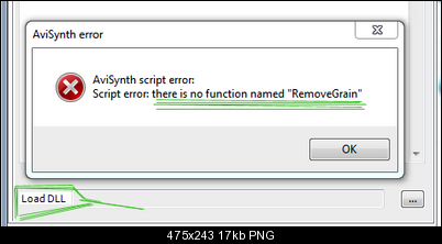

    i've got a problem with scripts in MeGUI, look here
    these scripts works only with "Tweak and Sharpen" look here
    so, i just need to know the right way
    Tahnk you all and greetings

    RemoveGrain is a function not included in the AviSynth kernel, but in a plugin. The most reliable solution would be to explicitly load required plugins in your script (e.g. LoadPlugin or LoadCPlugin, depending on the type) and explicitly import function scripts; but it may as well work if you copy them into the registered plugins directory of AviSynth.

    No, that was just a sample of filters or scripts you know... i need to know the right way of use
  4. Originally Posted by yaston View Post
    You didn't see and/or understand the error message? If you only want to know how to use it what happens when you go:
    RemoveGrain()
    Same thing, right? So maybe there's something more wrong than just incorrect syntax.
  5. Right use of what, he was telling you how to work in general too, if a filter is not a part of avisynth built in function, you need to load them first (without any error). Search for those filters, download them, some dll's or avsi etc., put them into Avisynth plugin folder or preload them in the script where you state where that filter resides on your PC, this is not a Megui's job, but yours.
  6. i did guys, same problem
    would someone show me how in a GIF or VIDEO ? at least screen steps
    May 2014
    Memphis TN, US
    I don't think a video would help, if you don't understand the error message you posted earlier.

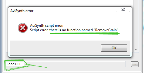

    See, the message means that the avisynth script doesn't know where the RemoveGrain plugin is located in your computer.
    The message has nothing to do with syntax.
    Try entering the plugin dll's location in the "LOAD DLL" entry space shown in the message you posted.
Name:	DLL not found.png
