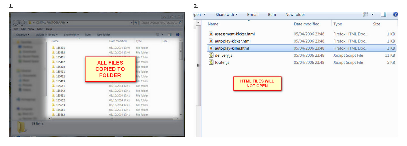

  7. Html files will not run. No compatibility mode option. Want it on a disk to run like cd

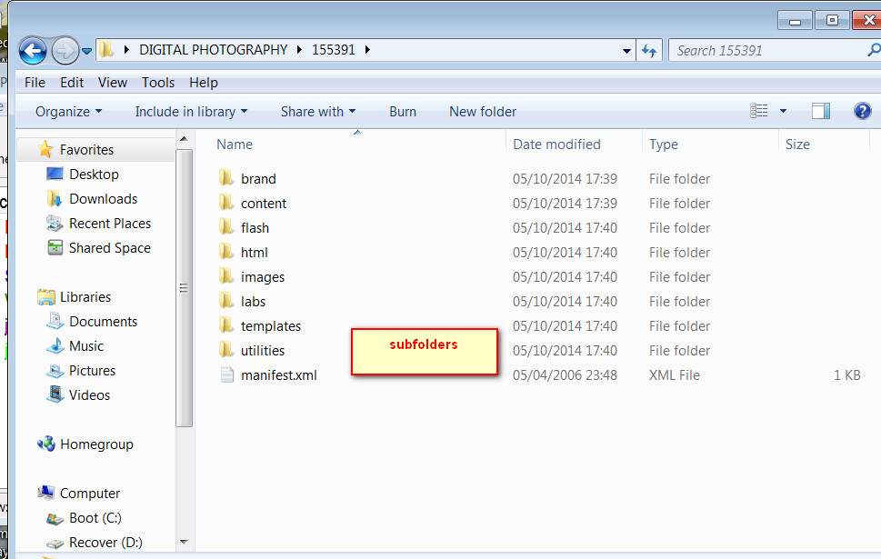

  8. Member DB83's Avatar
    Jul 2007
    Are all the sub-folders copied ? I do not see them in the local HDD list
    It is possible that the html files are expecting the javascript .js files to be at a specific place (possibly to prevent copying.
    There could also be another hidden file on the CD which any executable looks for. Again a copy-protection measure.
    Is there an .exe or .com file on the CD ? Compatability mode is run against the .exe or .com via Windows run.
    edit:
    You can always look at the html files to see where they are looking for the .js

    yes all subfolders are copies, see screenshot
    WriteFlashJar is an exe jar file. There is also java run time and install flash player exe's

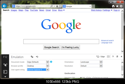

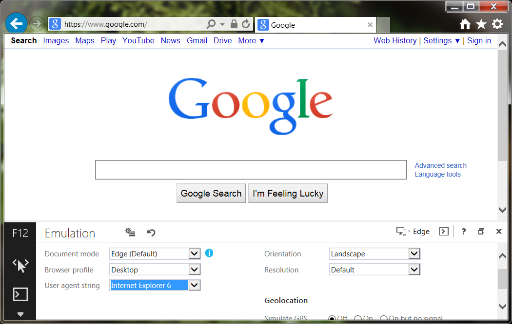

  14. When you open start.html from CD with Internet Explorer, what happens?
    compatibility view need to be enabled for old websites in Internet explorer: http://support.microsoft.com/kb/2536204

  16. i do not see the emulation link in IE. I use FF and do not know IE. It is in compatibility mode
  17. Did you open with IE?

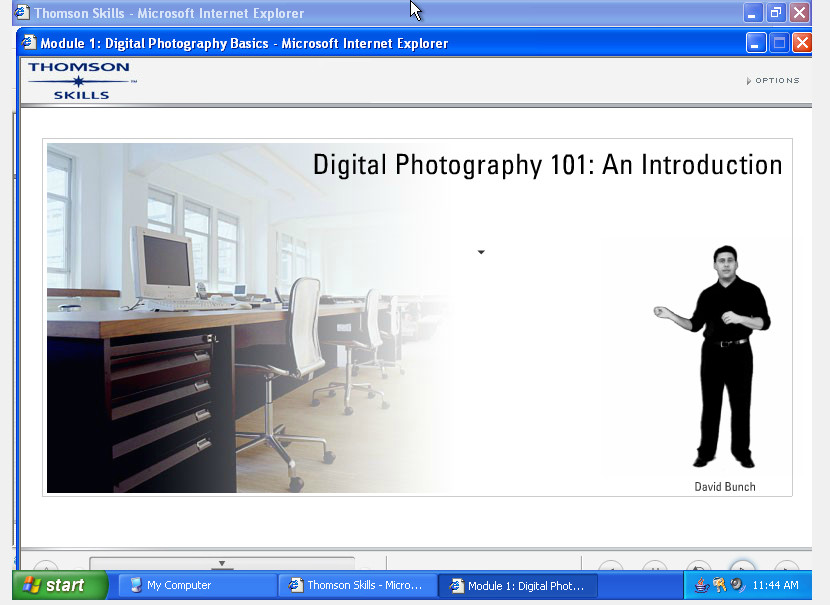

  19. Here it is in virtual box, thanks for help guys
