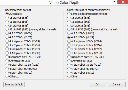

    Order of Converting to YUY2 doesn't matter)
    but seems to me matter when I paragon images with images outputted from edius and totalcode, seems that if I don't put the converttoyuy2 at the top, color are a little in chromaghost

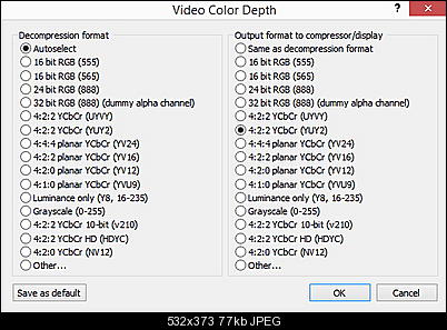

    hoewver virtualdub is set so that

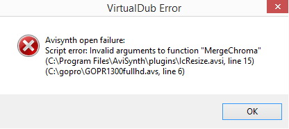

  29. ps. IcResize have a "bug"?
    function icResize(clip "source", int "newwidth", int "newheight", bool "discardhalf")
    discardhalf = default(discardhalf, false)
    src1=source.separatefields()
    src2=discardhalf ? src1.selectevery(4, 0, 3) : src1
    Shift = (src2.GetParity() ? -0.25 : 0.25) * (src2.Height()/Float(newheight/2) - 1.0)
    E = src2.SelectEven() .LanczosResize(NewWidth, NewHeight/2, 0, Shift)

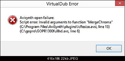

    O = src2.SelectOdd() .LanczosResize(NewWidth, NewHeight/2, 0, -Shift)
    Echr = src2.SelectEven() .LanczosResize(NewWidth, NewHeight/2, 0, 2*Shift)
    Ochr = src2.SelectOdd() .LanczosResize(NewWidth, NewHeight/2, 0, -2*shift)
    dst1=Interleave(E, O)
    dst2=dst1.IsYV12() ? MergeChroma(Interleave(Echr, Ochr)) : dst1
    dst2.Weave()
    in my script don't do problems because source is YUY2, but when it he use YV12 I get:
