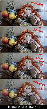

  1. HI, PLEASE FOR **** ONLY, THANKS

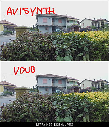

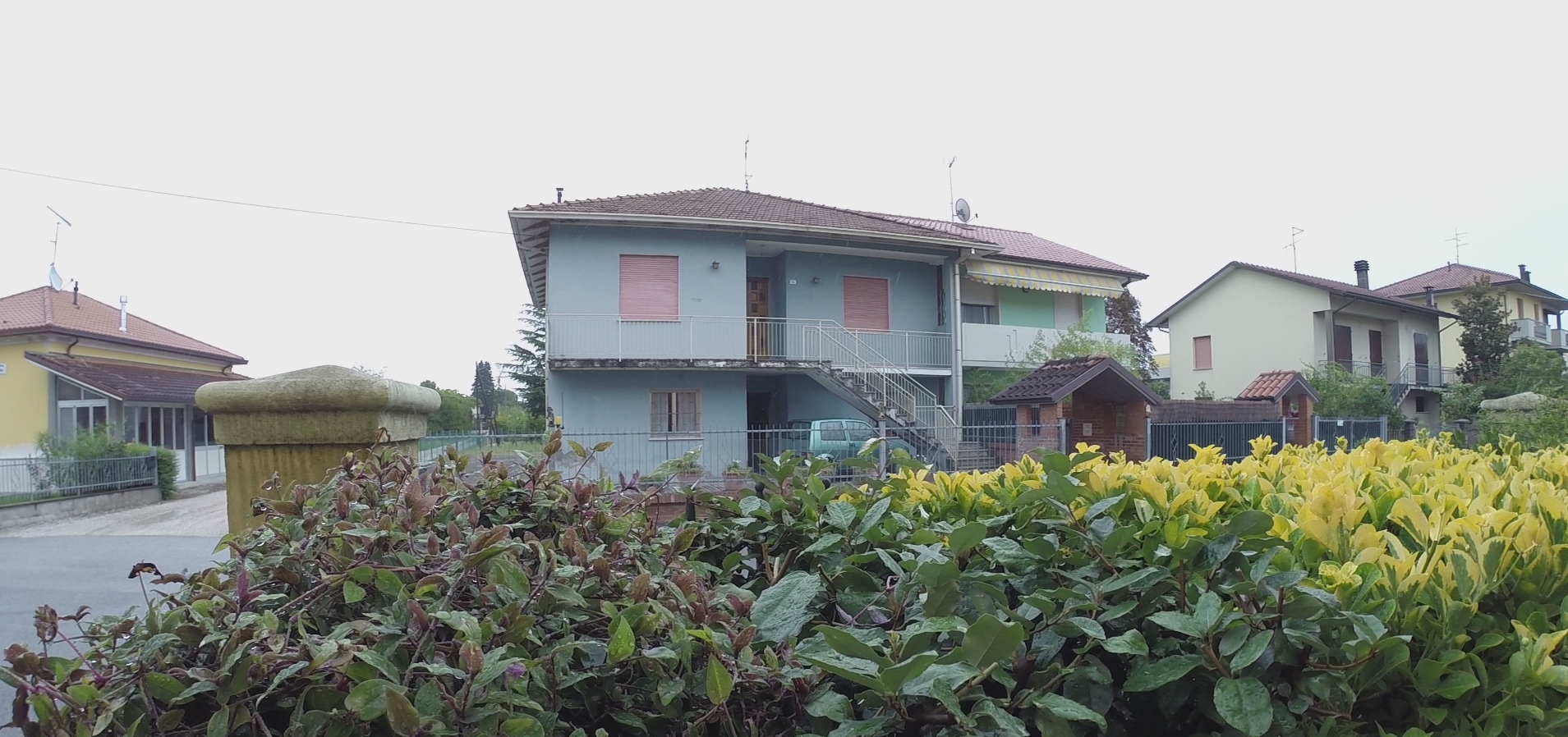

    the same mp4 have different image (contrast? luma? gamma?) when opened, alwais in virtualdub, but one is input avisynth with the ffms2 and one the ffmpeg plugin for virtualdub
    Please ***, can you tell me why? many thanks
    what is the "right" image?
    p.s: if I open the same .mxf (from xdcam camera) both virtualdub and avisynth have identical image

  2. They are the same in your screenshot. Maybe you posted wrong screenshot ?

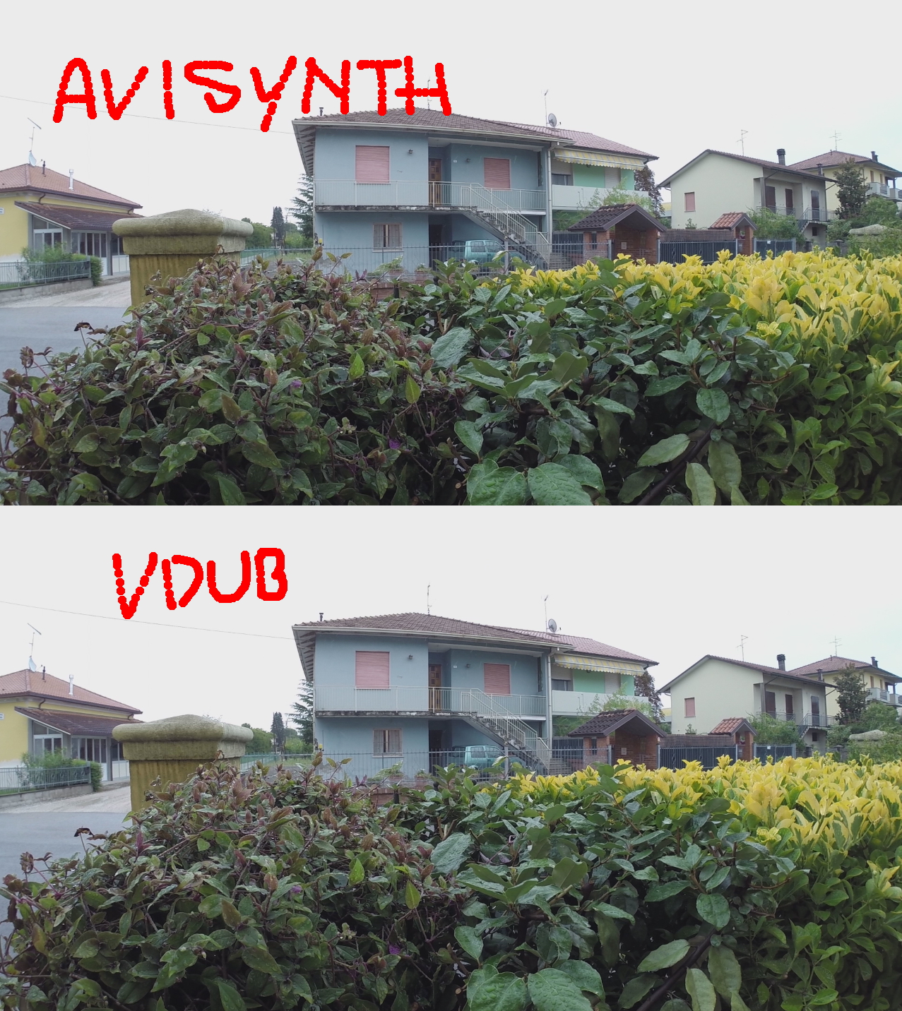

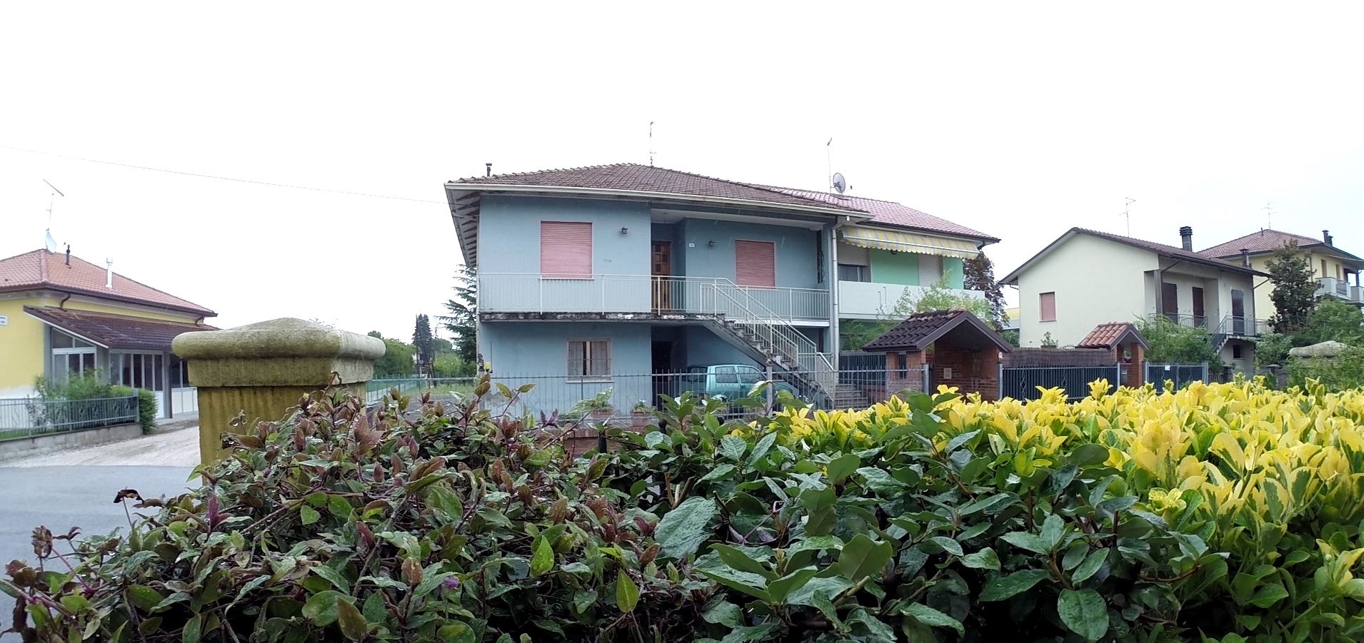

  3. this is avisynth
    an this virtualdub
  4. I suspect your gopro videos probably have a full range flag in the bitstream. Your screenshot taking in vdub is incorrect with avisynth (rec matrix) , probably wrong colors as well (rec601)
    If YUV data is decoded at full range, you need to take screenshots (convert to RGB) at full range
    So probably neither are "correct" in terms of RGB representation

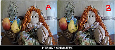

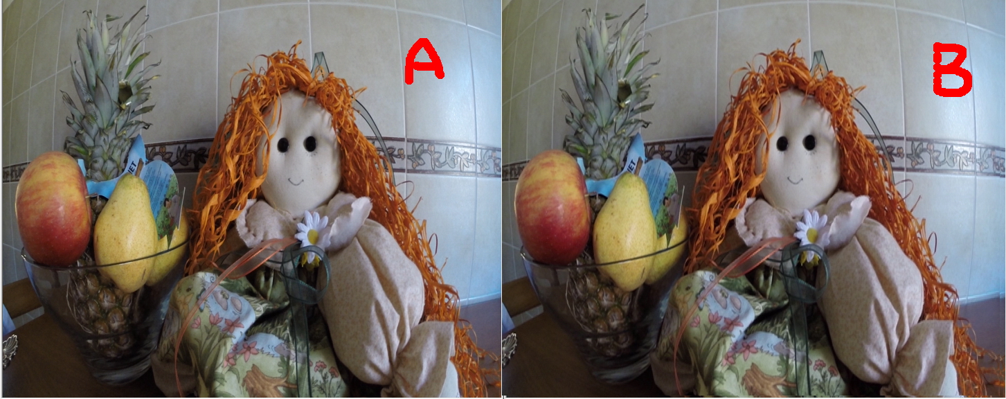

  5. it's the first frame of exported YUY2 uncompressed from the same source GOPR1262.MP4

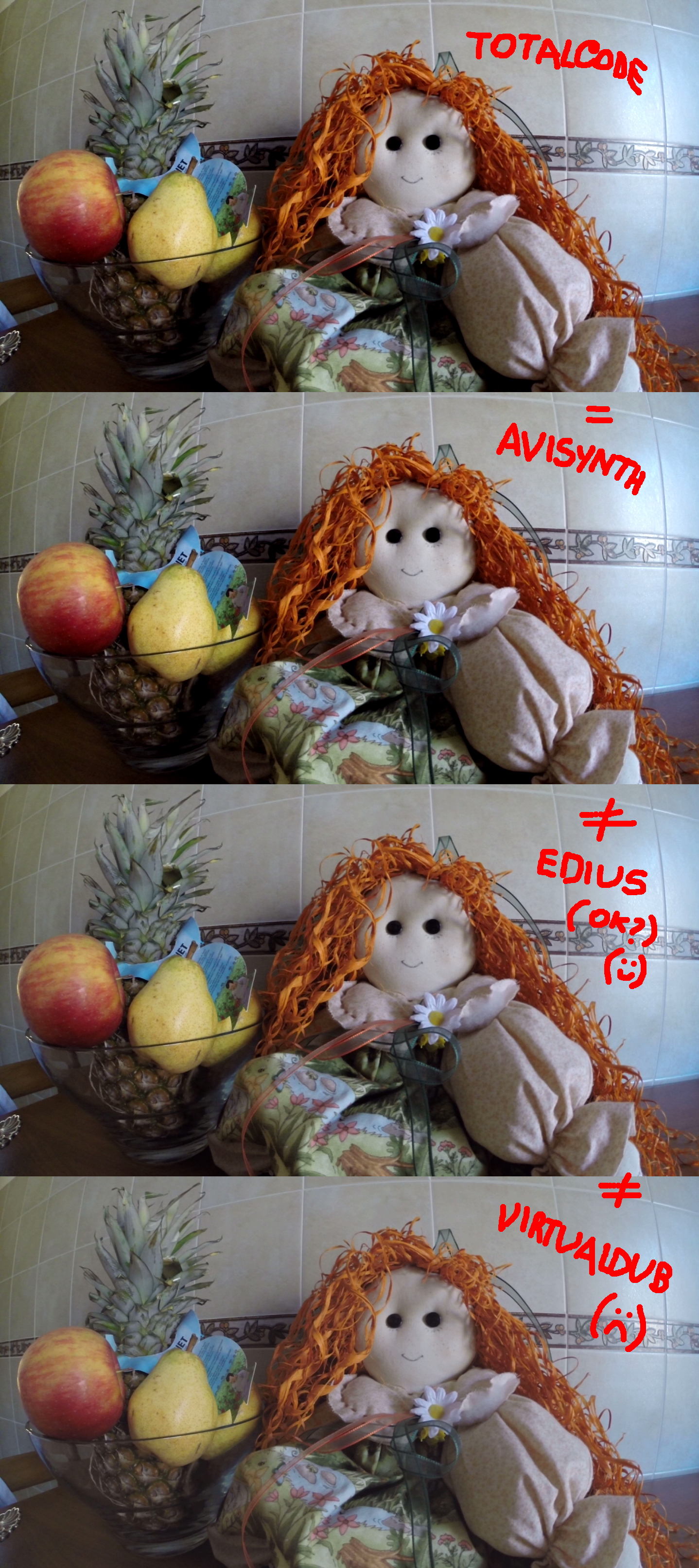

    the same attached .mp4 open with:
    1) totalcode 3.1.0 build 16757
    2) avisynth 2.5.8.6 ffms2 (v?) 21.05.2013
    FFVideoSource("C:\gopro\GOPR1262.MP4")
    ConvertToYUY2(interlaced=false)
    AssumeFPS(50)
    3) Edius 6.01

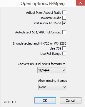

    4) virtualdub for cats (modify by a cat for timecode insertion speedrazor) 1.10.4 FFMpeg plugin 0.8.1.4configured as

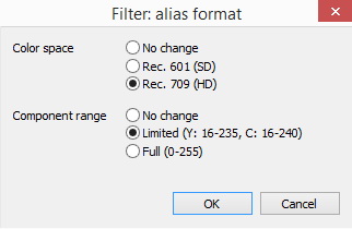

    but seems to me that nothing change also even I try to check the "Autodetect601/709,Full/Limited" checkbox I try to check the "If undetected and H>720 or W>1280" checkbox
    Because gopro cannot (or not?) generate bars, any evaluation is to be done by eye?
    Seems to me that I have cat'eye the "best" is the edius levels-decompressing
    Seems to me: levels of totalcode and avisynth are the same, identical. It's levels are slightly different (in gamma?) from levels of edius, that are also different from levels of virtualdub that are shure wrong
    If I load the same .mxf in totalcode/avisynth/edius/virtualdub: levels are exactly the same.
    So is is more than probable that the matter is as you said, but how can I resolve in virtualdub? ^^

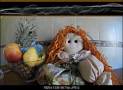

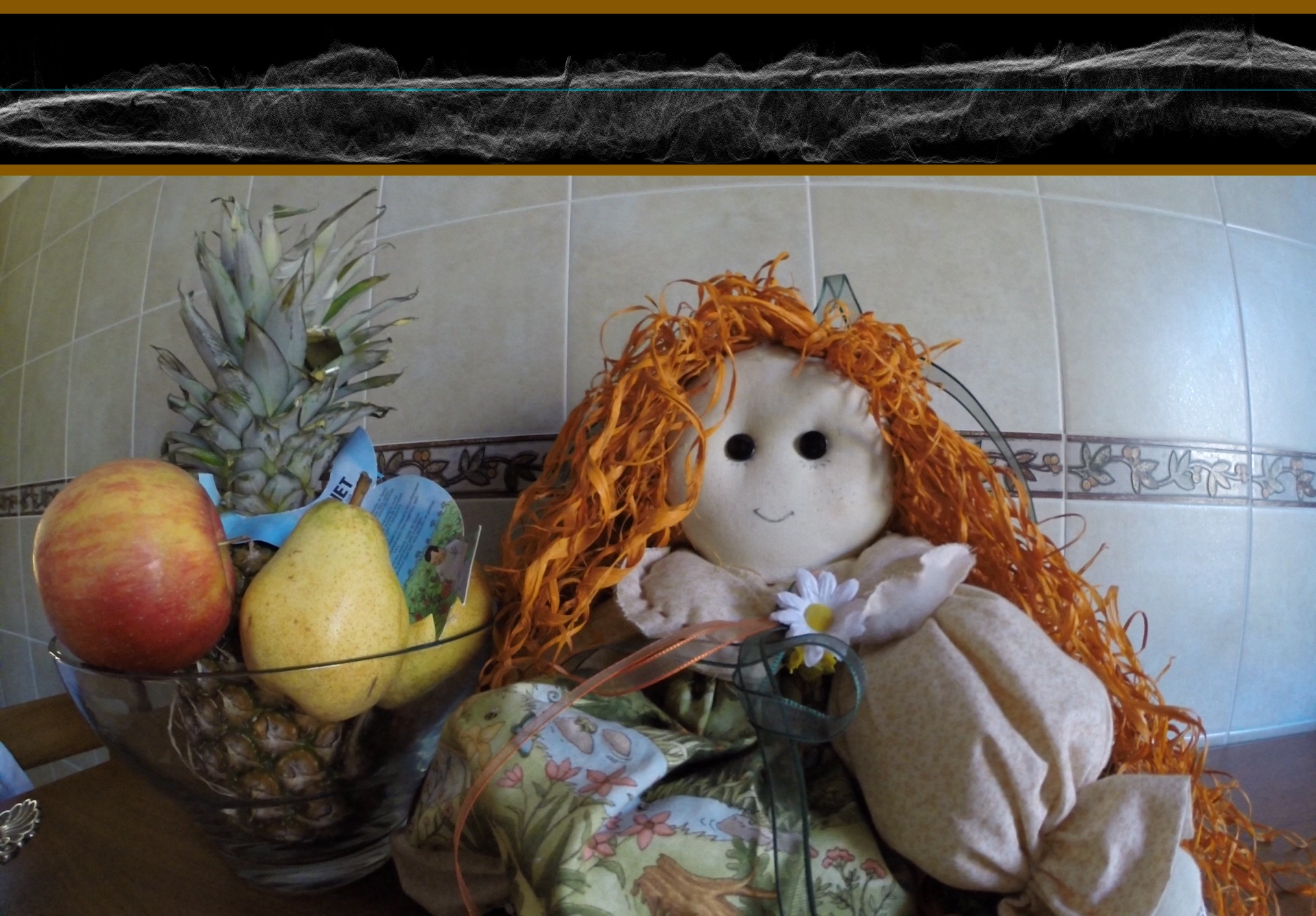

  6. It's as I said above - there is a full range flag
    Decoders and software are inconsistent when handling this, as you can see
    There is no "absolutely correct" way to do it; it depends on your workflow, whether you're working in RGB or YUV - But for broadcast submission, you need legal levels. That is absolute
    So you either need to clamp levels to legal range, or use a decoder that outputs legal range in YUV. If working in RGB (maybe you use vdub RGB filter?), you also need to take that into consideration, otherwise you might clip data, lose data
    For example, ffms2 in avisynth will output full range 0-255 Y' levels. So in order to take proper screenshot or see proper preview in RGB, you must either clamp levels, or use PC Matrix to convert to RGB
    Same with the matrix coefficients, 709 should be used

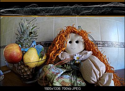

    1st one is incorrect (look at the waveform, there are "illegal" levels , < Y=16), look at the loss in shadow details in the dolls' chest. It's full range YUV, by standard Rec709 matrix is used to take screenshot

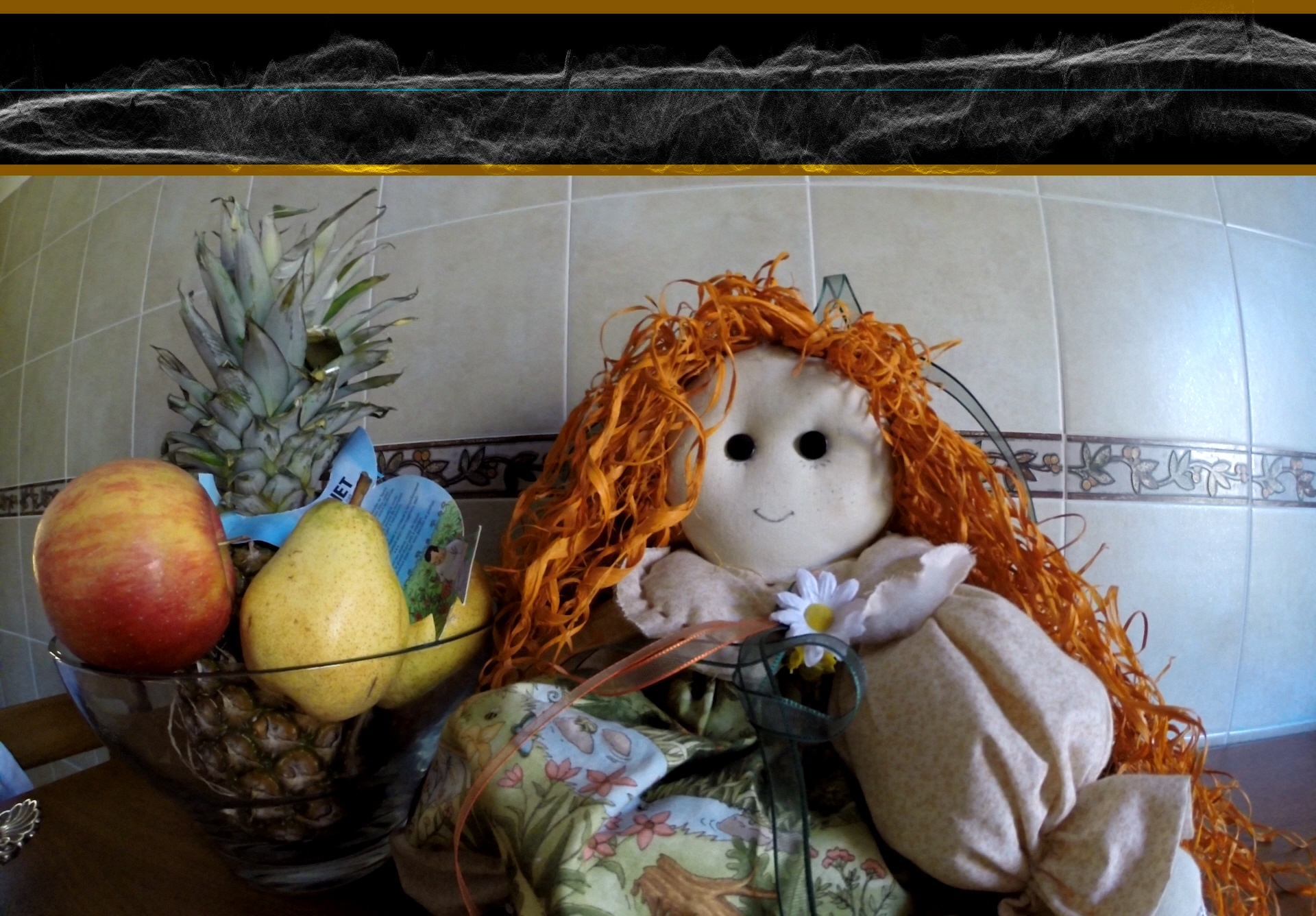

    2nd one is "legalized" (look at shadow details are now visible), but in a "dumb" way . It's clamped, but notice full legal 16-235 dynamic range isn't used (the highlights are brought down compared to the other) . But this is what is normally used, because it's "easy" to do
    But the "optimal" way would be to manually adjust levels per scene

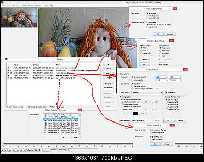

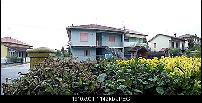

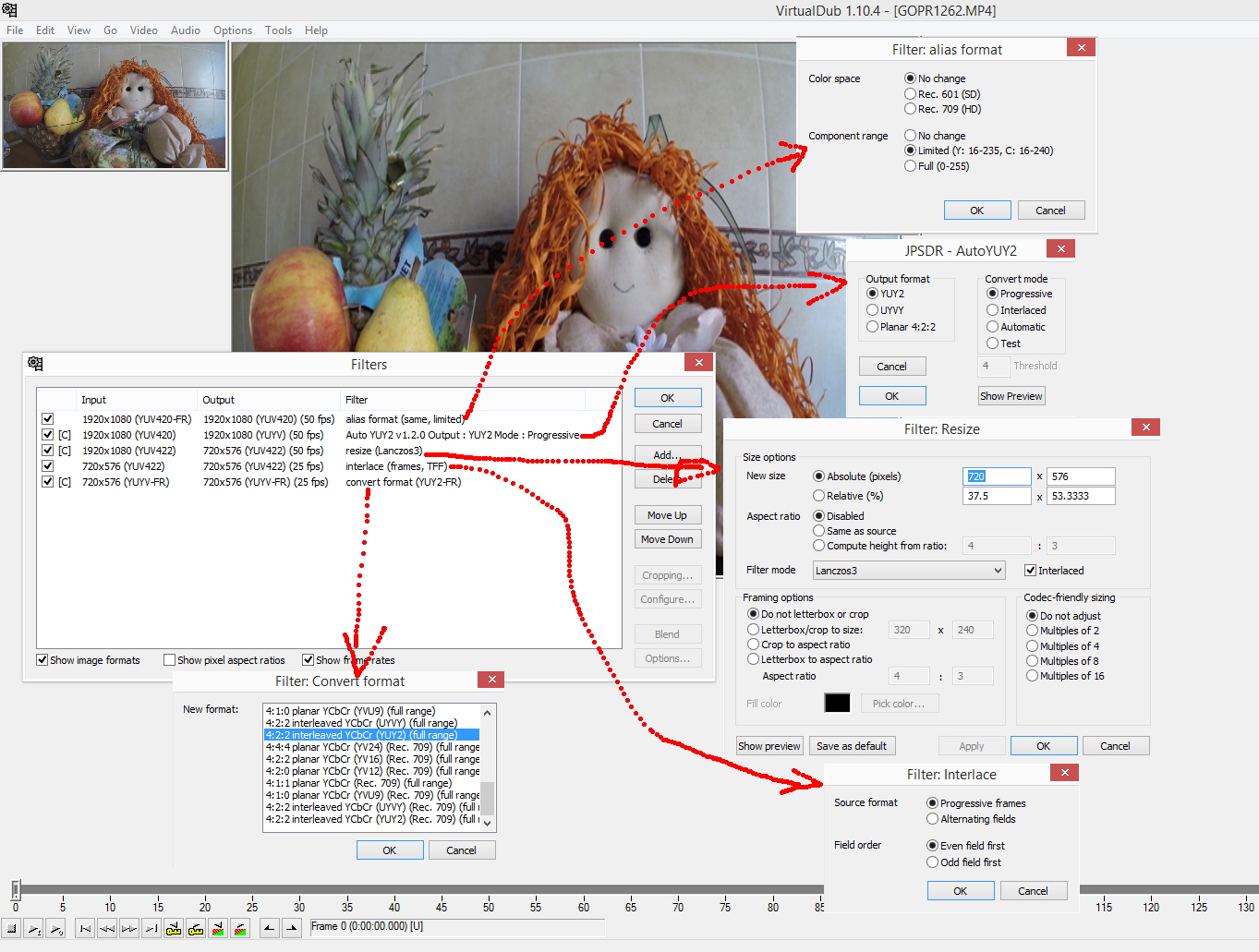

  7. For example:
    no rgb, simply I open that in virtualdub and save-avi
    My workflow is YUV (or I think) no RGB
    Please poison I opened it in virtualdub, with the ffmpeg plugin decoder the GOPR1262.MP4 with the plugin V0.8.1.4 configured as mentioned above
    For now I consider the case I have to resize it into 720x576 so I try this set of filter in virtualdub:
    Thr AutoYUY2 is this as virtuladub plugin:
    https://www.dropbox.com/s/0afcikgz857nn5x/Filtres_JPSDR.vdf?dl=0
    The result seems to me as the edius'one, but think you that procedure is correc?
  8. Check the output file, if levels are legal and shadows weren't clipped, then workflow is probably correct , at least in terms of levels.
    (But there might be other issues)
    For example, if file is progressive (you're resizing before interlacing), then vdub's resize filter probably shouldn't be set to interlaced resizing

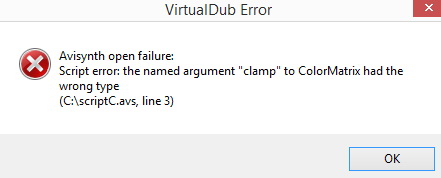

    Now
    C)
    AVISource("GOPR1262withresize720_576.avi")
    ColorMatrix(mode="rec.709->rec.601",clamp=0)
    ConvertToRGB24(matrix="rec601")

    color from scriptA and scriptB are different
    From scriptC I get this
  23. Originally Posted by marcorocchini View Post
    That's all that matters. That's your proof
    If your SD file was correct , they should look the same in terms of colors
    [Attachment 27883 - Click to enlarge]

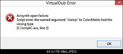

    different versions of colormatrix. Some are clamp=0, some are clamp=false
    It doesn't matter, just take out the clamp argument. This is just a quick check anyway and levels have already been "fixed"
  24. Click image for larger version
    here the color differences seems low but in the broadcast monitor seems that scriptB does not have the rec.709-->rec.601 colormatrix conversion
  25. Originally Posted by poisondeathray View Post
    however if I see weell image output from my script seems that mine have a litlle lower quality of the edius'one
  26. Originally Posted by marcorocchini View Post
    Script B is directly viewing the RGB conversion with 601 matrix. Since it's different than "A" (which is HD file viewed with 709 matrix), that is proof that your SD file is incorrect
    Since script C looks like A (or very similar), that again is more proof, because the colormatrix is 709->601 (as if it had used 601 in the first place)
    Does explanation make sense ?
    We are not looking at quality with these scripts, just quick test comparing if colors are correct (otherwise more care would be taken with the interlaced switches for the colormatrix, rgb conversion)

  28. Since source has full range flag and you use ffvideosource, you need to legalize levels first
    Order of Converting to YUY2 doesn't matter, but it will be very slightly faster at the bottom. (It's still progressive at this point, so interlaced=false, for colormatrix as well)
  29. or, better, please poison considering this gopro file, please can you tell to the cat what is the correct way to do a script that convert to sd?
    considering that source is 50fps progressive and target is 50i, I hipotyze
    ffvideosource(gopro)
    converttoYUY2(interlace=false)
    colormatrix 709->601
    Iresize(720,576)
    but is this the correct sequence for this case?
  30. Originally Posted by marcorocchini View Post
    Iresize(720,576)
    No, because IResize() is filter for interlaced resizing (where source is interlaced). GoPro video is progressive
    Come on , you already know how to re-interlace from 50p . IT was discussed about a dozen times in your threads
    The only difference here, is if you use FFMS2, you need to legalize levels because these GoPro videos have full range flag
