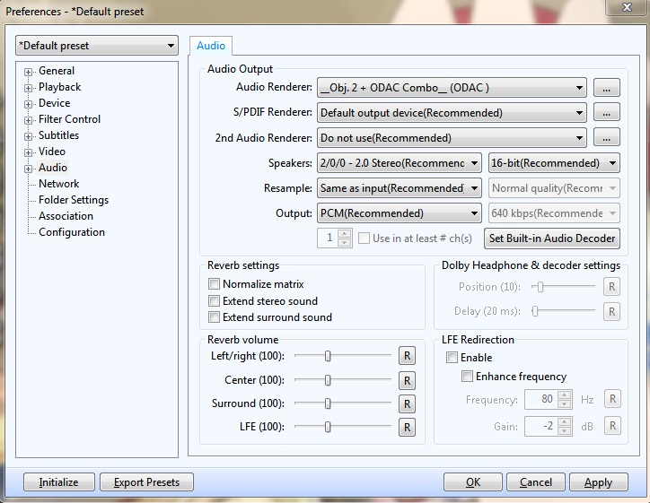

  1. Hello, if possible I would like some clarifications on reverb settings under "audio" in Potplayer as I'm not sure if I need to turn them on or off to "maximize" audio performance.
    Doing a simple good search on "normalize matrix" and "extend stereo/surround sound" didn't help at all and hence why I'm asking here to try my luck. More so, it doesn't help at all when I have little to knowledge regarding to technical terms when dealing with audio...
    I'm currently using a headphone via USB DAC with LAV Audio Decoder and here is the screenshot of the settings:
    To add on, I haven't turned on any other extra settings except for normalizer which I'm currently using "32-bit simple arithmatic" to boost audio level.
    Thanks, help would be appreciated it.

  9. I've got some notes from the dev.
    Matrix Normalization works with every channel including mono or stereo. Sorry for the wrong information. It should not be used in general playback environment.
    "Extend stereo sound" should be "Extend stereo to center". It requires stereo channel at least. "Extend surround sound" should be "Extend stereo to surround" and it only applys to stereo channel. It can be used while upmixing 2ch to multichannel. From the explanations, "extend stereo sound" looks similar to "Voice control" and "extend surround sound" to "Expand Stereo" here: http://www.ac3filter.net/wiki/AC3Filter:Mixer_page
    You don't need to enable both mixer options if your playback environment is stereo and it won't work with stereo speaker setup even when it is enabled.

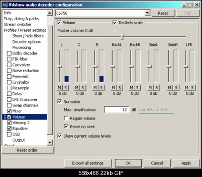

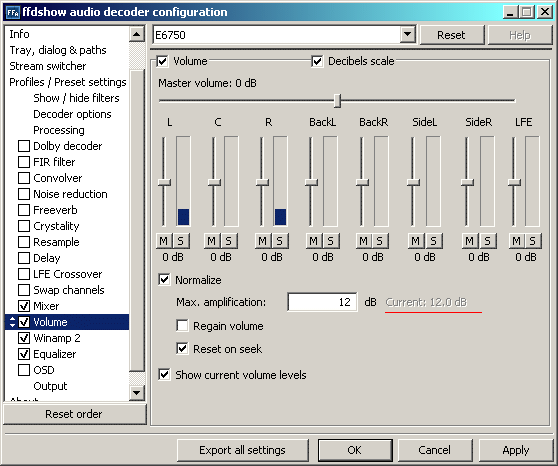

    I use ffdshow's audio decoder myself, which has all the same functionality. I leave the normalise matrix disabled and reduce the master volume by 6dB to prevent (most) clipping. Any clipping which might still occur should be pretty infrequent and not bad enough to be audible.

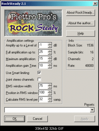

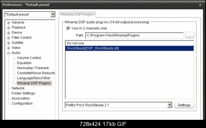

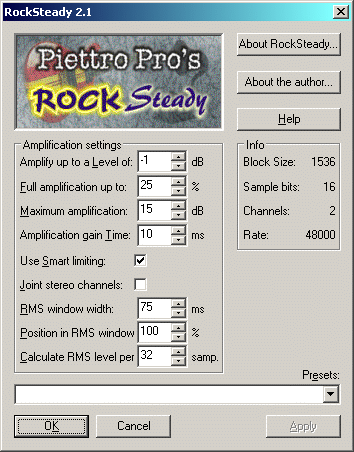

    If you want to "compress" the audio to reduce the dynamics, and want to try a method which doesn't suck as badly as Potplayer's Audio/Normalise/Boost function, you could try the RockSteady Winamp DSP. I use it with ffdshow's Winamp filter but you can load it in Potplayer like this (probably thanks to Potplayer being largely an amalgamation of code taken from other players/decoders):
    These are the settings I use:
    It boosts/levels out the audio nicely without being able to hear the volume being turned up and down all the time as you can with Potplayer's Normalise/Boost function.

    "full amplification up to" and "maximum amplification" are the ones which increase compression. Try something like 33% and 20dB. That should reduce the dynamics a bit more while increasing the likelihood of "pumping", but it mightn't necessarily make the over-all volume a lot louder.
    The way DSPs such as RockSteady work is by increasing the volume of the quieter parts. The louder the audio, the less it gets amplified.... right up to the maximum (0dB) at which point it's not amplified at all. So while you can increase the compression, which might increase the average volume, the maximum volume is still the limit, so to speak.

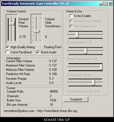

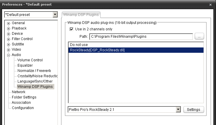

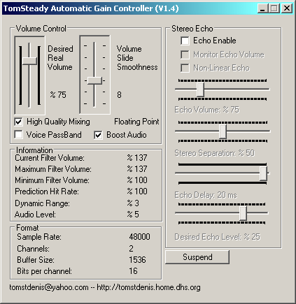

    Given Potplayer seems to be largely an amalgamation of "borrowed" code, I went looking for the normalisation it uses. It seems Potplayer's normalisation was probably a winamp plugin called TomSteady
    I loaded it into Potplayer under the winamp plugins section and it looks like this:
    Maybe you can give it a spin to see if you can get your head around how it works because I'm not sure I have yet. The "smoothness" slider seems to set how long it takes to go from no amplification to maximum. The default seems to be 8 seconds. Other than that I'm still not exactly sure how it works, but TomSteady seems more like a DSP which adjusts the volume control for you, rather than "compress".
    Anyway, try "full amplification up to 33%" and "maximum amplification 20dB" for RockSteady. That seems to get it closer to TomSteady's default volume without too much noticeable pumping (at least for the audio I was testing). I think the idea behind adjusting the volume slowly as TomSteady does is to make any "pumping" less noticeable, so it's all some sort of a compromise.
    This has increased the overall volume a bit but I've noticed quite a few pumping action during playback. Maybe I should revert to your original settings and turn the volume knob on my DAC instead?
    I also played around with TomSteady and... to be honest, I had no idea what I was doing with those slide bars. I'm not sure if the "echo" part was included in the original Potplayer normalizer but it sure did gave different results.
    I made some samples a little while back to compare compression. Spread over a couple of threads. I've attached them below. The idea was to try compressing some fairly dynamic audio. The first half is just speech, the second half gunshots and sirens etc.
    These different compression plugins/programs made me realized that there is no middle ground or "ideal" position for normalization as well as it's a matter of personal preference as well.
    All the above, I think I prefer your set-up at the moment as it was a huge improvement from Potplayer's default normalizer setting.

    TomSteady will continually increase and decrease the volume which will help keep it more constant, but you may be able to hear it working. The other methods might see the volume boosted much more at the beginning than it's boosted by the end, but you won't hear the level going up and down. I guess it's which evil you dislike the least....

    You could maybe try a best of both worlds setup. I don't know if the order of Potplayer's audio options are the order in which they're applied to the audio, but I tried using ffdshow's normalisation in conjunction with RockSteady and it seemed to work. ffdshow lets you change the order of the filters, but it's normalisation works like Potplayer's does. Initially the volume is increased by a set amount and decreased if the peaks exceed maximum, or if you check "regain volume" it's constantly adjusted.
    The following seemed to work well. I enabled the normalise matrix in the mixer filter (which drops the volume a fair bit for multi-channel audio to simulate "quiet" audio), followed it with the volume filter and normalisation enabled, set to boost by a maximum of 12dB, then followed it with the Winamp filer running Rocksteady to compress it (my settings).
    When I put the Volume filter with normalisation enabled after the Winamp filter, it settled down to boosting it by about 4dB, which means my RockSteady settings weren't boosting the peaks to maximum, although not far off it. Anyway, you could try something similar with Potplayer to see if it works (standard normalisation, not TomSteady).
    Or Potpayer has a master volume under the Volume section. You could just boost it there. The trouble is, for louder audio where the peaks are already at maximum, it might distort.

    It might be that left and right aren't being amplified by the same amount at the same time so it sounds like they're switching back and forth. Try checking the "joint stereo channels" option. Other than that, no, it shouldn't make background noises switch channels as such.
    Yep, that fixed the "switching" problem.
