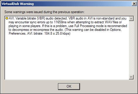

    After opening VDub, I first selected: file=> open video file
    Because initially "append AVI segment" was greyed out until after opening the first video segment. Upon opening the first segment I got the following:

    Jun 2007
    Should I ignore this and continue or do I need to take a different approach?

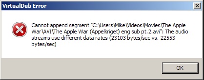

    After opening the first AVI segment, the "Append AVI segment" was no longer greyed out. So I ignored the initial error and tried to Append AVI segment but then got this:

  9. Originally Posted by perceptionist View Post
    Ignore it.
    Did you ignore the warning?

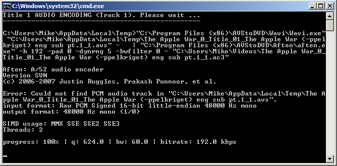

    Ok here's where I'm at so far:
    Using AVS2DVD everything seemed to be going fine although it had an issue with one of the characters in the title which I ignored and the process appeared to continue.
    But then I saw this screen and although it still says "Please Wait"....it has not changed for like 10 minutes. It is the only evidence that this program is even still running (no other interface windows or anything)

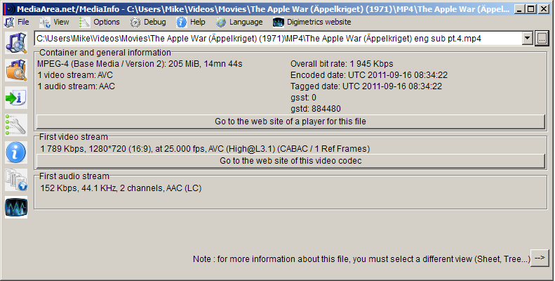

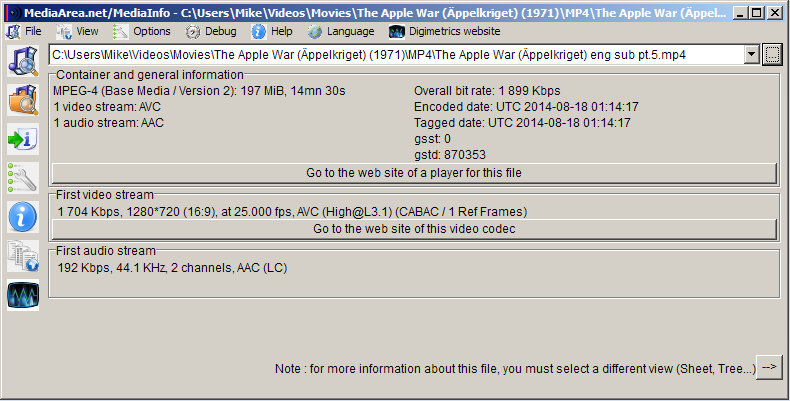

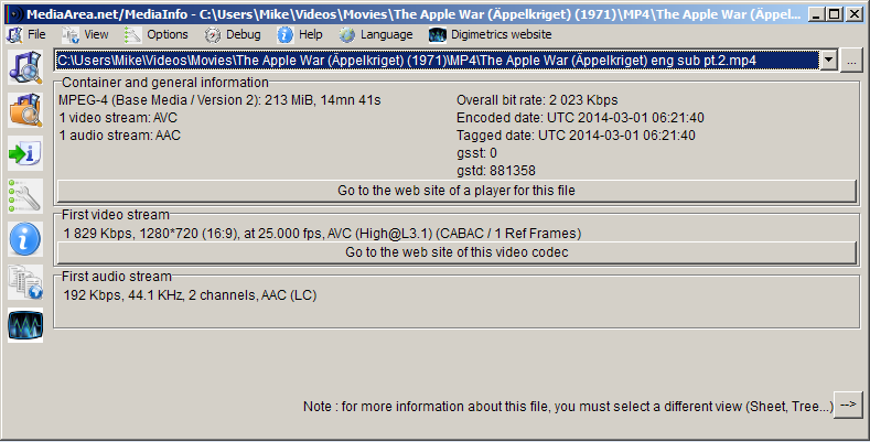

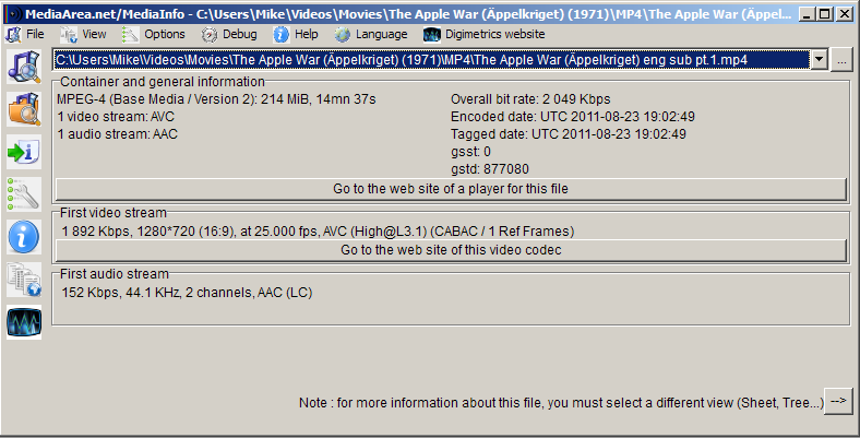

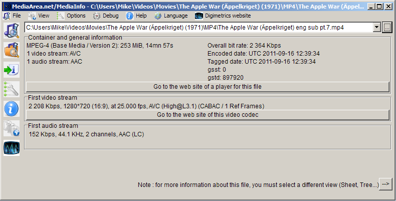

    How about you give us the mediainfo outputs for the files. If your files don't give us anything worthwhile if remuxed with either MP4Box or MKVMerge they will put info in the files that will tell us each streams exact length and MediaInfo will happily tell us the delay as well.
    Jun 2007
    Ok, under "View" should I just stick with "Basic"?
    Be who you are and say what you feel because those who mind don't matter and those who matter don't mind...
  22. Member
    Jun 2007
    Here are the Mediainfo outputs for all 7 of the MP4 files:

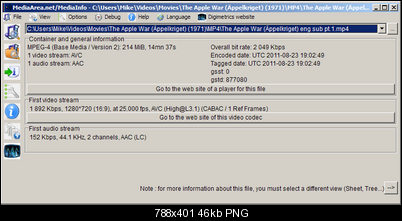

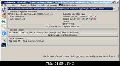

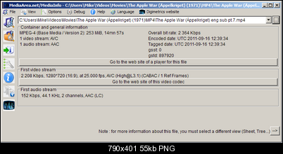

    No, we need the duration and the delay of each stream. If you can't get MediaInfo to display them as is, you'll need to remux the files with either MP4Box or MKVMerge.

    MediaInfo doesn't seem to do MP4 delays, so temporarily muxing the files into MKVs using a recent version of MKVMerge would give us the most information.
