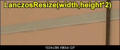

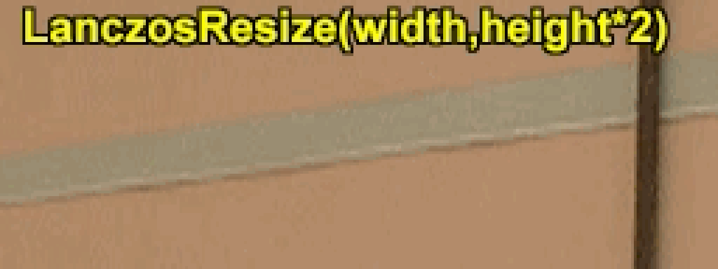

  25. nnedi3(dh=true)
  26. Double High the input=true
  27. Since you missed the point (4x point resize after):
