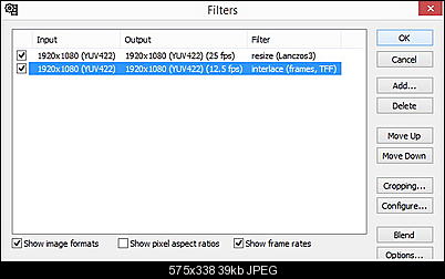

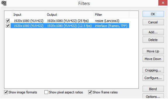

    please can you help me? if I have a source that is SD 25P and I would like to transcode to HD 25 i (interlaced) what is the correct procedure in virtualdub?
    - resize and then interlace?:
    but this way the framrate become 12,5 fps
    OR: what is the correct procedure to do this?
    thanks

  4. Do no filtering. Just encode interlaced. It's a waste of time and will blur the chroma channels. The only reason to do this would be to append the video with other true 25i video.
