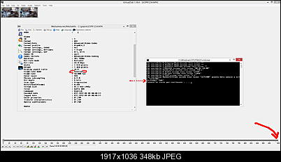

  9. Possibly I would like including the frame count in the main line:
    for /f "tokens=1,2 delims=^=" %%g in ('v:\automazioneclip\virtualdubmod\FFProbe -hide_banner -loglevel fatal -pretty -show_streams -select_streams v:0 -show_entries stream^=codec_type^,r_frame_rate^,width^,height^,sample_aspect_ratio:stream_disposition^=:format_tags^=timecode^,company_name^,product_name^,product_version "%~1" 2^>^&1')
    of the batch script
    but I try to understand: ffprobe mistake the frame count and ffmsindex is right?

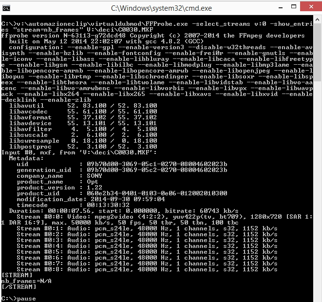

    3: find the line that starts with "nb_frames=" and tell us what is written after the "=" sign.

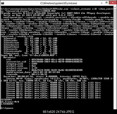

  11. it's this
    Sep 2012
    Australia
    nb_frames=N/A
    FFProbe DOES NOT KNOW how many frames there are in your file, and it won't be able to figure it out without going through the entire file and counting them. You may have a bit more luck with your MP4s, it depends on what was written into the headers by whichever software muxed them, but for the mxf files at least you have no way of knowing how many frames are in the files without indexing them.
    (I'm assuming DirectShowSource and VirtualDub just guess how many frames there are.)

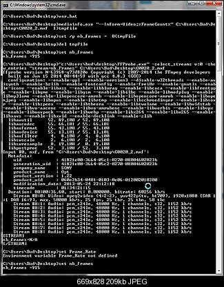

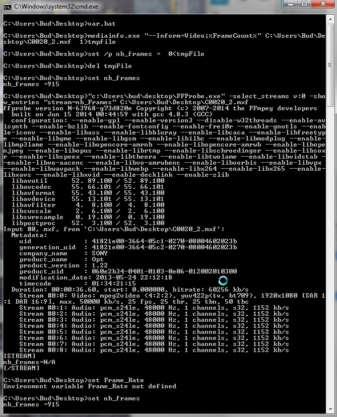

    On marcorocchini's note, the following script head start will give you what you want for FrameCount, just need to do it each time.
    This calls MediaInfo CLI and inserts it back into your script/batch:
    mediainfo.exe "--Inform=Video;%%FrameCount%%" C:\Users\Bud\Desktop\C0020_2.mxf > tmpfile
    set /p nb_frames = < tmpFile
    del tmpFile
    set nb_frames
    "c:\Users\bud\desktop\FFProbe.exe" -select_streams v:0 -show_entries "stream=nb_Frames" C:\Users\Bud\Desktop\C0020_2.mxf
    set nb_frames
    YIELDS:

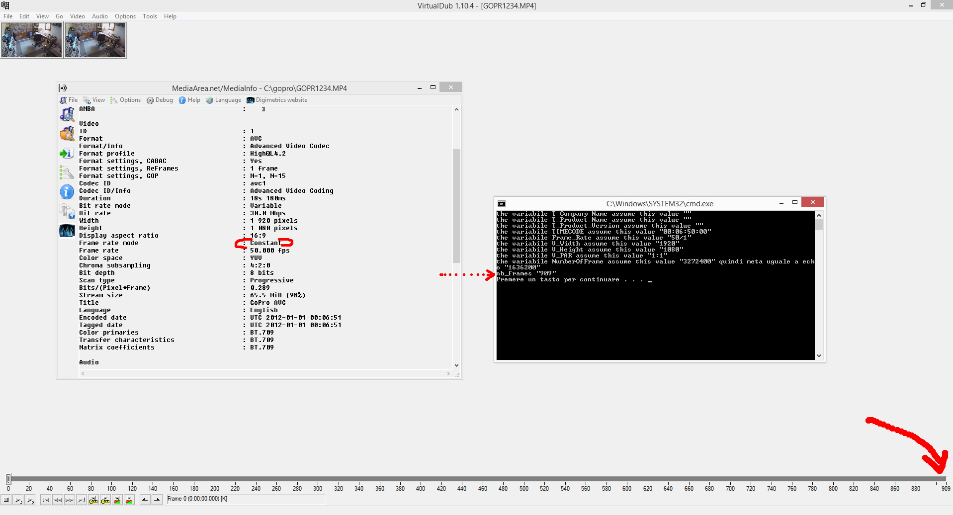

  16. sorry I have a lot of confusion in my head of cat and I can not understand anything
    to stay on the safe side - for the moment - this script "count" "frames number" (or something that) only in .mxf file: this seems don't mistake. And let to the "generic" routine of avisynth all the rest (that, however process correctly only 25 or 50 fps)
    FFProbe acts on all files input and drag&dropped
    for /f "tokens=1,2 delims=^=" %%g in ('v:\automazioneclip\virtualdub\FFProbe -hide_banner -loglevel fatal -pretty -select_streams v:0 -show_streams "%~1"') DO (
    but only .mxf files (and only the .mxf 50 fps) are filtered to have been processed by virtualdub, using mediainfo
    v:\automazioneclip\virtualdub\mediainfo.exe "%CD%\%~n1.mxf" dumpinfo:unicodefile.txt
            TYPE unicodefile.txt>mediainfo.txt
            findstr /c:"Codec ID                                 : 0D01030102020201-0401020202010200" "mediainfo.txt"
            IF NOT ERRORLEVEL 1 (set
    But for .mp4 files I have noted that this procedure cannot work because this frames count is wrong, when I have more time to devote to this thing I try to solve the problem if I can. if someone finds a better solution I thank him ^^

    Try it to my GOPR1234.mp4:
    it seems work weel (but it's strange! in a previous proof I read in virtualdub 811 frames and now opening the same .mp4 virtualdub show 909 ?!?)

    	rem #### Find TimeCode Info ####
    	Set AUCount=0;
    	Set VDCount=0;
    	Set STCount=0;
    	set "V_Number_Of_Frames="
    pause
    	for /f "tokens=1,2 delims=^=" %%g in ('v:\automazioneclip\virtualdub\FFProbe -hide_banner -loglevel fatal -pretty -show_format -show_streams "%~f1" 2^>^&1') pause DO (
    		if "%%~g"=="[/STREAM]" set "CType="
    		if "%%~g"=="[FORMAT]" set "CType=FORMAT"
    		if "%%~g"=="codec_type" (
    			if "%%~h"=="audio" set /a AUCount+=1
    			if "%%~h"=="video" Set /a VDCount+=1
    			if "%%~h"=="subtitle" Set /a STCount+=1
    			set "CType=%%~h"
    		if "%CType%"=="FORMAT" (
    			if "%%~g"=="TAG:company_name" set "T_Company_Name=%%~h"
    			if "%%~g"=="TAG:product_name" set "T_Product_Name=%%~h"
    			if "%%~g"=="TAG:product_version" set "T_Product_Version=%%~h"
    			if "%%~g"=="TAG:timecode" set "TIMECODE=%%~h"
    		if "%CType%=="video" (
    			if VDCount GTR 1 (
    				echo Multiple Video Streams!!!!
    				pause
    			if "%%~g"=="time_base" set "V_Time_Base=%%~h"
    			if "%%~g"=="r_frame_rate" set "V_Frame_Rate=%%~h"
    			if "%%~g"=="duration_ts" set "V_Duration=%%~h"
    			if "%%~g"=="width" set "V_Width=%%~h"
    			if "%%~g"=="height" set "V_Height=%%~h"
    			if "%%~g"=="sample_aspect_ratio" set "V_PAR=%%~h"
    			if "%%~g"=="nb_frames" if NOT "%%~h"=="N/A" set "V_Number_Of_Frames=%%~h"
    	for /F "tokens=1,2 delims=/" %%g in ("%V_Time_Base%") do (
    		set "V_Time_Base_Denom=%%~g"
            set /a "V_Time_Base_Num=%%~h*10000"
    	for /F "tokens=1,2 delims=/" %%g in ("%V_Frame_Rate%") do (
    		set /a "V_Frame_Rate_Num=%%~g*10000"
    		set "V_Frame_Rate_Denom=%%~h"
    	echo %V_Duration% / ((%V_Time_Base_Num%/%V_Time_Base_Denom%)/(%V_Frame_Rate_Num%/%V_Frame_Rate_Denom%))
    	if "%V_Number_Of_Frames%"=="" Set /a "V_Number_Of_Frames=V_Duration/((V_Time_Base_Num/V_Time_Base_Denom)/(V_Frame_Rate_Num/V_Frame_Rate_Denom))"
    	set "FPSforVirtualdub=V_Number_Of_Frames%"
    	echo "%FPSforVirtualdub%"
    it arrive at the first "pause" --> so until here is "ok"
    but it don't arrive at the second "pause": is there a problem processing the line
  28. "v:\automazioneclip\virtualdub\FFProbe" shouldn't there be a .exe at the end on Windows?
  29. Code:
