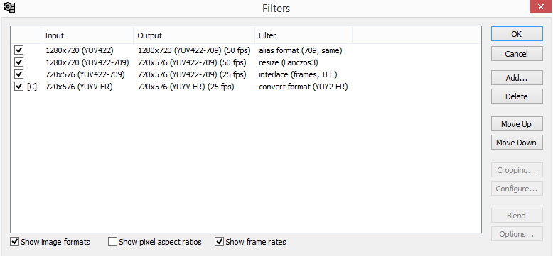

  1. Hi cats,
    please can you tell the complete set of filter in virtualdub to reduce a video of my *** from 50P to a 25i (interlaced)
    thanks!!
  2. sorry, I missed this:
    I have to resize from HD to 720x576. But the source is progressive, so have I to apply the deinterlace filter before the resize? and in the resize: have I to check the box "interlaced" or leave it empty?
    So the correct sequence is:
    resize
    interlace
    interlace

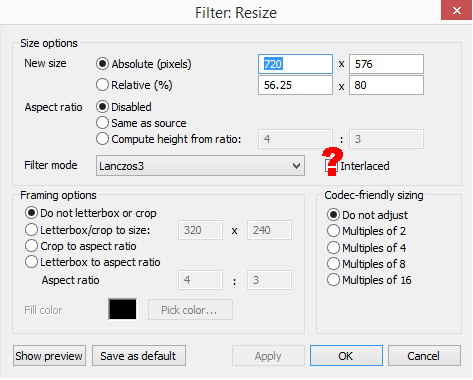

  3. If your source is progressive just resize it then apply the interlace filter.
  4. ahn, thnaks
    and the "interlaced" flag have to be checked?
    consider my target is 25i, interlaced Click image for larger version
    This is the source, the video of my cat !!!

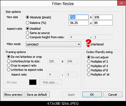

  5. https://www.dropbox.com/s/va74tph4qlk0p3o/C0014.MXF?dl=0
    this is my brother shooted @ 1920x1080: as the gopro, its strange but out of 1920x1080 I see aliasing in details of image
    In the video 1280x720 I see some artifacts in details that in the 1920x1080 ones I don't see: this alwais in the original .mxf files so I think the problem of aliasing is already present in the original 1280x720 file
    Seems that the "interlaced" flag of the resize, reduce the bad aliasing

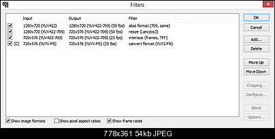

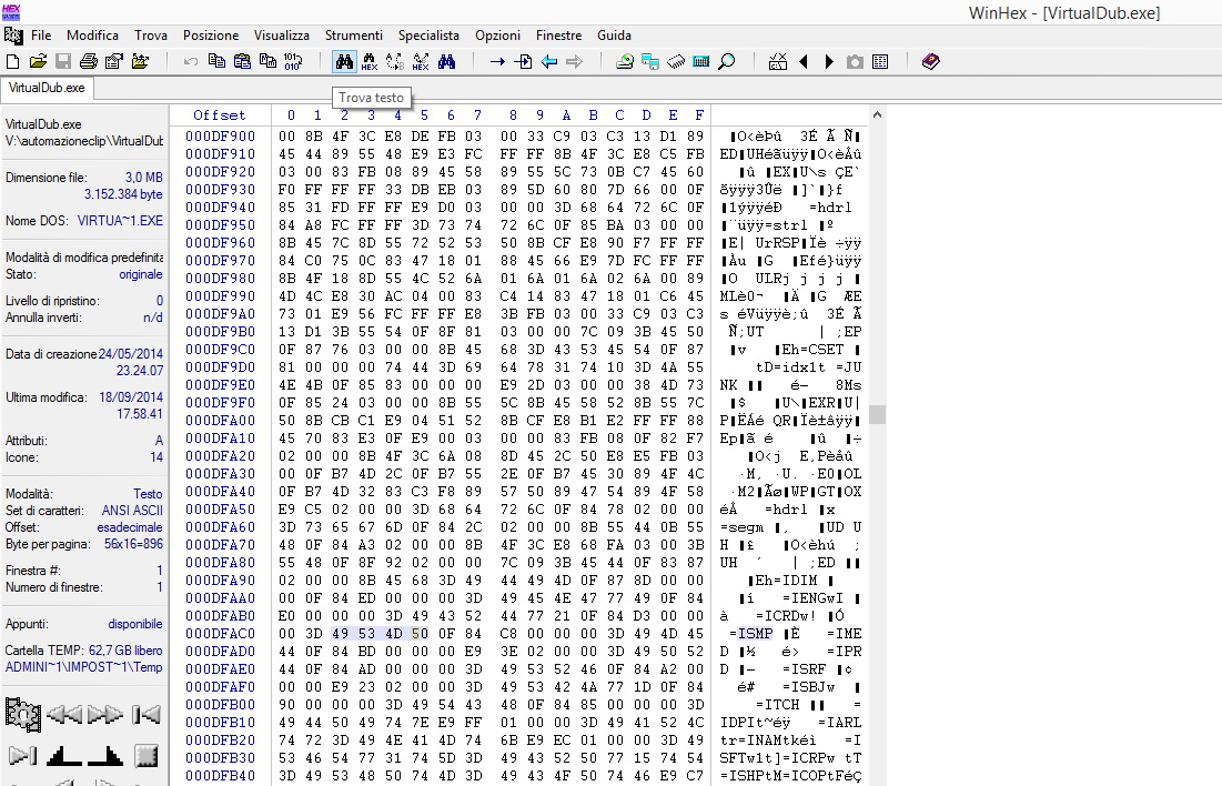

  8. please cats I have a problem with Virtualdub:
    In virtualdub 1.10.4 I have load the C0016.mxf
    --> insert the "interlace filter" (set to TFF) to convert into 25i
    set compressor and Save AVI ---> all is ok
    file .avi is generated and ok
    BUT if I do File ---> "save processing setting" --> cat.vcf
    --> close virtualdub
    open virtualdub, load C0016.mxf
    --> "load processing settings" cat.vcf
    --> save AVI ......... resultant avi have the double of time-lenght, video is ok but lenght of video is doubled and at the half image freeze
    maybe I think this is for the use of the "interlace" filter in batch mode, and maybe is a bug of virtuldub
    I wonder: is there anhother way to pass from 50P into 25i that is not the "interlace" filter? (in the VIDEO--->FrameRate section of virtualdub I can do something?)
  9. Originally Posted by marcorocchini View Post
    Of course not. The video is progressive at that point.
    yes, video is progressive so that "interlaced" flag don't have to be cheched... but I see a lot of aliasing.
    If I check the flag, resultant video is almost acceptable, considering that when the camera work on this "loser" resolution produce inexplicably a certain degree of aliasing
  12. Originally Posted by marcorocchini View Post

  13. Originally Posted by marcorocchini View Post
    Because you're over sharpening. Sharp video = aliasing

  19. Originally Posted by marcorocchini View Post
    In virtualdub, if I keep cheched the "interlaced" flags in the resize box image become almost accettable, otherwise I get eaten from aliasing
    Because interlaced resizing is blurring the video vertically. But that also creates buzzing edges and double edges. Just use a less sharp resizing filter when you downscale from 1280x720 instead -- precise bilinear. That will also reduce interlace flicker.

  23. The 1280x720 source is already oversharpened. Downscaling with a sharpening filter is going to accentuate the oversharpening halos and aliasing. Consider a blur filter to reduce the halos and aliasing.

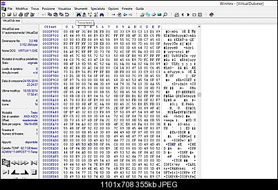

    I do all this to work on the Big Speed Razor for cats HD 3.1
    Recentrly I have add in the batch the directly use of virtualdub, avoiding virtualdubmod
    using the lines:
    if NOT "%TimeCode%"=="" echo VirtualDub.project.ClearTextInfo^(^);>>%1
    if NOT "%TimeCode%"=="" echo VirtualDub.project.AddTextInfo^("ISMP", "%TIMECODE%"^);>>%1
    and modifing the virtualdub.exe so that now virtualdub directly write .avi with timecode
    Wasn't all this discussed over and over again a few times ? You need to low pass when you make SD interlaced. Sharp = bad for interlace
    yes: in avisynth. But I decide, or at least I try, to do all .mxf conversion in virtualdub because avisynth employ too much time to indexing
    so I try to do all in virtualdub. In fact in this post I try to reduce a 50P to 50i SD, and fullHD... with virtualdub.
    So if I need to low pass, in virtualdub what is correct this to transcode my cat C0016.mxf into SD?
    [to tell the truth as I put the lanczos resize filter in but I'm afraid it is not very right ]
    If source is already aliased, consider using antialiasing (AA) filters first
    virtualdub have this filter? ^^

    Camcorder I think it can record in fullHD interlace, but in this moment I try do to a batch that convert all possible combinations of xdcam formats ---> in SD 720x576, and 1920x1080 .avi MJPEG files
    With my camera I can shoot only @ 1920x1080 interlace... and all is "ok".
    it could happen that a colleague-camera operator come to me and deliver material filmed in a different format, e.g. ... 1280x720/50P: being that these broadcast camcorders (sony pdw-f335, pdw-700, pdw-800) can record in a various formats and, at least in italy, is not well defined a format, everyone tends to use the format that arbitrarily prefer. Edius import all, but speed razor (at the moment :=)) no. But now I do a batch that ask you: want you all in SD or fullHD? and it do all .. problem solved.
    In avisynth I have do the script and seems work well but the ffms2 is too slow loading .mxf due to the indexing. In fact here I try to use only virtualdub, at least for .mxf files
  28. Originally Posted by poisondeathray View Post
    Originally Posted by _Al_ View Post
    you start to go in circles.
    [Attachment 27767 - Click to enlarge]
    yep. Wasn't all this discussed already ?
    avisynth yes, virtualdub no: YUY2 correct conversion, rec.601 <--> rec.709 only in this days I'm able to do that.
    Nobody seems able to do this operation in virtualdub. Me and my 5 cats have try but we don't expert as you ^^
    And now the problem of virtualdub: using 50P source, when you use the "Interlaced" filter via .vcf it get the problem of the duration
  29. Originally Posted by marcorocchini View Post
    We are talking about fundamental properties of digital video: too sharp = aliasing. There's no difference between VirtualDub and AviSynth in this respect. Don't you have the ability to take what you learned in one place and apply it in another?
