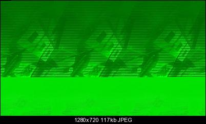

  1. I was playing these fine on clean MPC-HC with LAV codecs not long ago, but now it shows up like this:
    What happens when I try to play them is it's just blank and sits at 00:00 if I skip forward then it goes to the green and plays, I can hear audio fine, subtitles overlay fine.
    I installed some converters I was trying to play around with, really is the only thing I can think of that might have caused it, I have since uninstalled them but the problem persists.
    I installed CCCP and Kawaii codec packs to try to clear out anything but neither seemed to work.
    Any suggestions or help would be appreciated, thank you!

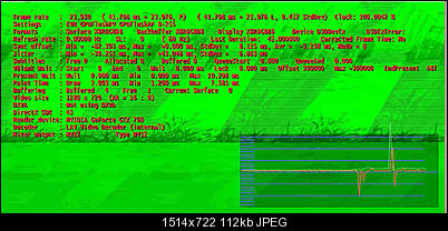

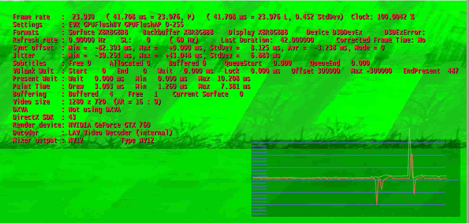

  3. Thanks for replying.
    There's nothing in External filters.
    Here's the stats screen:
    It seems LAV is running, I just don't get.
