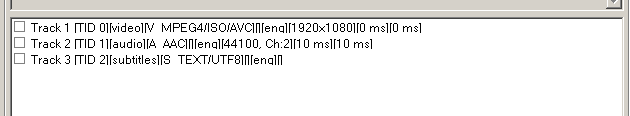

  9. Have you tried opening an MKV with gMKVExtractGUI and checking for actual delays for each stream rather than relying on MediaInfo?
    There's two delay values. The first is the actual delay. The second is the "effective" delay. The author explains the effective delays this way:
    The "Delay" field is the actual track delay as defined in the mkv header.
    The "EffectiveDelay" is the actual delay that players use while playing the file. It is actually different only for the audio tracks, in cases that there is a delay defined for the video track. This is the value that is used for generating the output file name when extracting the track.
    [Attachment 27750 - Click to enlarge]
    If you had an MKV with a 50ms video delay and a 10 ms audio delay, the effective video delay is shown as 50ms and the effective video delay is -40ms. If you extract the audio and video streams, the audio will have a -40ms delay written to the file name.
    MediaInfo should report the audio delay as -40ms.

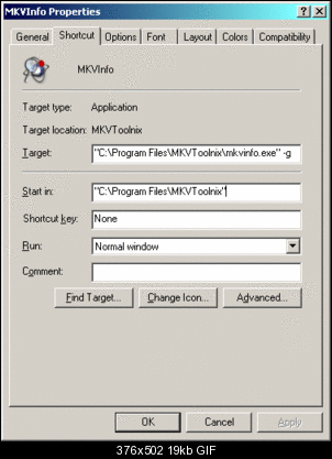

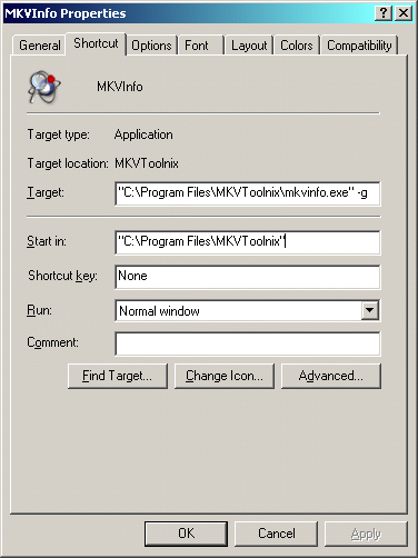

    mkvinfo.exe -g
    Does that make more sense? I generally skip the .exe part because it's unnecessary.
  22. Mkvinfo.exe just opens then closes a command prompt. If you're referring to the command line, I don't know how to use the command line. None of this matters as there's no way to prevent MKVMerge adding a delay. Thank you to everyone who posted though.
  23. Member
    Sep 2012
    Australia
    sigh
    mkvinfo -g
    but really, at this point I'd rather you didn't bother.
  24. Originally Posted by VideoFanatic View Post
    You just need to create a shortcut and edit it.
