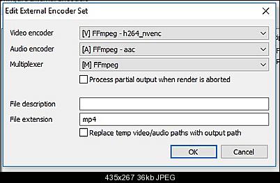

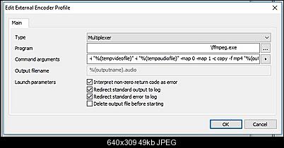

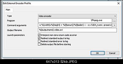

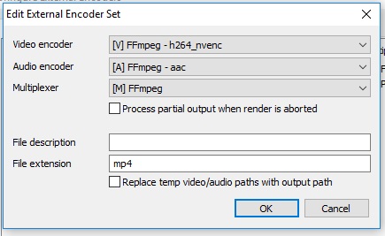

  5. Hello,
    How can I use this options with the external encoder feature?
    ffmpeg -i input.avi -c:v h264_nvenc -preset slow -qmin 0 -qmax 50 -profile:v baseline -level 3.0 -c:a aac -b:a 128k -vf yadif output.mp4
  6. You need to split video encoding, audio encoding and muxing.
    video:
    -f rawvideo -s %(width)x%(height) -r %(fpsnum)/%(fpsden) -i - -c:v h264_nvenc -preset slow -qmin 0 -qmax 50 -profile:v baseline -level 3.0 -vf yadif -f mp4 -y "%(tempvideofile)"
    audio (set input format to "WAV file")
    -f wav -i - -c:a aac -b:a 125k -f mp4 -y "%(tempaudiofile)"
    muxing:
    -i "%(tempvideofile)" -i "%(tempaudiofile)" -map 0 -map 1 -c copy -f mp4 -y "%(outputfile)"

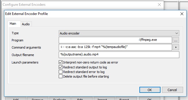

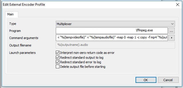

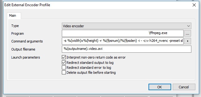

  7. Thanks for your help, after a few minutes it crashes vdub
    Maybe I'm not doing everything right.

  8. Maybe ffmpeg crashes?
    Tick all "Redirect standard xxxx to log" and try again. Post the log (F8).

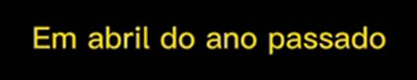

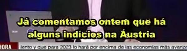

  19. I ask for help from you gurus, because I'm wasting time trying to find what is going on here...
    I have some profiles to use h265 codec.
    But with some videos, I get udesired artifacts among subtitles that I won't get if I proccess the very same video with command line.
    Like the attached files.
    I noticed that I was using an old version of encoder x265.exe:
    x265 [info]: HEVC encoder version 2.4+27-e9e574bbed93
    I changed that to ffmpeg:
    ffmpeg version 2022-01-24-git-0a83ecbf48-essentials_build-www.gyan.dev Copyright (c) 2000-2022 the FFmpeg developers
    But the same artifacts are still messing the subtitles, if I encode with Vdub.
    None of them appears if I use ffmpeg command line.
    The log shows a call to x265.exe, but I don't use it anymore.
    Confused...
    This is my line to external encoder:
    -f rawvideo -s %(width)x%(height) -r %(fpsnum)/%(fpsden) -i - -crf 24 -vcodec libx265  "%(tempvideofile)"
    And this is the command line to console:
    ffmpeg -i input.mkv -c:v libx265 -crf 24 output.mkv
    My external encoder output has dots.
    My command line to console output has no dots.

    I don't understand why x265 is being called, because it is out of the profile.
    Or is it a ffmpeg mode?
    And why I get artifacts with Vdub, but don't get it in command line?
    Finally, how to get rid of that little undesired dots?
    Thank you.
  20. Originally Posted by jairovital View Post
    I realized that x265 is from the ffmpeg itself.
    I got it.
    But the other questions remains:
    Why do I get artifacts with Vdub, but don't get it in command line?
    How to get rid of that little undesired dots?
    Thank you.
  21. Another example of the problem attached.
    The same video proccessed with ffmpeg command line has no problem.
    Does anybody know what is happening?
Name:	Clipboard Image.jpg
    Thank you.
  22. Originally Posted by jairovital View Post
    After too much time since this question, finally, I got an answer.
    To get rid of undesired artifacts, I have to adjust input color depth to be the same of the output one.
    Default option is "Autoselect".
    This causes to have too many undesired dots and dirt on the output video.
    To solve that, I have to select "24 bit RGB (888)" on the left panel below:
    Thank you.
