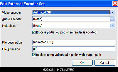

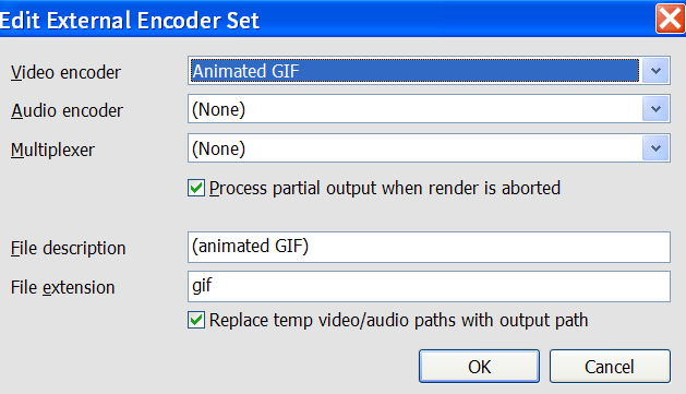

    Any ideas?
    You can just delete the zero byte no extension file. It is just a temporary file. I haven't figured out how to auto delete that one yet.
    try
    at Edit External Encoder Set Tab
    1.check Process partial when render is aborted
    2.File extension gif
    3.check Replace temp video/audio with path
    at Edit External Encoder Profile Tab
    2.check Delete output file before starting
    [Attachment 38129 - Click to enlarge]
