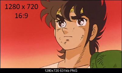

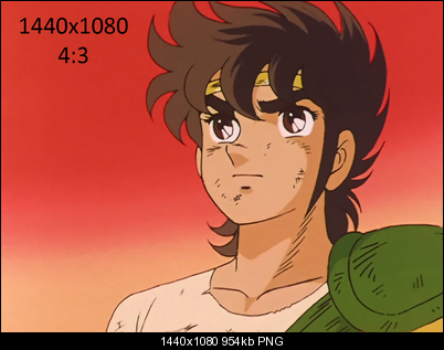

  1. I want to downgrade a few videos from 1080p to 720p, but the thing is the original files have a 4:3 aspect and I also want to change it to 16:9 without stretching out the video. Is there a program I can use to do both or do I have to do it in separated steps?
    Basically what I'm trying to do is this:

    What you've shown above is something that is 1:1 PAR in both before+after shots, and is cropped. Did you want to crop? You do understand that unless you have some facility for doing pan&scan (such as an advanced/intermediate NLE, or a Compositing/Animation app), you would likely encounter points in the program where your static crop could cut out something important.
    Unless you meant you wanted to pillarbox, or stretch.
    Possibility: 1440x1080, using a 4:3 PAR = 16:9 DAR, just like 1280x720 (at 1:1 PAR) is. So you may not need to change the DAR, just resize down, if your footage was originally meant to be of that type. But that could be a red herring.

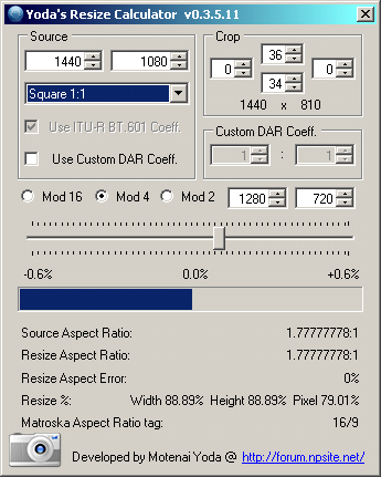

    Almost any encoding program will crop. If it doesn't have an aspect ratio calculator you can use a separate one to get it right. Just set the output dimensions to something 16:9 (ie 704x396) and adjust the cropping until the aspect ratio distortion is as close to zero as you can get it. That'd be the cropping you'd use with any 16:9 dimensions (704x396, 1280x720 etc). YodaResizeCalculator (it's an exe, but it's safe).

  4. The calculator only shows 2 digits, but for your example 136 pixels from the top and 134 from the bottom would do it. Or any top and bottom cropping combination which removes a total of 270 pixels. You could crop 100 from the top and 170 from the bottom etc.
