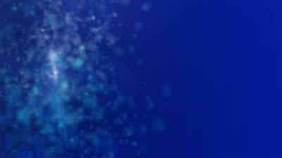

    I have a clip which has dust/dirt clouds in 15 out of 25 frames per second. The dust/dirt looks like blue-gray clouds and patches similar to this:
    Sample
    https://www.sendspace.com/file/cmgrsm
    I have managed to remove majority of the white specks, comets, tears, and scratches using Avisynth + After Effects. However, I am having a hard time getting rid of the dust clouds.

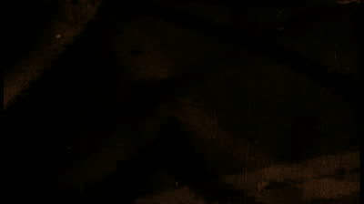

  2. Here is a sample from the video with the dust and dirt:
  3. As far as i can tell the problem is located on the U component for the most part. Can't you upload a "normal" video sample with details in it, it'd be better...
    Anyway, i think spotremover might help you: http://spotremoverfilter.com/

    Here you go:
